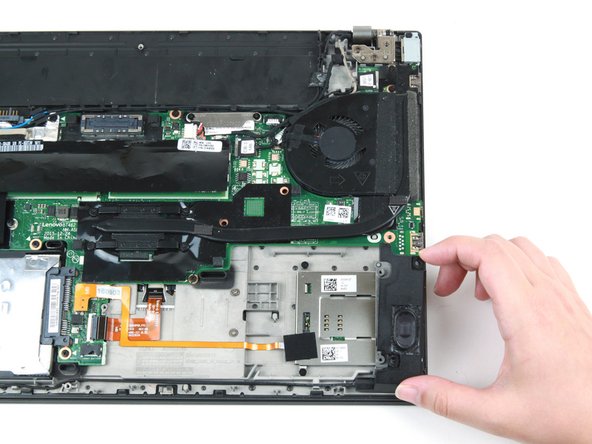

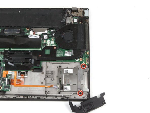

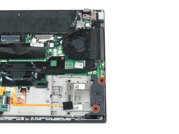

  12. Lenovo ThinkPad T460 Smart Card Reader Cable Replacement, Smart Card Reader: crwdns2935265:012crwdnd2935265:01crwdnd2935265:02crwdne2935265:0 Lenovo ThinkPad T460 Smart Card Reader Cable Replacement, Smart Card Reader: crwdns2935265:012crwdnd2935265:02crwdnd2935265:02crwdne2935265:0
    • Remove two 5 mm screws from the speaker in the lower right-hand corner using a Phillips #1 screwdriver.

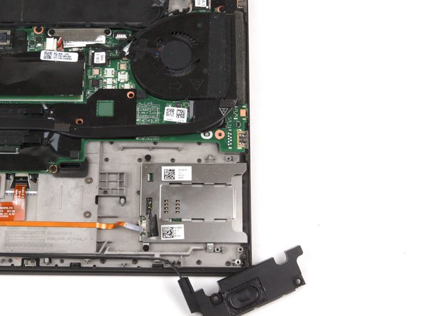

  13. Lenovo ThinkPad T460 Smart Card Reader Cable Replacement: crwdns2935265:013crwdnd2935265:01crwdnd2935265:03crwdne2935265:0 Lenovo ThinkPad T460 Smart Card Reader Cable Replacement: crwdns2935265:013crwdnd2935265:02crwdnd2935265:03crwdne2935265:0 Lenovo ThinkPad T460 Smart Card Reader Cable Replacement: crwdns2935265:013crwdnd2935265:03crwdnd2935265:03crwdne2935265:0
    • Use your hand to lift the speaker out of its compartment.
    • The speaker's wire will still be secured to the laptop; it is not necessary to remove the wire.

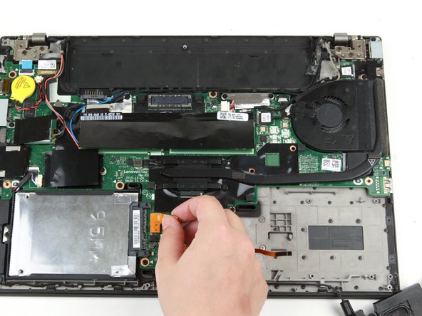

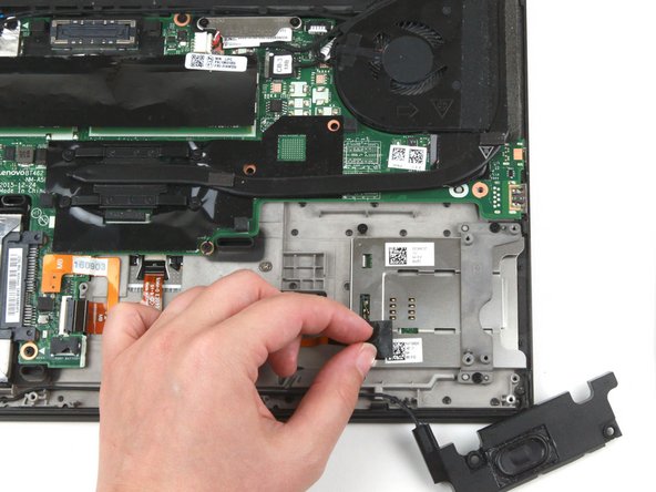

  14. Lenovo ThinkPad T460 Smart Card Reader Cable Replacement: crwdns2935265:014crwdnd2935265:01crwdnd2935265:02crwdne2935265:0 Lenovo ThinkPad T460 Smart Card Reader Cable Replacement: crwdns2935265:014crwdnd2935265:02crwdnd2935265:02crwdne2935265:0
    • Use your fingers to lift the black flap up from the smart card reader cable connector.

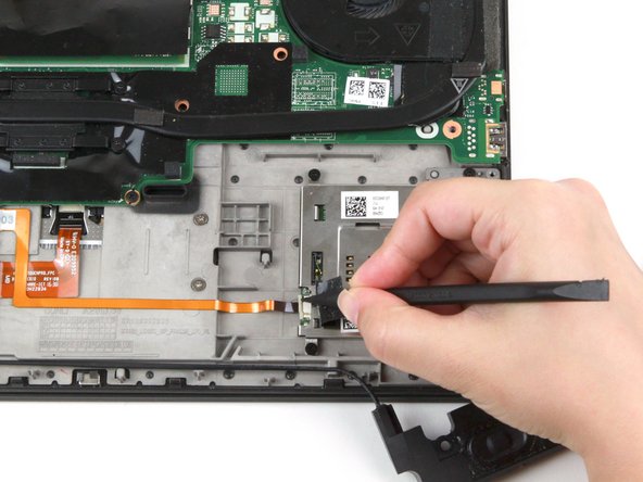

  15. Lenovo ThinkPad T460 Smart Card Reader Cable Replacement: crwdns2935265:015crwdnd2935265:01crwdnd2935265:02crwdne2935265:0 Lenovo ThinkPad T460 Smart Card Reader Cable Replacement: crwdns2935265:015crwdnd2935265:02crwdnd2935265:02crwdne2935265:0
    • Use the pointed end of a spudger to open the white clip on the smart card reader connector.
  16. Lenovo ThinkPad T460 Smart Card Reader Cable Replacement: crwdns2935265:016crwdnd2935265:01crwdnd2935265:02crwdne2935265:0 Lenovo ThinkPad T460 Smart Card Reader Cable Replacement: crwdns2935265:016crwdnd2935265:02crwdnd2935265:02crwdne2935265:0

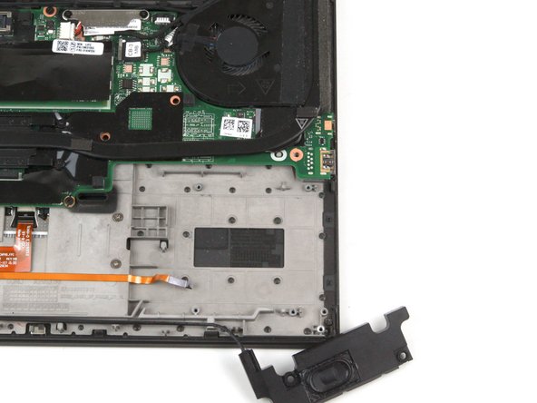

    • Use a pair of blunt nose tweezers to slide the cable out of the connector on the smart card reader.

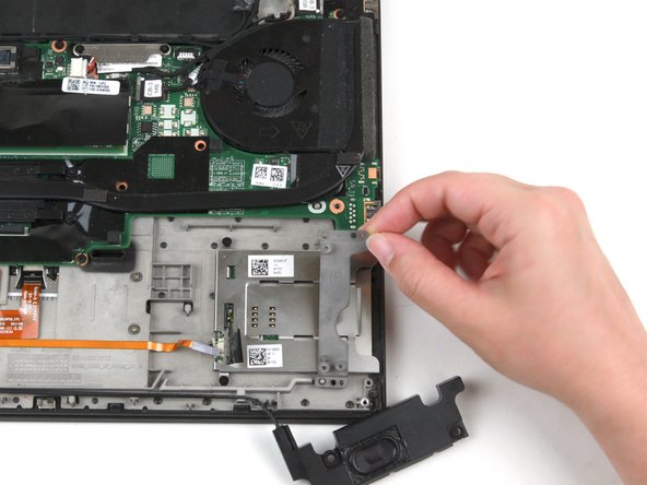

  18. Lenovo ThinkPad T460 Smart Card Reader Cable Replacement: crwdns2935265:018crwdnd2935265:01crwdnd2935265:03crwdne2935265:0 Lenovo ThinkPad T460 Smart Card Reader Cable Replacement: crwdns2935265:018crwdnd2935265:02crwdnd2935265:03crwdne2935265:0 Lenovo ThinkPad T460 Smart Card Reader Cable Replacement: crwdns2935265:018crwdnd2935265:03crwdnd2935265:03crwdne2935265:0
    • Use your fingers to lift the smart card reader bracket up and away from the laptop.

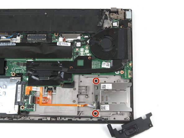

  19. Lenovo ThinkPad T460 Smart Card Reader Cable Replacement: crwdns2935265:019crwdnd2935265:01crwdnd2935265:02crwdne2935265:0 Lenovo ThinkPad T460 Smart Card Reader Cable Replacement: crwdns2935265:019crwdnd2935265:02crwdnd2935265:02crwdne2935265:0
    • Remove two 3.7 mm screws from the smart card reader using a Phillips #1 screwdriver.

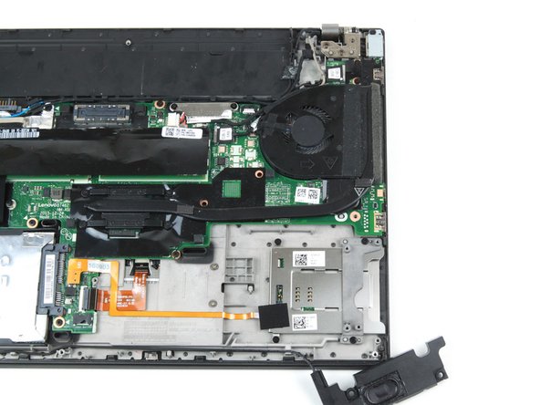

  20. Lenovo ThinkPad T460 Smart Card Reader Cable Replacement: crwdns2935265:020crwdnd2935265:01crwdnd2935265:03crwdne2935265:0 Lenovo ThinkPad T460 Smart Card Reader Cable Replacement: crwdns2935265:020crwdnd2935265:02crwdnd2935265:03crwdne2935265:0 Lenovo ThinkPad T460 Smart Card Reader Cable Replacement: crwdns2935265:020crwdnd2935265:03crwdnd2935265:03crwdne2935265:0
    • Use the flat end of a spudger to pry the smart card reader up by a few millimeters.
    • Use your other hand to lift the smart card reader up and away from the laptop.

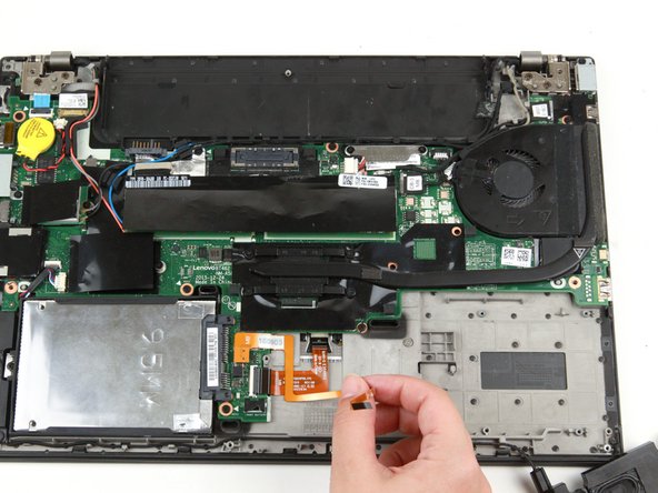

  21. Lenovo ThinkPad T460 Smart Card Reader Cable Replacement, Smart Card Reader Cable: crwdns2935265:021crwdnd2935265:01crwdnd2935265:03crwdne2935265:0 Lenovo ThinkPad T460 Smart Card Reader Cable Replacement, Smart Card Reader Cable: crwdns2935265:021crwdnd2935265:02crwdnd2935265:03crwdne2935265:0 Lenovo ThinkPad T460 Smart Card Reader Cable Replacement, Smart Card Reader Cable: crwdns2935265:021crwdnd2935265:03crwdnd2935265:03crwdne2935265:0
    • Use your fingers to peel up the smart card reader cable and disconnect it from its socket on the motherboard.
