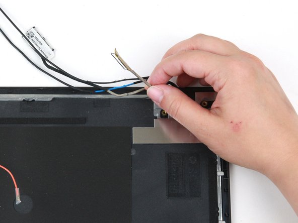

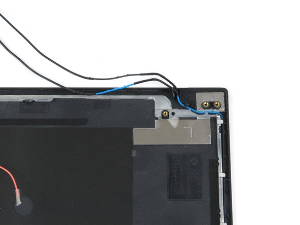

  34. Lenovo ThinkPad T460 LCD Cable Replacement, LCD Cable: crwdns2935265:034crwdnd2935265:01crwdnd2935265:03crwdne2935265:0 Lenovo ThinkPad T460 LCD Cable Replacement, LCD Cable: crwdns2935265:034crwdnd2935265:02crwdnd2935265:03crwdne2935265:0 Lenovo ThinkPad T460 LCD Cable Replacement, LCD Cable: crwdns2935265:034crwdnd2935265:03crwdnd2935265:03crwdne2935265:0
    • Use your fingers to lift the gray LCD cable up and away from the laptop.
