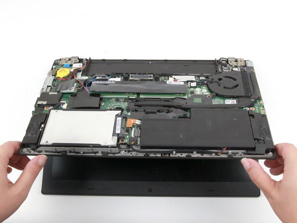

    • Remove two 4.7 mm screws from the hinge in the upper right-hand corner using a Phillips #1 screwdriver.
  10. Lenovo ThinkPad T460 Charging Port Replacement: crwdns2935265:010crwdnd2935265:01crwdnd2935265:03crwdne2935265:0 Lenovo ThinkPad T460 Charging Port Replacement: crwdns2935265:010crwdnd2935265:02crwdnd2935265:03crwdne2935265:0 Lenovo ThinkPad T460 Charging Port Replacement: crwdns2935265:010crwdnd2935265:03crwdnd2935265:03crwdne2935265:0
    • Lift the bottom of the laptop up by a few inches to rotate the upper right hinge.
    • Place the bottom of the laptop back down.
  11. Lenovo ThinkPad T460 Charging Port Replacement: crwdns2935265:011crwdnd2935265:01crwdnd2935265:02crwdne2935265:0 Lenovo ThinkPad T460 Charging Port Replacement: crwdns2935265:011crwdnd2935265:02crwdnd2935265:02crwdne2935265:0

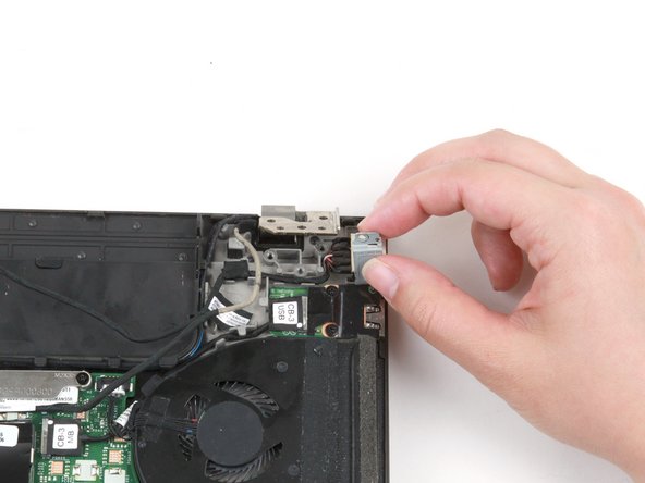

    • Remove the single 4.7 mm screw from the charging port bracket using a Phillips #1 screwdriver.
  15. Lenovo ThinkPad T460 Charging Port Replacement: crwdns2935265:015crwdnd2935265:01crwdnd2935265:02crwdne2935265:0 Lenovo ThinkPad T460 Charging Port Replacement: crwdns2935265:015crwdnd2935265:02crwdnd2935265:02crwdne2935265:0
    • Use your fingers to remove the charging port bracket from the laptop.
  16. Lenovo ThinkPad T460 Charging Port Replacement: crwdns2935265:016crwdnd2935265:01crwdnd2935265:03crwdne2935265:0 Lenovo ThinkPad T460 Charging Port Replacement: crwdns2935265:016crwdnd2935265:02crwdnd2935265:03crwdne2935265:0 Lenovo ThinkPad T460 Charging Port Replacement: crwdns2935265:016crwdnd2935265:03crwdnd2935265:03crwdne2935265:0
    • Use your fingers to slide the charging port out from beneath the gray cable to remove it from the laptop.
