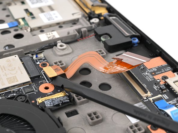

  8. Lenovo ThinkPad T16 Gen 3 I/O Board Replacement, Disconnect the interconnect cable: crwdns2935265:08crwdnd2935265:01crwdnd2935265:03crwdne2935265:0 Lenovo ThinkPad T16 Gen 3 I/O Board Replacement, Disconnect the interconnect cable: crwdns2935265:08crwdnd2935265:02crwdnd2935265:03crwdne2935265:0 Lenovo ThinkPad T16 Gen 3 I/O Board Replacement, Disconnect the interconnect cable: crwdns2935265:08crwdnd2935265:03crwdnd2935265:03crwdne2935265:0
    • Use a clean fingernail or the flat end of a spudger to flip up the locking flap on the interconnect cable ZIF connector, located on the I/O board.
    • Use tweezers or your fingers to grip the cable's plastic pull tab and gently pull the cable out of its socket.
  9. Lenovo ThinkPad T16 Gen 3 I/O Board Replacement, Remove the interconnect cable: crwdns2935265:09crwdnd2935265:01crwdnd2935265:03crwdne2935265:0 Lenovo ThinkPad T16 Gen 3 I/O Board Replacement, Remove the interconnect cable: crwdns2935265:09crwdnd2935265:02crwdnd2935265:03crwdne2935265:0 Lenovo ThinkPad T16 Gen 3 I/O Board Replacement, Remove the interconnect cable: crwdns2935265:09crwdnd2935265:03crwdnd2935265:03crwdne2935265:0
    • Insert the flat end of a spudger under a short edge of the interconnect cable press connector located on the motherboard and pry up to disconnect it.
    • Remove the interconnect ribbon cable from your laptop.
