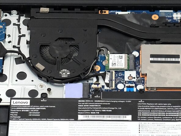

  6. Lenovo ThinkPad E15 Gen 3 Wi-Fi Card Replacement, Wi-Fi Card: crwdns2935265:06crwdnd2935265:01crwdnd2935265:02crwdne2935265:0 Lenovo ThinkPad E15 Gen 3 Wi-Fi Card Replacement, Wi-Fi Card: crwdns2935265:06crwdnd2935265:02crwdnd2935265:02crwdne2935265:0
    • Slide a thin, ESD-safe pry tool or angled tweezers under the metal neck of the connector (as close to the head as possible) and lift straight up from the board.
    • When working with these connectors, it's key to always lift the head straight up. If pried on at an odd angle, you risk breaking the socket off of the board underneath.
    • Reconnecting these can be tricky. Use tweezers to hold the connector in place over its socket and gently press down with your finger or a spudger—the connector should "snap" into place. If you're having trouble, reposition the head and try again.
    • When putting the cables back onto the Wi-Fi Card, make sure that the cables are attached to the correct places on the Card.

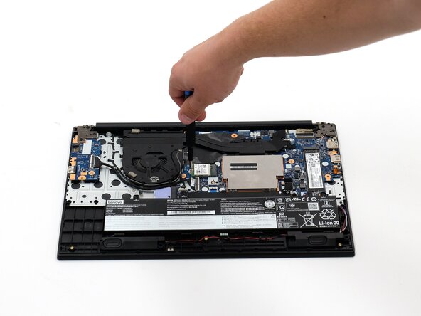

  7. Lenovo ThinkPad E15 Gen 3 Wi-Fi Card Replacement: crwdns2935265:07crwdnd2935265:01crwdnd2935265:02crwdne2935265:0 Lenovo ThinkPad E15 Gen 3 Wi-Fi Card Replacement: crwdns2935265:07crwdnd2935265:02crwdnd2935265:02crwdne2935265:0
    • Use a Phillips #1 screwdriver to remove the 2.8 mm screw from the Wi-Fi card.
    • The Wi-Fi Card will pop up from the motherboard once the screw is removed.

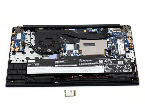

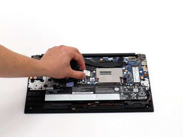

  8. Lenovo ThinkPad E15 Gen 3 Wi-Fi Card Replacement: crwdns2935265:08crwdnd2935265:01crwdnd2935265:03crwdne2935265:0 Lenovo ThinkPad E15 Gen 3 Wi-Fi Card Replacement: crwdns2935265:08crwdnd2935265:02crwdnd2935265:03crwdne2935265:0 Lenovo ThinkPad E15 Gen 3 Wi-Fi Card Replacement: crwdns2935265:08crwdnd2935265:03crwdnd2935265:03crwdne2935265:0
    • Gently slide the Wi-Fi card from the connector to remove it from the motherboard.
    • When reinstalling the Wi-Fi Card, make sure that the flat side of the card is facing towards the motherboard.
