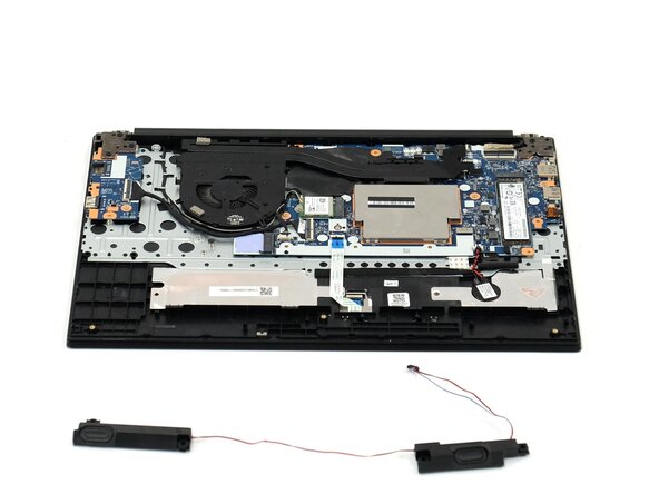

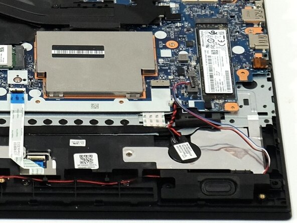

  6. Lenovo ThinkPad E15 Gen 3 Speakers Replacement, Speakers: crwdns2935265:06crwdnd2935265:01crwdnd2935265:02crwdne2935265:0 Lenovo ThinkPad E15 Gen 3 Speakers Replacement, Speakers: crwdns2935265:06crwdnd2935265:02crwdnd2935265:02crwdne2935265:0
    • Use the point of a spudger to push on alternating sides of the connector to "walk" it out of its socket.
    • It may take a lot of alternating before the connector comes out. Be patient, and don't pull on the cables.
    • To reconnect the cable, align the connector and use a spudger or clean fingernail to push it fully into the socket.
    • Don't push on the cables themselves, or you may damage the connector.
  7. Lenovo ThinkPad E15 Gen 3 Speakers Replacement: crwdns2935265:07crwdnd2935265:01crwdnd2935265:02crwdne2935265:0 Lenovo ThinkPad E15 Gen 3 Speakers Replacement: crwdns2935265:07crwdnd2935265:02crwdnd2935265:02crwdne2935265:0
    • Remove the speakers from the device.
    • The cables connecting the speakers may need to be gently untucked from the small plastic hooks bordering the battery.
    • Take note of how the speakers and their wires are arrayed, as you will need to arrange them in the same positions.
