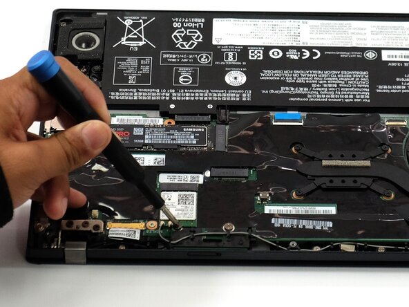

  2. Lenovo ThinkPad A285 Wi-Fi Card Replacement, Wi-Fi Card: crwdns2935265:02crwdnd2935265:01crwdnd2935265:02crwdne2935265:0 Lenovo ThinkPad A285 Wi-Fi Card Replacement, Wi-Fi Card: crwdns2935265:02crwdnd2935265:02crwdnd2935265:02crwdne2935265:0
    • Use a Phillips #0 screwdriver to remove the single 2 mm screw.

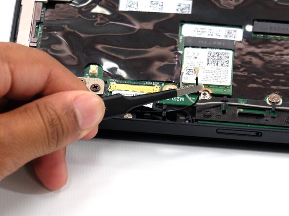

  3. Lenovo ThinkPad A285 Wi-Fi Card Replacement: crwdns2935265:03crwdnd2935265:01crwdnd2935265:02crwdne2935265:0 Lenovo ThinkPad A285 Wi-Fi Card Replacement: crwdns2935265:03crwdnd2935265:02crwdnd2935265:02crwdne2935265:0
    • Slide a thin, ESD-safe pry tool or angled tweezers under the metal neck of the coaxial Wi-Fi connector (as close to the head as possible) and lift straight up from the board.
    • When working with these connectors, it's key to always lift the head straight up. If pried on at an odd angle, you risk breaking the socket off of the board underneath.
    • Reconnecting these can be tricky. Use tweezers to hold the connector in place over its socket and gently press down with your finger or a spudger—the connector should "snap" into place. If you're having trouble, reposition the head and try again.
    • Don't try to force the connector into place or you may permanently damage it.
    • Match the wires with the corresponding colored arrows on the WAN card when reinstalling the connectors.

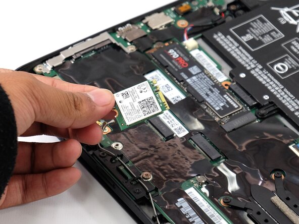

  4. Lenovo ThinkPad A285 Wi-Fi Card Replacement: crwdns2935265:04crwdnd2935265:01crwdnd2935265:02crwdne2935265:0 Lenovo ThinkPad A285 Wi-Fi Card Replacement: crwdns2935265:04crwdnd2935265:02crwdnd2935265:02crwdne2935265:0
    • Slide the Wi-Fi card from the connector to remove it.
