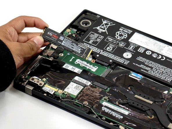

    • Flip your laptop over so the bottom panel is facing up.
    • Use a Phillips #0 to loosen the 5 screws holding the back panel to the laptop.
    • These screws do not come all the way out, so loosen until free spinning.
    • Lift the bottom of the panel to separate the back panel away from the device.
    • Remove the back panel.

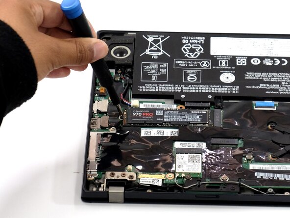

  2. Lenovo ThinkPad A285 SSD Card Replacement, SSD Card: crwdns2935265:02crwdnd2935265:01crwdnd2935265:03crwdne2935265:0 Lenovo ThinkPad A285 SSD Card Replacement, SSD Card: crwdns2935265:02crwdnd2935265:02crwdnd2935265:03crwdne2935265:0 Lenovo ThinkPad A285 SSD Card Replacement, SSD Card: crwdns2935265:02crwdnd2935265:03crwdnd2935265:03crwdne2935265:0
    • Use a Phillips #0 screwdriver to remove the 3 mm screw that secures the SSD to the motherboard.
    • Carefully slide the SSD card from its socket to remove it.
To reassemble your device, follow these instructions in reverse order. Take your e-waste to an R2 or e-Stewards certified recycler.
