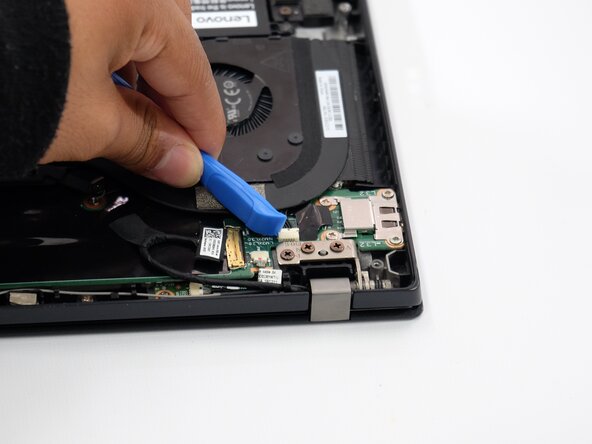

    • Use the point of a spudger or opening tool to push on alternating sides of the connector to "walk" it out of its socket.
    • It may take a lot of alternating before the connector comes out. Be patient, and don't pull on the cables.
    • To reconnect the cable, align the connector and use a spudger or clean fingernail to push it fully into the socket.
    • Don't push on the cables themselves, or you may damage the connector.

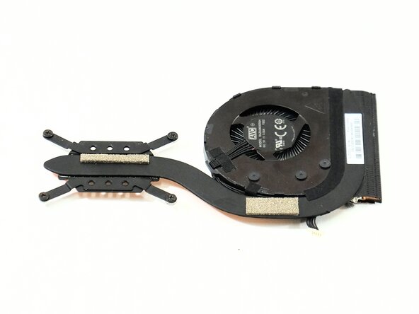

    • Use a Phillips #0 screwdriver to loosen the four screws holding the heat sink to the device.
    • These screws do not come out all the way. Loosen the screws until they are free spinning.

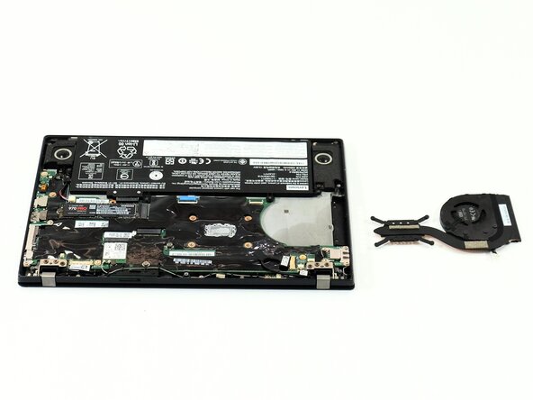

    • Remove the fan assembly from the inside edge of the laptop.
To reassemble your device, follow these instructions in reverse order. Take your e-waste to an R2 or e-Stewards certified recycler.
