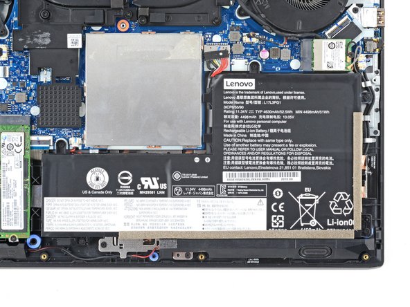

  11. Lenovo Legion Y7000P Speakers Replacement, Disconnect the battery: crwdns2935265:011crwdnd2935265:01crwdnd2935265:03crwdne2935265:0 Lenovo Legion Y7000P Speakers Replacement, Disconnect the battery: crwdns2935265:011crwdnd2935265:02crwdnd2935265:03crwdne2935265:0 Lenovo Legion Y7000P Speakers Replacement, Disconnect the battery: crwdns2935265:011crwdnd2935265:03crwdnd2935265:03crwdne2935265:0
    • Use the flat end of a spudger to push the battery connector straight out of its socket.
    • Push the tab on top of the battery connector, not the wires themselves.

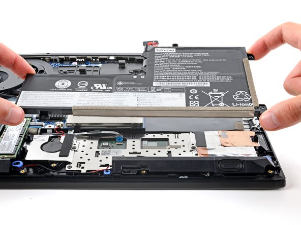

  12. Lenovo Legion Y7000P Speakers Replacement, Unfasten the battery: crwdns2935265:012crwdnd2935265:01crwdnd2935265:02crwdne2935265:0 Lenovo Legion Y7000P Speakers Replacement, Unfasten the battery: crwdns2935265:012crwdnd2935265:02crwdnd2935265:02crwdne2935265:0
    • Use a Phillips screwdriver to remove the five 5.7 mm‑long screws securing the battery.
  13. Lenovo Legion Y7000P Speakers Replacement, Remove the battery: crwdns2935265:013crwdnd2935265:01crwdnd2935265:02crwdne2935265:0 Lenovo Legion Y7000P Speakers Replacement, Remove the battery: crwdns2935265:013crwdnd2935265:02crwdnd2935265:02crwdne2935265:0
    • Remove the battery.

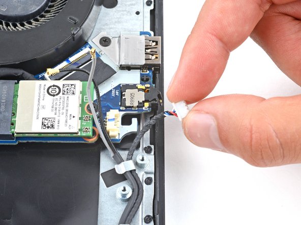

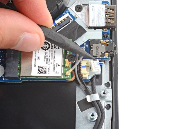

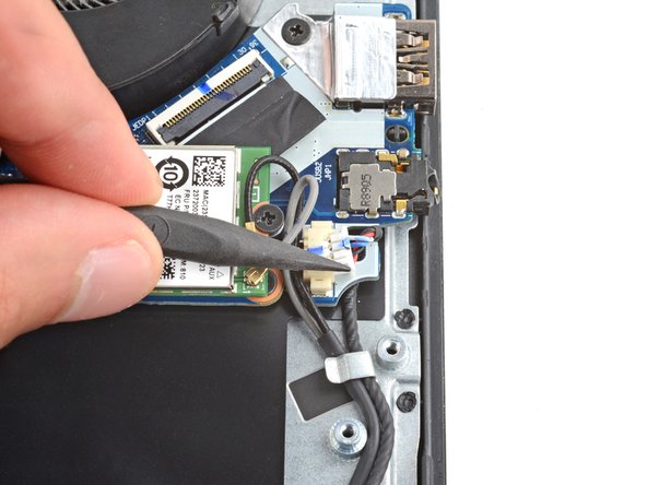

  14. Lenovo Legion Y7000P Speakers Replacement, Disconnect the speakers: crwdns2935265:014crwdnd2935265:01crwdnd2935265:03crwdne2935265:0 Lenovo Legion Y7000P Speakers Replacement, Disconnect the speakers: crwdns2935265:014crwdnd2935265:02crwdnd2935265:03crwdne2935265:0 Lenovo Legion Y7000P Speakers Replacement, Disconnect the speakers: crwdns2935265:014crwdnd2935265:03crwdnd2935265:03crwdne2935265:0
    • Use the point of a spudger to push on alternating sides of the speaker cable connector and "walk" it out of its socket.

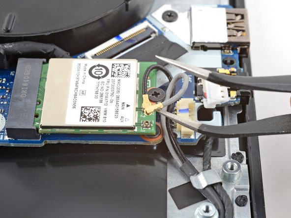

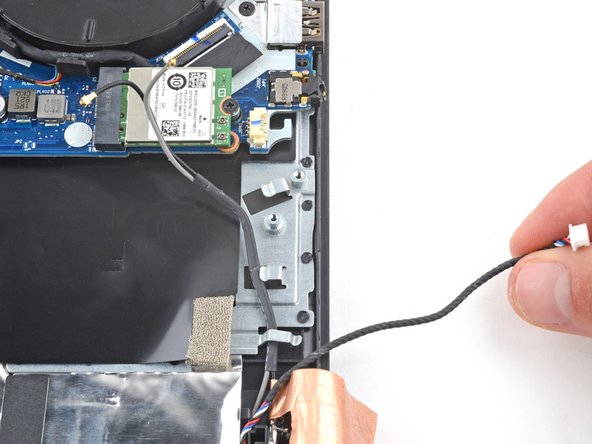

  15. Lenovo Legion Y7000P Speakers Replacement, Disconnect the Wi-Fi card cables: crwdns2935265:015crwdnd2935265:01crwdnd2935265:03crwdne2935265:0 Lenovo Legion Y7000P Speakers Replacement, Disconnect the Wi-Fi card cables: crwdns2935265:015crwdnd2935265:02crwdnd2935265:03crwdne2935265:0 Lenovo Legion Y7000P Speakers Replacement, Disconnect the Wi-Fi card cables: crwdns2935265:015crwdnd2935265:03crwdnd2935265:03crwdne2935265:0
    $3.99

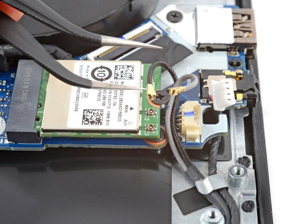

    • The speaker cable is intertwined with the Wi-Fi card cables. Both cables must be repositioned to remove the speaker.
    • Insert one arm of your angled tweezers under the connector head of the grey antenna cable and gently pry up to disconnect it.
    • Repeat the process to disconnect the black antenna cable.

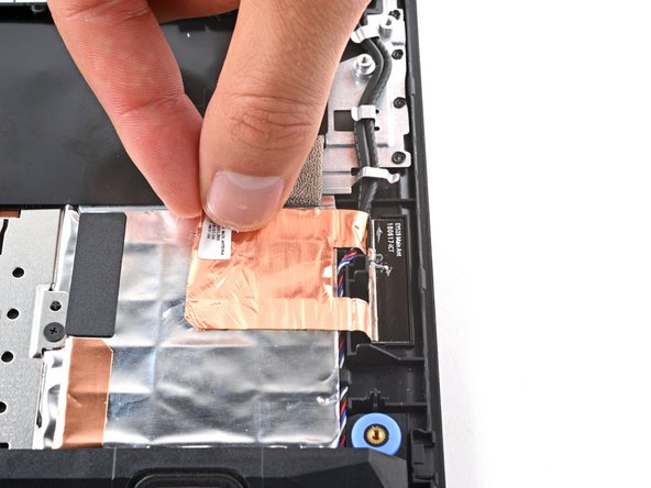

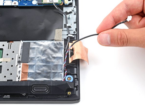

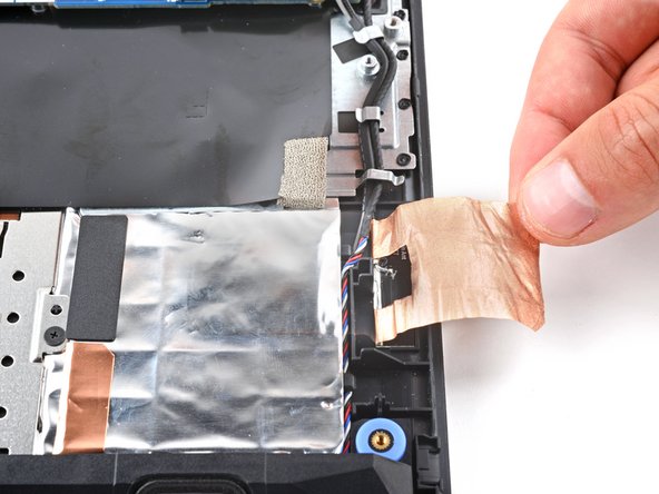

  16. Lenovo Legion Y7000P Speakers Replacement, Reposition the copper tape: crwdns2935265:016crwdnd2935265:01crwdnd2935265:03crwdne2935265:0 Lenovo Legion Y7000P Speakers Replacement, Reposition the copper tape: crwdns2935265:016crwdnd2935265:02crwdnd2935265:03crwdne2935265:0 Lenovo Legion Y7000P Speakers Replacement, Reposition the copper tape: crwdns2935265:016crwdnd2935265:03crwdnd2935265:03crwdne2935265:0
    • The speaker cable is trapped under a piece of copper tape on the bottom right corner of the laptop.
    • Use the flat end of a spudger to peel up a corner of the copper tape until you can grip it with your fingers.
    • Gently peel the copper tape from the frame and position it over the right edge of the laptop.

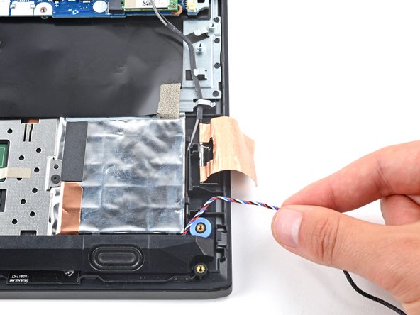

  17. Lenovo Legion Y7000P Speakers Replacement, Unhook the speaker cable: crwdns2935265:017crwdnd2935265:01crwdnd2935265:02crwdne2935265:0 Lenovo Legion Y7000P Speakers Replacement, Unhook the speaker cable: crwdns2935265:017crwdnd2935265:02crwdnd2935265:02crwdne2935265:0
    • Guide the speaker cable out of its cutout on the motherboard.

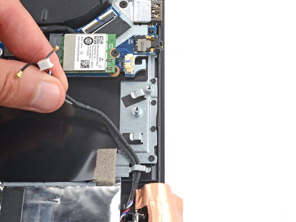

  18. Lenovo Legion Y7000P Speakers Replacement, Reposition the cables: crwdns2935265:018crwdnd2935265:01crwdnd2935265:03crwdne2935265:0 Lenovo Legion Y7000P Speakers Replacement, Reposition the cables: crwdns2935265:018crwdnd2935265:02crwdnd2935265:03crwdne2935265:0 Lenovo Legion Y7000P Speakers Replacement, Reposition the cables: crwdns2935265:018crwdnd2935265:03crwdnd2935265:03crwdne2935265:0
    • Three metal clips secure the speaker and Wi-Fi cables to the right edge of the laptop.
    • Guide the speaker cable and the Wi-Fi cables out of the upper two metal clips.
    • Guide only the speaker cable out of the bottom clip.
  19. Lenovo Legion Y7000P Speakers Replacement: crwdns2935265:019crwdnd2935265:01crwdnd2935265:03crwdne2935265:0 Lenovo Legion Y7000P Speakers Replacement: crwdns2935265:019crwdnd2935265:02crwdnd2935265:03crwdne2935265:0 Lenovo Legion Y7000P Speakers Replacement: crwdns2935265:019crwdnd2935265:03crwdnd2935265:03crwdne2935265:0
    • Two plastic clips secure the speaker cable to the bottom right corner of the laptop.
    • Gently guide the speaker cable out of the two plastic clips securing it.

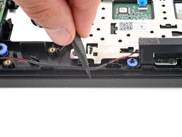

  20. Lenovo Legion Y7000P Speakers Replacement: crwdns2935265:020crwdnd2935265:01crwdnd2935265:02crwdne2935265:0 Lenovo Legion Y7000P Speakers Replacement: crwdns2935265:020crwdnd2935265:02crwdnd2935265:02crwdne2935265:0
    • A metal clip in the middle of the bottom edge secures the wire that connects the right and left speakers.
    • Use the point of a spudger to guide the wire out from under the metal clip.

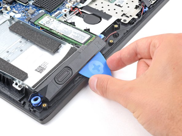

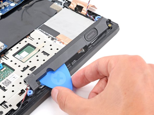

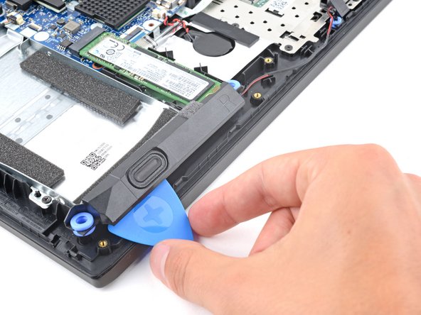

  21. Lenovo Legion Y7000P Speakers Replacement, Pry up the speakers: crwdns2935265:021crwdnd2935265:01crwdnd2935265:03crwdne2935265:0 Lenovo Legion Y7000P Speakers Replacement, Pry up the speakers: crwdns2935265:021crwdnd2935265:02crwdnd2935265:03crwdne2935265:0 Lenovo Legion Y7000P Speakers Replacement, Pry up the speakers: crwdns2935265:021crwdnd2935265:03crwdnd2935265:03crwdne2935265:0
    • The speakers are secured to the frame with rubber grommets.
    • Insert the flat end of an opening pick between the speaker labeled R and the frame.
    • Pry the speaker up and free it from the frame.

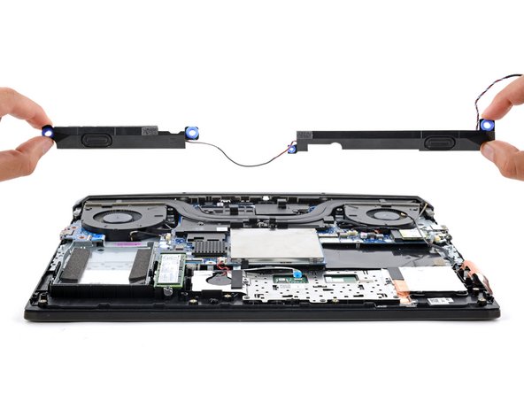

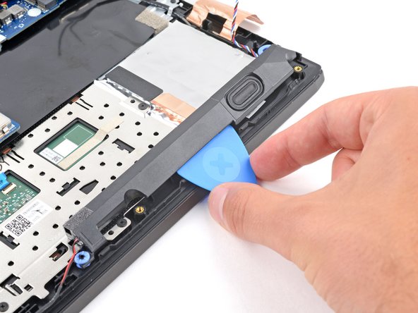

  22. Lenovo Legion Y7000P Speakers Replacement: crwdns2935265:022crwdnd2935265:01crwdnd2935265:03crwdne2935265:0 Lenovo Legion Y7000P Speakers Replacement: crwdns2935265:022crwdnd2935265:02crwdnd2935265:03crwdne2935265:0 Lenovo Legion Y7000P Speakers Replacement: crwdns2935265:022crwdnd2935265:03crwdnd2935265:03crwdne2935265:0
    • Use an opening pick to pry up the speaker labeled L.
  23. Lenovo Legion Y7000P Speakers Replacement, Remove the speakers: crwdns2935265:023crwdnd2935265:01crwdnd2935265:02crwdne2935265:0 Lenovo Legion Y7000P Speakers Replacement, Remove the speakers: crwdns2935265:023crwdnd2935265:02crwdnd2935265:02crwdne2935265:0
    • Remove the speakers.
    • To reinstall a speaker, line the grommets up with their posts in the frame and push the speaker down to secure it.
