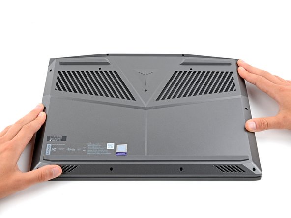

  2. Lenovo Legion Y7000P SSD Replacement, Flip your laptop over: crwdns2935265:02crwdnd2935265:01crwdnd2935265:01crwdne2935265:0
    • Flip your laptop over so the rubber feet are facing up.

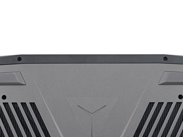

  3. Lenovo Legion Y7000P SSD Replacement, Unfasten the back cover: crwdns2935265:03crwdnd2935265:01crwdnd2935265:02crwdne2935265:0 Lenovo Legion Y7000P SSD Replacement, Unfasten the back cover: crwdns2935265:03crwdnd2935265:02crwdnd2935265:02crwdne2935265:0
    • Use a Phillips screwdriver to remove the 11 screws securing the back cover:
    • Five 11.5 mm‑long screws
    • Six 4.7 mm-long screws

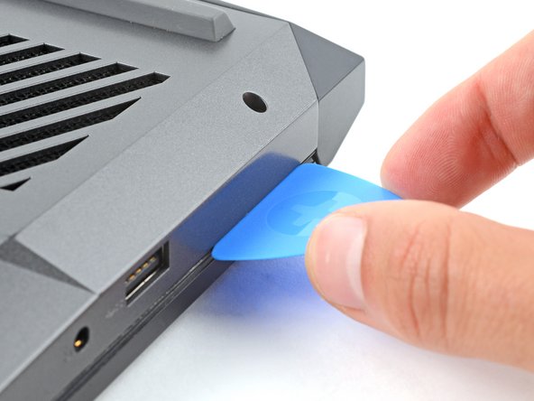

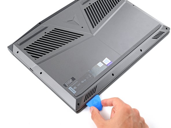

  4. Lenovo Legion Y7000P SSD Replacement, Insert an opening pick: crwdns2935265:04crwdnd2935265:01crwdnd2935265:02crwdne2935265:0 Lenovo Legion Y7000P SSD Replacement, Insert an opening pick: crwdns2935265:04crwdnd2935265:02crwdnd2935265:02crwdne2935265:0
    • Insert the flat side of an opening pick between the top right corner of the back cover and frame.
  5. Lenovo Legion Y7000P SSD Replacement, Release the back cover's clips: crwdns2935265:05crwdnd2935265:01crwdnd2935265:03crwdne2935265:0 Lenovo Legion Y7000P SSD Replacement, Release the back cover's clips: crwdns2935265:05crwdnd2935265:02crwdnd2935265:03crwdne2935265:0 Lenovo Legion Y7000P SSD Replacement, Release the back cover's clips: crwdns2935265:05crwdnd2935265:03crwdnd2935265:03crwdne2935265:0
    • Plastic clips secure the back cover to the frame. You'll hear and feel them release as you work.
    • Keep the pick angled upwards while sliding to help release the clips.
    • Slide the opening pick down the right edge and around the bottom right corner to release the clips.
  6. Lenovo Legion Y7000P SSD Replacement: crwdns2935265:06crwdnd2935265:01crwdnd2935265:03crwdne2935265:0 Lenovo Legion Y7000P SSD Replacement: crwdns2935265:06crwdnd2935265:02crwdnd2935265:03crwdne2935265:0 Lenovo Legion Y7000P SSD Replacement: crwdns2935265:06crwdnd2935265:03crwdnd2935265:03crwdne2935265:0
    • Slide the opening pick along the front edge and up to the top left corner to release the remaining clips securing the back cover.

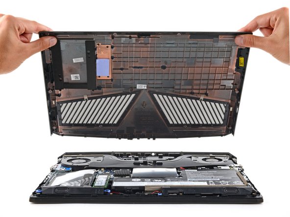

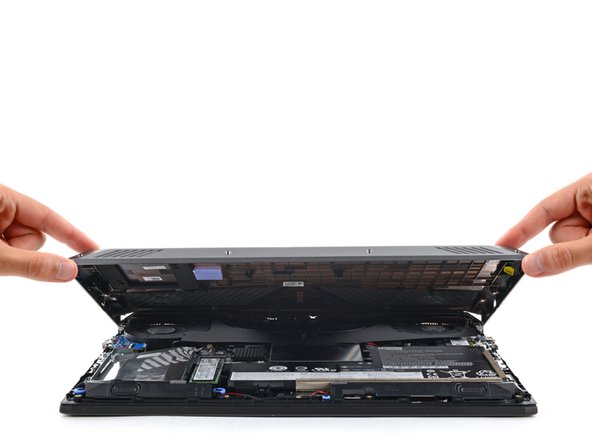

  7. Lenovo Legion Y7000P SSD Replacement, Remove the back cover: crwdns2935265:07crwdnd2935265:01crwdnd2935265:03crwdne2935265:0 Lenovo Legion Y7000P SSD Replacement, Remove the back cover: crwdns2935265:07crwdnd2935265:02crwdnd2935265:03crwdne2935265:0 Lenovo Legion Y7000P SSD Replacement, Remove the back cover: crwdns2935265:07crwdnd2935265:03crwdnd2935265:03crwdne2935265:0
    • Remove the back cover.
  8. Lenovo Legion Y7000P SSD Replacement, Reassembly information: crwdns2935265:08crwdnd2935265:01crwdnd2935265:03crwdne2935265:0 Lenovo Legion Y7000P SSD Replacement, Reassembly information: crwdns2935265:08crwdnd2935265:02crwdnd2935265:03crwdne2935265:0 Lenovo Legion Y7000P SSD Replacement, Reassembly information: crwdns2935265:08crwdnd2935265:03crwdnd2935265:03crwdne2935265:0
    • During reassembly:
    • Slide the two tabs near the center of the back cover's top edge under the hinge cover.
    • Press down firmly around the perimeter of the back cover to engage all the clips.

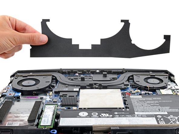

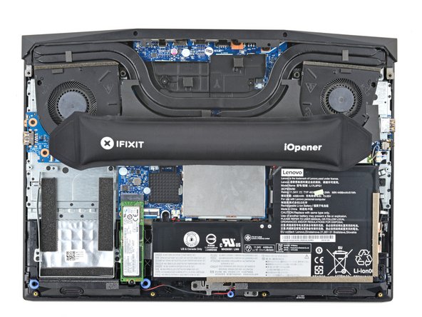

  9. Lenovo Legion Y7000P SSD Replacement, Heat the black cover: crwdns2935265:09crwdnd2935265:01crwdnd2935265:02crwdne2935265:0 Lenovo Legion Y7000P SSD Replacement, Heat the black cover: crwdns2935265:09crwdnd2935265:02crwdnd2935265:02crwdne2935265:0
    • A stiff, black cover runs across the heatsink and fans.
    • Removing the cover makes repairs much easier, but isn't required. If you don't want to remove the cover, you can roll it onto itself to keep it out of the way and skip the next two steps.
    • Heat an iOpener and apply it to the cover for two minutes.
    • You can also use a hair dryer. Follow this guide for more instructions.

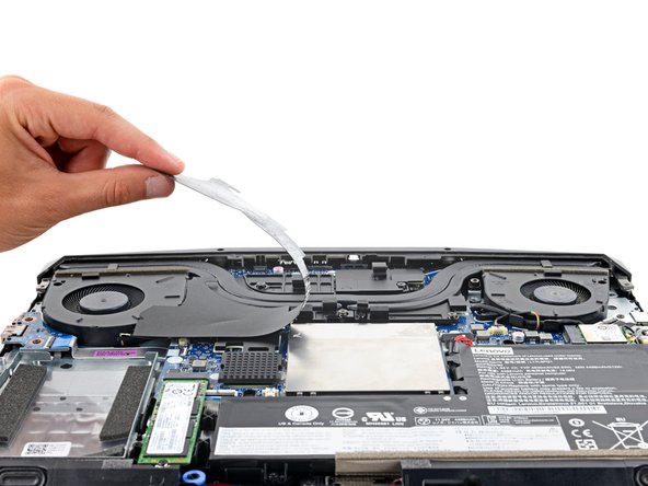

  10. Lenovo Legion Y7000P SSD Replacement, Remove the cover: crwdns2935265:010crwdnd2935265:01crwdnd2935265:03crwdne2935265:0 Lenovo Legion Y7000P SSD Replacement, Remove the cover: crwdns2935265:010crwdnd2935265:02crwdnd2935265:03crwdne2935265:0 Lenovo Legion Y7000P SSD Replacement, Remove the cover: crwdns2935265:010crwdnd2935265:03crwdnd2935265:03crwdne2935265:0
    • Gently peel up and remove the black cover.
    • During reassembly, press the cover back into place using the residual adhesive.

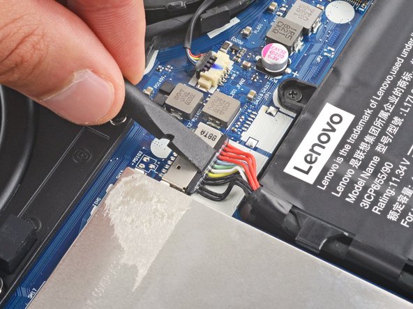

  11. Lenovo Legion Y7000P SSD Replacement, Disconnect the battery: crwdns2935265:011crwdnd2935265:01crwdnd2935265:03crwdne2935265:0 Lenovo Legion Y7000P SSD Replacement, Disconnect the battery: crwdns2935265:011crwdnd2935265:02crwdnd2935265:03crwdne2935265:0 Lenovo Legion Y7000P SSD Replacement, Disconnect the battery: crwdns2935265:011crwdnd2935265:03crwdnd2935265:03crwdne2935265:0
    • Use the flat end of a spudger to push the battery connector straight out of its socket.
    • Push the tab on top of the battery connector, not the wires themselves.

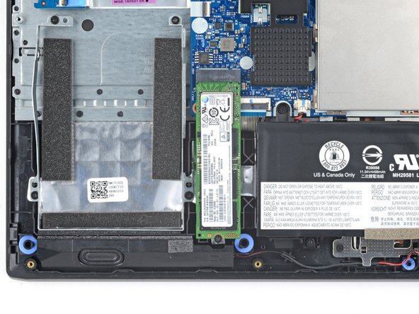

  12. Lenovo Legion Y7000P SSD Replacement, Unfasten the SSD: crwdns2935265:012crwdnd2935265:01crwdnd2935265:02crwdne2935265:0 Lenovo Legion Y7000P SSD Replacement, Unfasten the SSD: crwdns2935265:012crwdnd2935265:02crwdnd2935265:02crwdne2935265:0
    • Use a Phillips screwdriver to remove the 3.9 mm‑long screw securing the SSD.
    • The SSD will pop up at a slight angle with the screw removed.

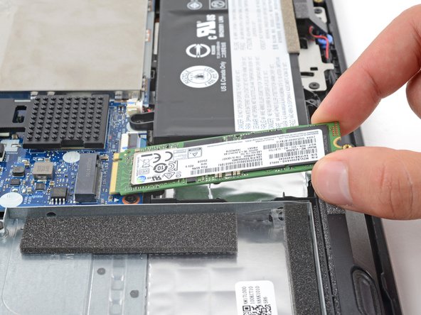

  13. Lenovo Legion Y7000P SSD Replacement, Remove the SSD: crwdns2935265:013crwdnd2935265:01crwdnd2935265:02crwdne2935265:0 Lenovo Legion Y7000P SSD Replacement, Remove the SSD: crwdns2935265:013crwdnd2935265:02crwdnd2935265:02crwdne2935265:0
    • Pull the SSD straight out of its socket and remove it.
    • During reassembly, insert the SSD at a slight downward angle into its socket.
