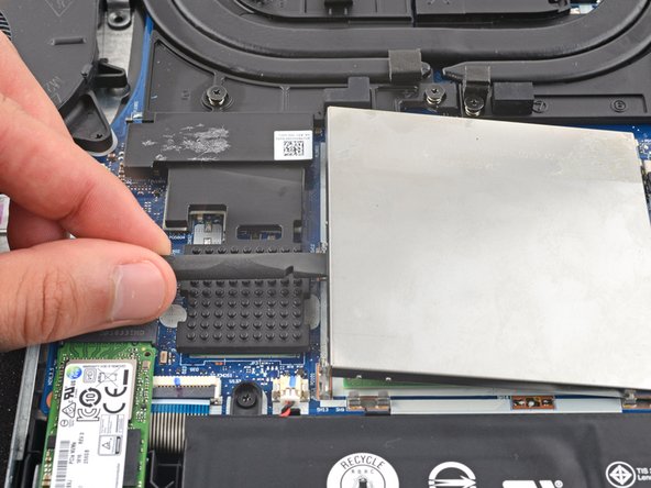

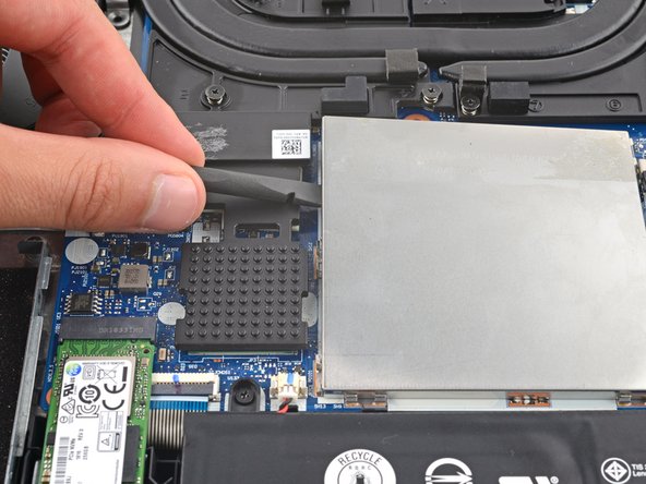

  9. Lenovo Legion Y7000P RAM Replacement, Heat the black cover: crwdns2935265:09crwdnd2935265:01crwdnd2935265:02crwdne2935265:0 Lenovo Legion Y7000P RAM Replacement, Heat the black cover: crwdns2935265:09crwdnd2935265:02crwdnd2935265:02crwdne2935265:0
    • A stiff, black cover runs across the heatsink and fans.
    • Removing the cover makes repairs much easier, but isn't required. If you don't want to remove the cover, you can roll it onto itself to keep it out of the way and skip the next two steps.
    • Heat an iOpener and apply it to the cover for two minutes.
    • You can also use a hair dryer. Follow this guide for more instructions.
  10. Lenovo Legion Y7000P RAM Replacement, Remove the cover: crwdns2935265:010crwdnd2935265:01crwdnd2935265:03crwdne2935265:0 Lenovo Legion Y7000P RAM Replacement, Remove the cover: crwdns2935265:010crwdnd2935265:02crwdnd2935265:03crwdne2935265:0 Lenovo Legion Y7000P RAM Replacement, Remove the cover: crwdns2935265:010crwdnd2935265:03crwdnd2935265:03crwdne2935265:0
    • Gently peel up and remove the black cover.
    • During reassembly, press the cover back into place using the residual adhesive.

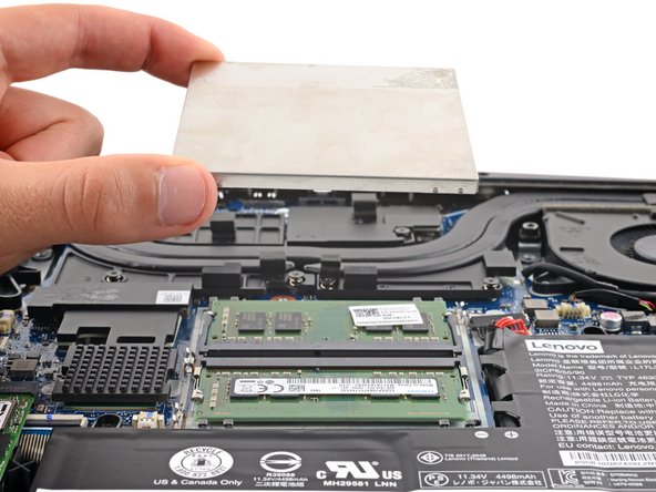

  12. Lenovo Legion Y7000P RAM Replacement, Pry up the metal shield: crwdns2935265:012crwdnd2935265:01crwdnd2935265:03crwdne2935265:0 Lenovo Legion Y7000P RAM Replacement, Pry up the metal shield: crwdns2935265:012crwdnd2935265:02crwdnd2935265:03crwdne2935265:0 Lenovo Legion Y7000P RAM Replacement, Pry up the metal shield: crwdns2935265:012crwdnd2935265:03crwdnd2935265:03crwdne2935265:0
    • A metal shield covers the sticks of RAM.
    • Use a spudger to pry up the left side of the metal shield.
  13. Lenovo Legion Y7000P RAM Replacement, Remove the metal shield: crwdns2935265:013crwdnd2935265:01crwdnd2935265:02crwdne2935265:0 Lenovo Legion Y7000P RAM Replacement, Remove the metal shield: crwdns2935265:013crwdnd2935265:02crwdnd2935265:02crwdne2935265:0
    • Remove the metal shield.
    • During reassembly, align the shield with its metal clips and press down firmly around the perimeter to secure the shield.
