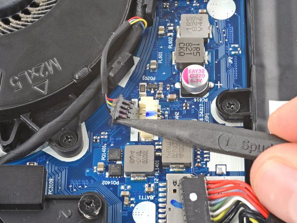

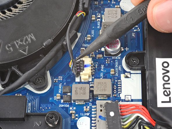

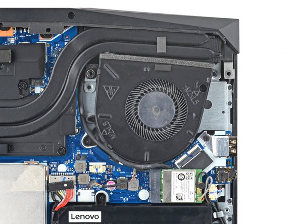

  12. Lenovo Legion Y7000P Hinge Cover Replacement, Disconnect the fan cable: crwdns2935265:012crwdnd2935265:01crwdnd2935265:03crwdne2935265:0 Lenovo Legion Y7000P Hinge Cover Replacement, Disconnect the fan cable: crwdns2935265:012crwdnd2935265:02crwdnd2935265:03crwdne2935265:0 Lenovo Legion Y7000P Hinge Cover Replacement, Disconnect the fan cable: crwdns2935265:012crwdnd2935265:03crwdnd2935265:03crwdne2935265:0
    • The left fan will be on your right-hand side, as the laptop is laying upside down.
    • Use the point of a spudger to push on alternating sides of the left fan cable connector to "walk" it out of its socket.

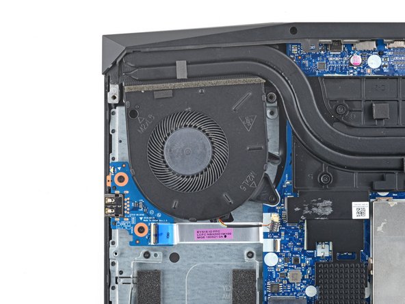

  13. Lenovo Legion Y7000P Hinge Cover Replacement, Unclip the display cable: crwdns2935265:013crwdnd2935265:01crwdnd2935265:02crwdne2935265:0 Lenovo Legion Y7000P Hinge Cover Replacement, Unclip the display cable: crwdns2935265:013crwdnd2935265:02crwdnd2935265:02crwdne2935265:0
    • Use the point of a spudger to guide the display cable out of the clips on the bottom edge of the left fan.

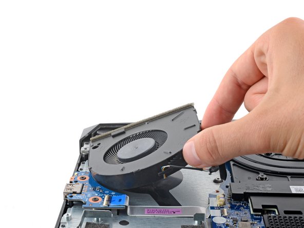

  14. Lenovo Legion Y7000P Hinge Cover Replacement, Unfasten the left fan: crwdns2935265:014crwdnd2935265:01crwdnd2935265:02crwdne2935265:0 Lenovo Legion Y7000P Hinge Cover Replacement, Unfasten the left fan: crwdns2935265:014crwdnd2935265:02crwdnd2935265:02crwdne2935265:0
    • Use a Phillips screwdriver to remove the two 5.7 mm‑long screws securing the left fan.

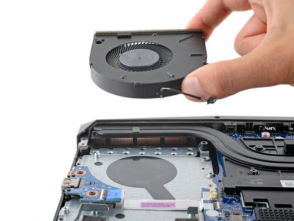

  15. Lenovo Legion Y7000P Hinge Cover Replacement, Remove the left fan: crwdns2935265:015crwdnd2935265:01crwdnd2935265:03crwdne2935265:0 Lenovo Legion Y7000P Hinge Cover Replacement, Remove the left fan: crwdns2935265:015crwdnd2935265:02crwdnd2935265:03crwdne2935265:0 Lenovo Legion Y7000P Hinge Cover Replacement, Remove the left fan: crwdns2935265:015crwdnd2935265:03crwdnd2935265:03crwdne2935265:0
    • Lift the top edge of the left fan.
    • Slide the left fan cable out from under the display cable and remove the fan.
    • During reassembly, make sure the fan cable is under the display cable before securing the fan.

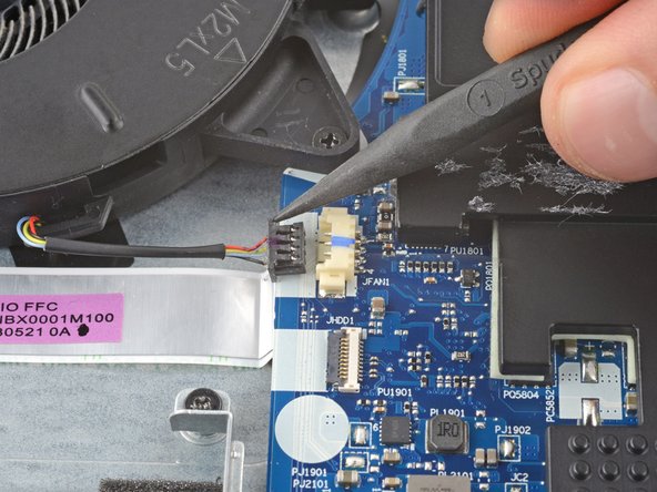

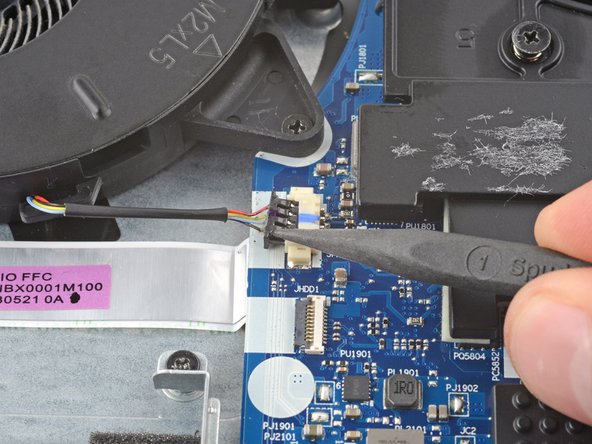

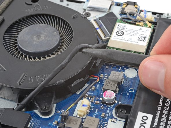

  16. Lenovo Legion Y7000P Hinge Cover Replacement, Disconnect the fan cable: crwdns2935265:016crwdnd2935265:01crwdnd2935265:03crwdne2935265:0 Lenovo Legion Y7000P Hinge Cover Replacement, Disconnect the fan cable: crwdns2935265:016crwdnd2935265:02crwdnd2935265:03crwdne2935265:0 Lenovo Legion Y7000P Hinge Cover Replacement, Disconnect the fan cable: crwdns2935265:016crwdnd2935265:03crwdnd2935265:03crwdne2935265:0
    • The right fan will be on your left-hand side, as the laptop is laying upside down.
    • Use the point of a spudger to push on alternating sides of the right fan cable connector to "walk" it out of its socket.

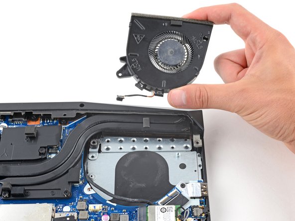

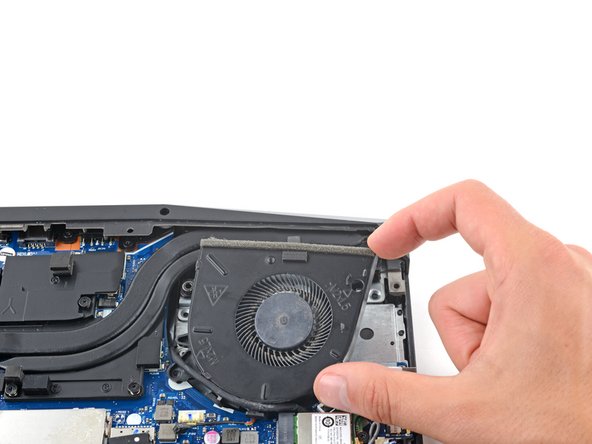

  18. Lenovo Legion Y7000P Hinge Cover Replacement, Remove the right fan: crwdns2935265:018crwdnd2935265:01crwdnd2935265:03crwdne2935265:0 Lenovo Legion Y7000P Hinge Cover Replacement, Remove the right fan: crwdns2935265:018crwdnd2935265:02crwdnd2935265:03crwdne2935265:0 Lenovo Legion Y7000P Hinge Cover Replacement, Remove the right fan: crwdns2935265:018crwdnd2935265:03crwdnd2935265:03crwdne2935265:0
    • Remove the right fan.

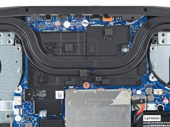

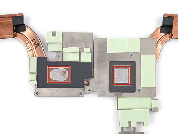

  19. Lenovo Legion Y7000P Hinge Cover Replacement, Unfasten the heatsink: crwdns2935265:019crwdnd2935265:01crwdnd2935265:02crwdne2935265:0 Lenovo Legion Y7000P Hinge Cover Replacement, Unfasten the heatsink: crwdns2935265:019crwdnd2935265:02crwdnd2935265:02crwdne2935265:0
    • Use a Phillips screwdriver to loosen the six captive screws securing the heatsink.
    • Don't try to fully remove the screws, as they're held to the heatsink with springs.
    • During reassembly, tighten the screws in ascending order (starting with 1) based on the number printed next to each screw.

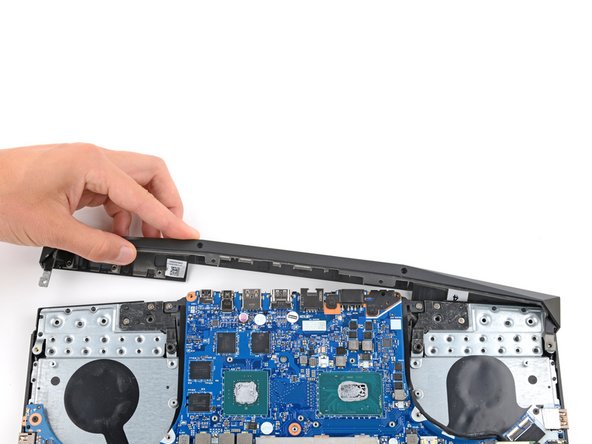

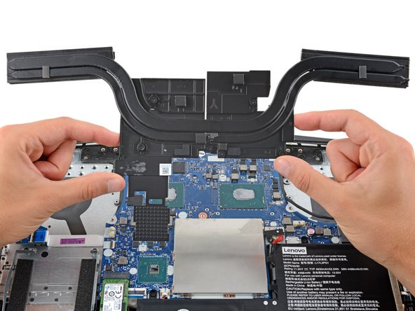

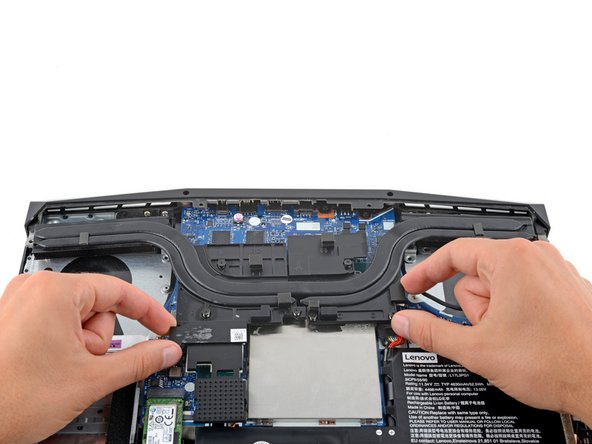

  20. Lenovo Legion Y7000P Hinge Cover Replacement, Remove the heatsink: crwdns2935265:020crwdnd2935265:01crwdnd2935265:03crwdne2935265:0 Lenovo Legion Y7000P Hinge Cover Replacement, Remove the heatsink: crwdns2935265:020crwdnd2935265:02crwdnd2935265:03crwdne2935265:0 Lenovo Legion Y7000P Hinge Cover Replacement, Remove the heatsink: crwdns2935265:020crwdnd2935265:03crwdnd2935265:03crwdne2935265:0
    • Grip the bottom corners of the heatsink and pull it away from the hinge to free the top edge.
    • Remove the heatsink.
  21. Lenovo Legion Y7000P Hinge Cover Replacement, Reassembly information: crwdns2935265:021crwdnd2935265:01crwdnd2935265:02crwdne2935265:0 Lenovo Legion Y7000P Hinge Cover Replacement, Reassembly information: crwdns2935265:021crwdnd2935265:02crwdnd2935265:02crwdne2935265:0
    • Before installing a new heatsink, follow this guide to clean the CPU and heatsink and reapply thermal paste.

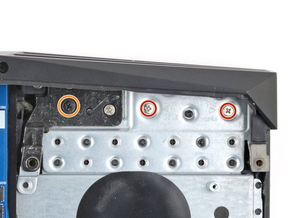

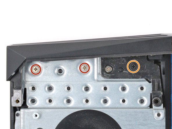

  22. Lenovo Legion Y7000P Hinge Cover Replacement, Unfasten the hinge cover: crwdns2935265:022crwdnd2935265:01crwdnd2935265:03crwdne2935265:0 Lenovo Legion Y7000P Hinge Cover Replacement, Unfasten the hinge cover: crwdns2935265:022crwdnd2935265:02crwdnd2935265:03crwdne2935265:0 Lenovo Legion Y7000P Hinge Cover Replacement, Unfasten the hinge cover: crwdns2935265:022crwdnd2935265:03crwdnd2935265:03crwdne2935265:0
    • Use a Phillips screwdriver to remove the six screws securing the hinge cover:
    • Four 5.6 mm‑long screws
    • Two 8.7 mm‑long screws

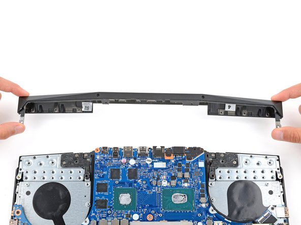

  23. Lenovo Legion Y7000P Hinge Cover Replacement, Remove the hinge cover: crwdns2935265:023crwdnd2935265:01crwdnd2935265:03crwdne2935265:0 Lenovo Legion Y7000P Hinge Cover Replacement, Remove the hinge cover: crwdns2935265:023crwdnd2935265:02crwdnd2935265:03crwdne2935265:0 Lenovo Legion Y7000P Hinge Cover Replacement, Remove the hinge cover: crwdns2935265:023crwdnd2935265:03crwdnd2935265:03crwdne2935265:0
    • Firmly pull the hinge cover away from the frame and remove it.
