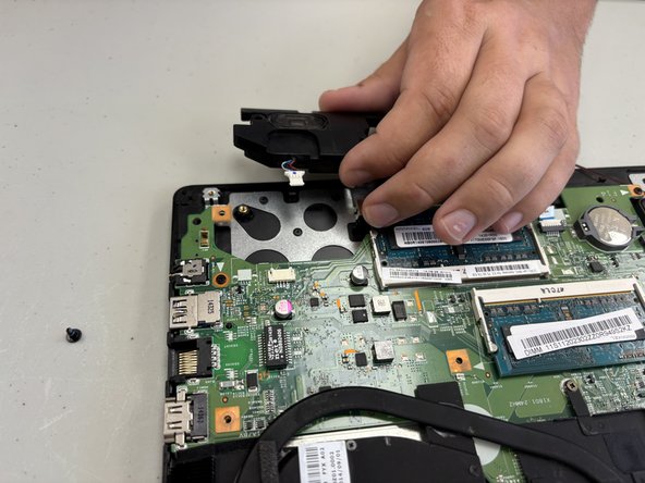

  7. Lenovo Flex 2-15 Motherboard Replacement, Speaker: crwdns2935265:07crwdnd2935265:01crwdnd2935265:01crwdne2935265:0
    • Use a Phillips #00 screwdriver to remove the one 4 mm screw on the left speaker.
  8. Lenovo Flex 2-15 Motherboard Replacement: crwdns2935265:08crwdnd2935265:01crwdnd2935265:01crwdne2935265:0
    • Use a Phillips #00 screwdriver to disconnect the one 4 mm screw on the right speaker.
  9. Lenovo Flex 2-15 Motherboard Replacement: crwdns2935265:09crwdnd2935265:01crwdnd2935265:02crwdne2935265:0 Lenovo Flex 2-15 Motherboard Replacement: crwdns2935265:09crwdnd2935265:02crwdnd2935265:02crwdne2935265:0
    • Disconnect the speaker the connector on the right speaker from the motherboard by pulling the connector out with your fingernail.
  10. Lenovo Flex 2-15 Motherboard Replacement: crwdns2935265:010crwdnd2935265:01crwdnd2935265:01crwdne2935265:0
    • Gently lift the two speakers out with your hands.

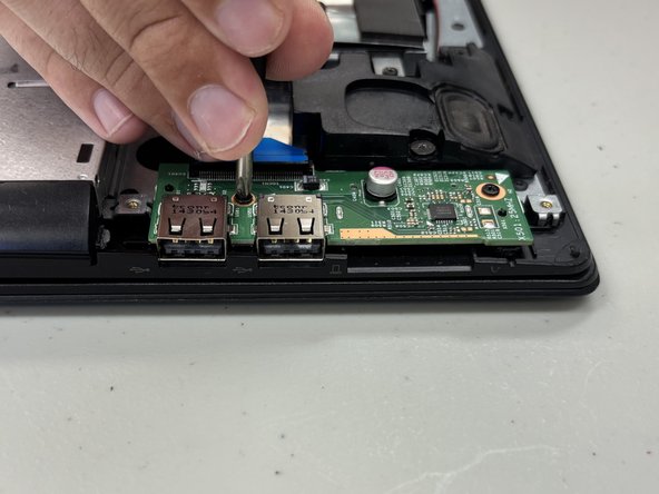

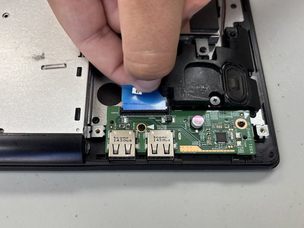

  11. Lenovo Flex 2-15 Motherboard Replacement, Daughterboard: crwdns2935265:011crwdnd2935265:01crwdnd2935265:02crwdne2935265:0 Lenovo Flex 2-15 Motherboard Replacement, Daughterboard: crwdns2935265:011crwdnd2935265:02crwdnd2935265:02crwdne2935265:0
    • Flip up the black ZIF locking flap. Disconnect the ribbon cable.
  12. Lenovo Flex 2-15 Motherboard Replacement: crwdns2935265:012crwdnd2935265:01crwdnd2935265:02crwdne2935265:0 Lenovo Flex 2-15 Motherboard Replacement: crwdns2935265:012crwdnd2935265:02crwdnd2935265:02crwdne2935265:0
    • Remove the two 4 mm Phillips #00 screws that secure the daughterboard.
  13. Lenovo Flex 2-15 Motherboard Replacement: crwdns2935265:013crwdnd2935265:01crwdnd2935265:01crwdne2935265:0
    • Grab the daughterboard with your fingers and lift it straight up and out of the chassis.

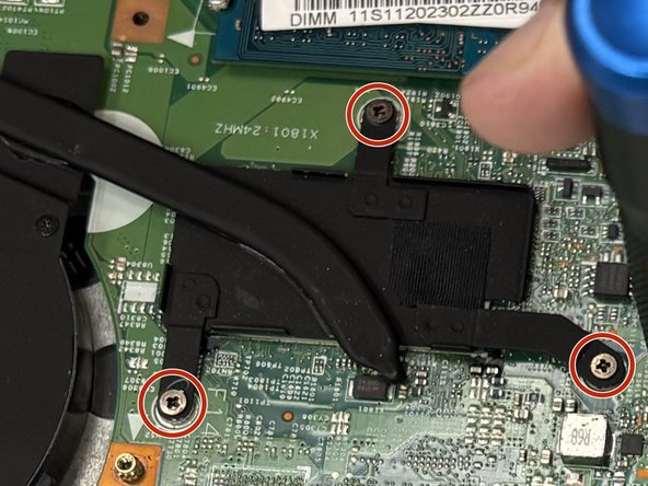

  18. Lenovo Flex 2-15 Motherboard Replacement, Motherboard: crwdns2935265:018crwdnd2935265:01crwdnd2935265:03crwdne2935265:0 Lenovo Flex 2-15 Motherboard Replacement, Motherboard: crwdns2935265:018crwdnd2935265:02crwdnd2935265:03crwdne2935265:0 Lenovo Flex 2-15 Motherboard Replacement, Motherboard: crwdns2935265:018crwdnd2935265:03crwdnd2935265:03crwdne2935265:0
    • Disconnect the fan connector from the motherboard.
    • Remove the three 4 mm screws that secure the heatsink with a Phillips #00 screwdriver.
    • Remove the heatsink carefully and set aside.
    • Do not strip the screws.
    • Do not bend the pins in the fan connector port.
    • You will need to reapply thermal paste before replacing the heatsink.

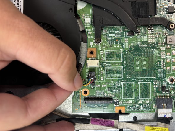

  19. Lenovo Flex 2-15 Motherboard Replacement: crwdns2935265:019crwdnd2935265:01crwdnd2935265:01crwdne2935265:0
    • Using your fingers, pinch the release levers on the side of the ribbon cable.
    • Remove the ribbon cable near the optical drive with your fingers.
    • Do not break the connector on the end of the cable.

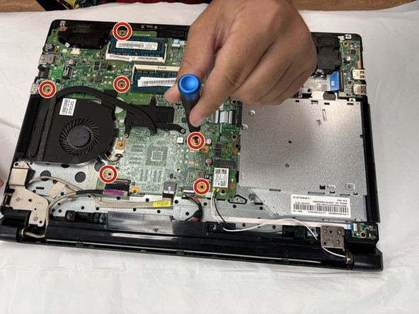

  20. Lenovo Flex 2-15 Motherboard Replacement: crwdns2935265:020crwdnd2935265:01crwdnd2935265:02crwdne2935265:0 Lenovo Flex 2-15 Motherboard Replacement: crwdns2935265:020crwdnd2935265:02crwdnd2935265:02crwdne2935265:0
    • Remove the 4 mm standoff screws in the motherboard with a Phillips #00 screwdriver.

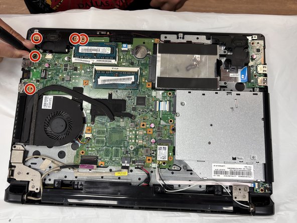

  24. Lenovo Flex 2-15 Motherboard Replacement: crwdns2935265:024crwdnd2935265:01crwdnd2935265:02crwdne2935265:0 Lenovo Flex 2-15 Motherboard Replacement: crwdns2935265:024crwdnd2935265:02crwdnd2935265:02crwdne2935265:0
    • Remove the five 4 mm screws at the top of the motherboard using a Phillips #00 screwdriver.
  25. Lenovo Flex 2-15 Motherboard Replacement: crwdns2935265:025crwdnd2935265:01crwdnd2935265:01crwdne2935265:0
    • Remove the last standoff screw near the SSD drive with the Phillips #00 screwdriver.
  26. Lenovo Flex 2-15 Motherboard Replacement: crwdns2935265:026crwdnd2935265:01crwdnd2935265:01crwdne2935265:0
    • Gently lift and remove the motherboard from the laptop; there should be little resistance when removing it.
    • If you have difficulty removing the board, check that you have removed all connectors and ribbon cables connecting the board. You may also remove the SSD for additional ease.
    • Lay the motherboard on a nonconducting surface, this will prevent short circuiting.
