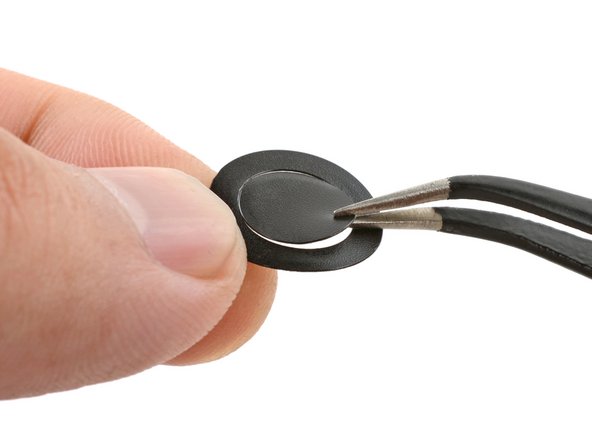

    13. Left Joy-Con Joystick Replacement, Install the Gulikit joystick ring sticker: crwdns2935265:013crwdnd2935265:01crwdnd2935265:02crwdne2935265:0 Left Joy-Con Joystick Replacement, Install the Gulikit joystick ring sticker: crwdns2935265:013crwdnd2935265:02crwdnd2935265:02crwdne2935265:0
      • If you've replaced the joystick with a Gulikit module and it came with a joystick ring sticker, follow the next two steps to install it.
      • Use your fingers to pull the thumbstick off of the Gulikit joystick module.
    14. Left Joy-Con Joystick Replacement: crwdns2935265:014crwdnd2935265:01crwdnd2935265:03crwdne2935265:0 Left Joy-Con Joystick Replacement: crwdns2935265:014crwdnd2935265:02crwdnd2935265:03crwdne2935265:0 Left Joy-Con Joystick Replacement: crwdns2935265:014crwdnd2935265:03crwdnd2935265:03crwdne2935265:0
      • Peel the ring sticker from its liner.
      • If the sticker center is still attached, separate and remove it from the ring.
      • Set the ring sticker in the joystick recess and press it with your fingers for a few seconds to attach it.
