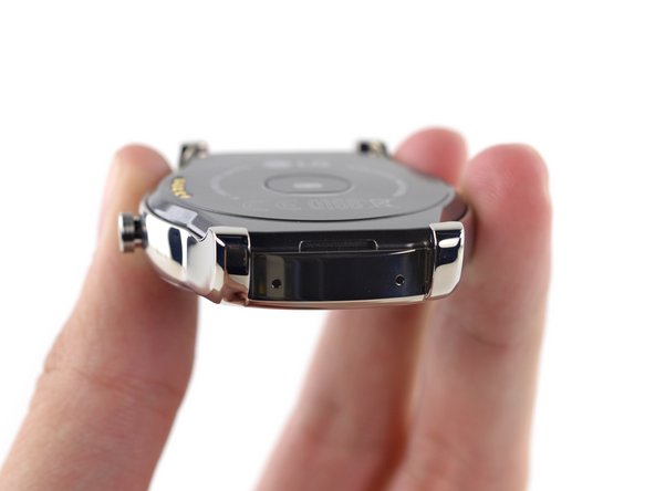

    • Barring the dark watch face, this device could certainly be mistaken for a mechanical watch, until you flip it over...
    • The rear of the watch features a heart rate sensor, charging dock contacts, and the model number (LG-W150).

    • The 22 mm standard leather watch band can be swapped out for other bands of various colors and materials.
    • Our handy pointy angled tweezers are once again invaluable spring bar removers.
    • Removing the band exposes a couple of ports, likely for the microphone—or microphones?

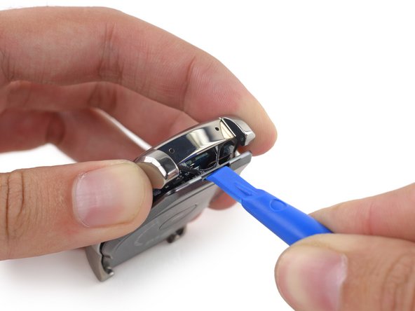

    • The last time we tore down an LG smartwatch, we were pleased to find screws securing an o-ring sealed rear door. Today we're heating our iOpener and feeling a little sad.
    • However, thanks to a handy pry notch, things aren't too bad. But you will need to replace the adhesive before re-sealing the watch, to maintain that IP67 water resistant rating.
    • IP67 is a water and dust resistance rating that guarantees the device to be dust-tight, and able to survive submersion in 1 meter of water for 30 minutes.

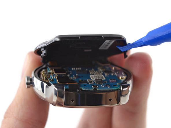

  5. LG Watch Urbane Teardown: crwdns2935265:05crwdnd2935265:01crwdnd2935265:03crwdne2935265:0 LG Watch Urbane Teardown: crwdns2935265:05crwdnd2935265:02crwdnd2935265:03crwdne2935265:0 LG Watch Urbane Teardown: crwdns2935265:05crwdnd2935265:03crwdnd2935265:03crwdne2935265:0

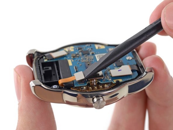

    • Apart from the glue, the rear case comes away nice and clean—no cables, no booby traps. We like it.
    • Power from the charger feeds through the rear case onto a tidy row of spring contacts beside the motherboard.

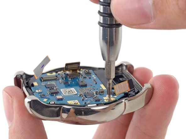

    • Speaking of the motherboard, it's time to start digging out the Urbane's silicon. Starting with the battery, we flick away a few cable connectors and twist out the tiny watch-sized screws.
    • Happily, these are totally ordinary (albeit tiny) Phillips screws—none of that sketchy tri-wing business you find in so many flashy smartwatches these days.

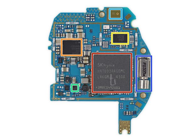

    • We peel the motherboard out of the chassis to get a better look at this wearable's hardware:
    • SK Hynix H9TU32A4GDMC-LRKGM 512 MB mobile DDR2. The Qualcomm Snapdragon 400 SoC is hidden beneath this DRAM device.
    • Qualcomm PM8226 power management IC
    • Broadcom BCM4343 integrated communications module
    • Texas Instruments BQ27421-G1 battery fuel gauge
    • Single microphone (Knowles) —we're not sure why there were two ports; maybe just symmetry?
    • Vibrator motor—soldered in place on the motherboard

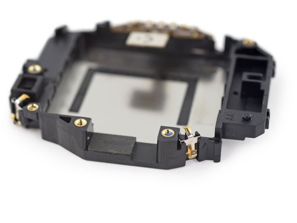

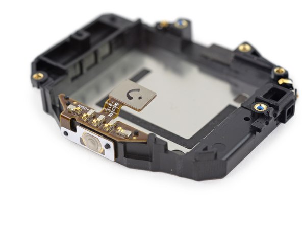

    • Two screws and some mild adhesive are all that stand between us and picking out the plastic midframe.
    • As devices shrink, manufacturers are turning to adhesive instead of screws or clips.
    • On the whole, this has been bad news for repairs—but in this case, LG seems to have found the secret recipe that balances construction strength with pry-ability.
    • Picking out the watch's midframe reveals a single cable responsible for the crown button and charging cradle ports, and a pair of spring contacts that connect the motherboard to the watch body, perhaps to use the body as an antenna.

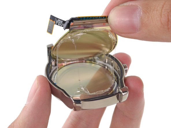

  10. LG Watch Urbane Teardown: crwdns2935265:010crwdnd2935265:01crwdnd2935265:03crwdne2935265:0 LG Watch Urbane Teardown: crwdns2935265:010crwdnd2935265:02crwdnd2935265:03crwdne2935265:0 LG Watch Urbane Teardown: crwdns2935265:010crwdnd2935265:03crwdnd2935265:03crwdne2935265:0

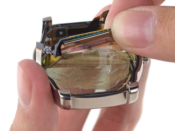

    • Our iOpener tags in to help dispatch the P-OLED display.
    • This incredibly thin display appears to be made up of several layers, that need to be peeled up off the back of the glass in order to remove the glass.
    • As we peel up the display a strange, stretchy membrane sticks to the back of the digitizer.
    • This membrane is definitely serving as an adhesive between the display and the digitizer, but may also serve some higher purpose as a thin film.

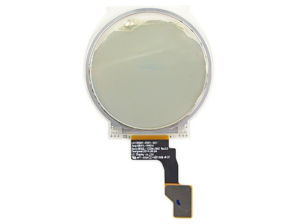

  11. LG Watch Urbane Teardown: crwdns2935265:011crwdnd2935265:01crwdnd2935265:03crwdne2935265:0 LG Watch Urbane Teardown: crwdns2935265:011crwdnd2935265:02crwdnd2935265:03crwdne2935265:0 LG Watch Urbane Teardown: crwdns2935265:011crwdnd2935265:03crwdnd2935265:03crwdne2935265:0

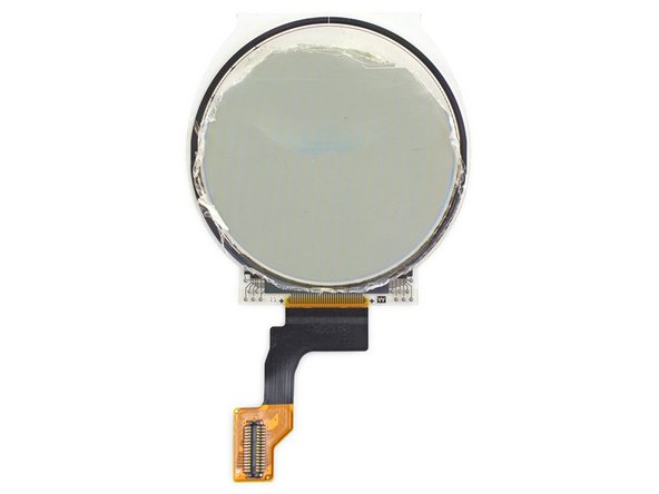

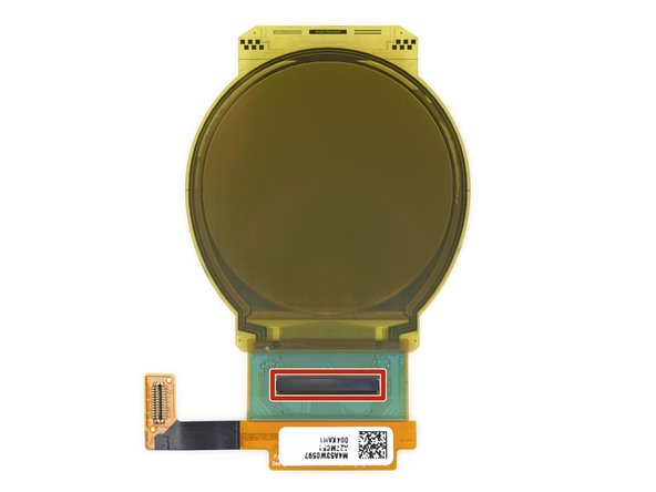

    • Peeling up the display
    • Now that it's free of the case, we can get a closer look at the Urbane's 245ppi P-OLED screen.
    • If you think this display looks familiar, we're right with you. LG says they built the Urbane around the display used in the LG G Watch R.
    • Right below the screen, we find an LG Innotek LGS32057-05-0547 POLED display driver.

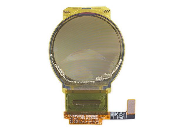

  12. LG Watch Urbane Teardown: crwdns2935265:012crwdnd2935265:01crwdnd2935265:03crwdne2935265:0 LG Watch Urbane Teardown: crwdns2935265:012crwdnd2935265:02crwdnd2935265:03crwdne2935265:0 LG Watch Urbane Teardown: crwdns2935265:012crwdnd2935265:03crwdnd2935265:03crwdne2935265:0
    • The next layer off the screen sandwich is the digitizer. Also held in with sticky adhesive on both sides, it bears the LG Display co., Ltd marking.
    • LG produces their own displays for their gadgets—something not every manufacturer is able to do.

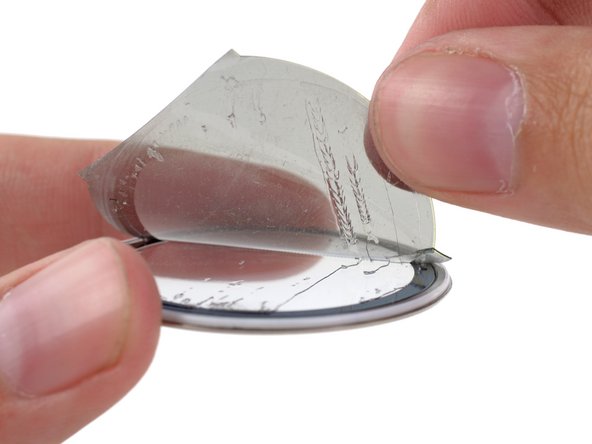

  13. LG Watch Urbane Teardown: crwdns2935265:013crwdnd2935265:01crwdnd2935265:03crwdne2935265:0 LG Watch Urbane Teardown: crwdns2935265:013crwdnd2935265:02crwdnd2935265:03crwdne2935265:0 LG Watch Urbane Teardown: crwdns2935265:013crwdnd2935265:03crwdnd2935265:03crwdne2935265:0

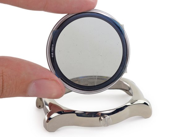

    • We put our curved blade to work, and pop out the display glass.
    • The glass floats away intact, in all its perfect circularness, and the last layer of the display—which looks like a polarizing film—peels off, leaving behind some gooey optically clear adhesive (OCA) residue.
    • Unfortunately, it seems like the procedure we just endured is the only way to replace a cracked screen—the display and digitizer are adhered to the back of the glass after it is installed in the watch body.
    • That means to replace a cracked glass you'll have to remove all of the pieces of the display, install a new glass front, and then adhere a new OLED display to the back of the glass with OCA.

What is the front glass made out of?
David S - crwdns2934203:0crwdne2934203:0
