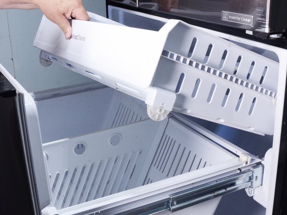

  3. LG Refrigerator Evaporator Fan Replacement, Remove the drawer and bin: crwdns2935265:03crwdnd2935265:01crwdnd2935265:03crwdne2935265:0 LG Refrigerator Evaporator Fan Replacement, Remove the drawer and bin: crwdns2935265:03crwdnd2935265:02crwdnd2935265:03crwdne2935265:0 LG Refrigerator Evaporator Fan Replacement, Remove the drawer and bin: crwdns2935265:03crwdnd2935265:03crwdnd2935265:03crwdne2935265:0
    • Lift and remove the upper pull-out drawer.
    • Lift and remove the main drawer bin.

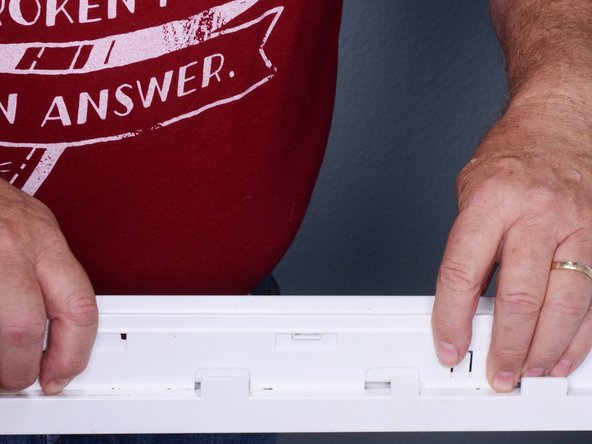

  4. LG Refrigerator Evaporator Fan Replacement, Remove the drawer rail covers: crwdns2935265:04crwdnd2935265:01crwdnd2935265:03crwdne2935265:0 LG Refrigerator Evaporator Fan Replacement, Remove the drawer rail covers: crwdns2935265:04crwdnd2935265:02crwdnd2935265:03crwdne2935265:0 LG Refrigerator Evaporator Fan Replacement, Remove the drawer rail covers: crwdns2935265:04crwdnd2935265:03crwdnd2935265:03crwdne2935265:0
    • Use your finger or a flat-blade screwdriver to depress the two locking tabs on the right drawer rail cover.
    • Lift the cover off of the rail and remove it.
    • Repeat this procedure for the left drawer rail cover.
  5. LG Refrigerator Evaporator Fan Replacement, Reassembly notes: crwdns2935265:05crwdnd2935265:01crwdnd2935265:02crwdne2935265:0 LG Refrigerator Evaporator Fan Replacement, Reassembly notes: crwdns2935265:05crwdnd2935265:02crwdnd2935265:02crwdne2935265:0
    • The drawer rail covers can be tricky to reinstall. Follow these steps to reinstall them:
    • Hold the drawer rail cover flush against the side of the drawer rail.
    • You should feel the locking tabs protruding.
    • Push the rail cover straight downward to install. It should click into place.

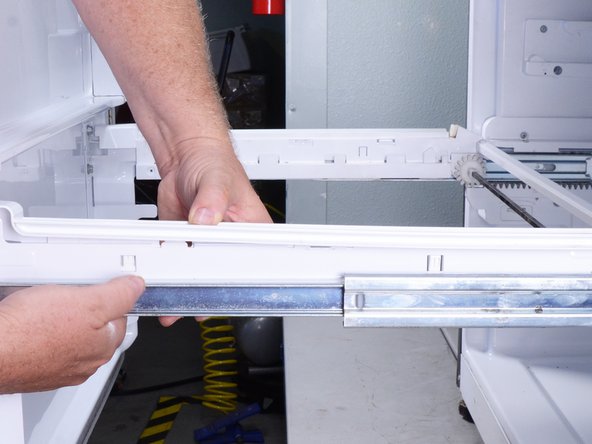

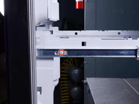

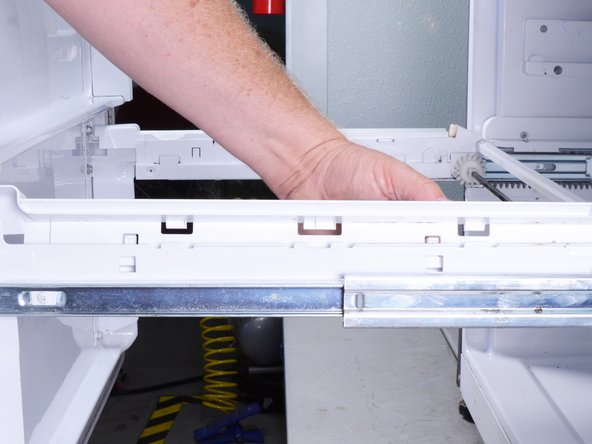

  6. LG Refrigerator Evaporator Fan Replacement, Remove the drawer: crwdns2935265:06crwdnd2935265:01crwdnd2935265:02crwdne2935265:0 LG Refrigerator Evaporator Fan Replacement, Remove the drawer: crwdns2935265:06crwdnd2935265:02crwdnd2935265:02crwdne2935265:0
    • Use a Phillips screwdriver to remove the screw securing the drawer to each of the drawer slides.
  7. LG Refrigerator Evaporator Fan Replacement: crwdns2935265:07crwdnd2935265:01crwdnd2935265:03crwdne2935265:0 LG Refrigerator Evaporator Fan Replacement: crwdns2935265:07crwdnd2935265:02crwdnd2935265:03crwdne2935265:0 LG Refrigerator Evaporator Fan Replacement: crwdns2935265:07crwdnd2935265:03crwdnd2935265:03crwdne2935265:0
    • Lift the front of the drawer up.
    • Pull the drawer toward you to release the drawer from the drawer slides.
    • Remove the freezer drawer.

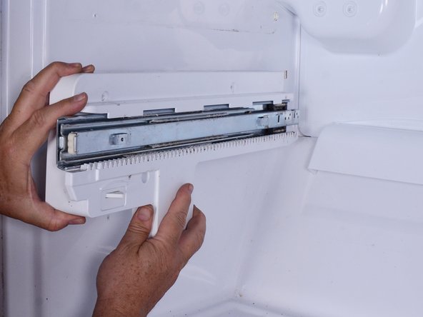

  8. LG Refrigerator Evaporator Fan Replacement, Release the drawer slides: crwdns2935265:08crwdnd2935265:01crwdnd2935265:01crwdne2935265:0
    • Use a Phillips screwdriver to remove the screws securing both left drawer slides.
  9. LG Refrigerator Evaporator Fan Replacement, Remove the upper left drawer slide: crwdns2935265:09crwdnd2935265:01crwdnd2935265:02crwdne2935265:0 LG Refrigerator Evaporator Fan Replacement, Remove the upper left drawer slide: crwdns2935265:09crwdnd2935265:02crwdnd2935265:02crwdne2935265:0
    • Pull the upper left drawer slide slightly towards you to release the locking tab at the rear.
    • Remove the upper left drawer slide.

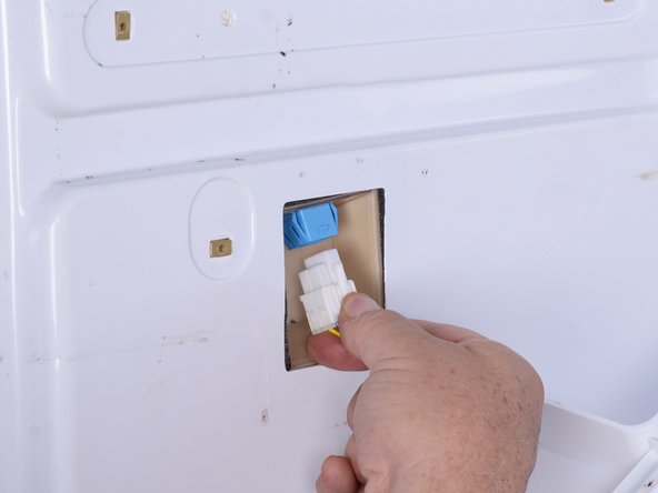

  10. LG Refrigerator Evaporator Fan Replacement, Release lower left drawer slide and reposition it: crwdns2935265:010crwdnd2935265:01crwdnd2935265:03crwdne2935265:0 LG Refrigerator Evaporator Fan Replacement, Release lower left drawer slide and reposition it: crwdns2935265:010crwdnd2935265:02crwdnd2935265:03crwdne2935265:0 LG Refrigerator Evaporator Fan Replacement, Release lower left drawer slide and reposition it: crwdns2935265:010crwdnd2935265:03crwdnd2935265:03crwdne2935265:0
    • Pull the lower left drawer slide slightly toward you to release the locking tab at the rear.
    • Reposition the lower left drawer slide to gain access to the door switch connector.
  11. LG Refrigerator Evaporator Fan Replacement, Disconnect the drawer switch and remove the lower slide: crwdns2935265:011crwdnd2935265:01crwdnd2935265:03crwdne2935265:0 LG Refrigerator Evaporator Fan Replacement, Disconnect the drawer switch and remove the lower slide: crwdns2935265:011crwdnd2935265:02crwdnd2935265:03crwdne2935265:0 LG Refrigerator Evaporator Fan Replacement, Disconnect the drawer switch and remove the lower slide: crwdns2935265:011crwdnd2935265:03crwdnd2935265:03crwdne2935265:0
    • Squeeze the door switch connector to release it.
    • Pull the door switch connector down to disconnect it.
    • Remove the lower left drawer slide.

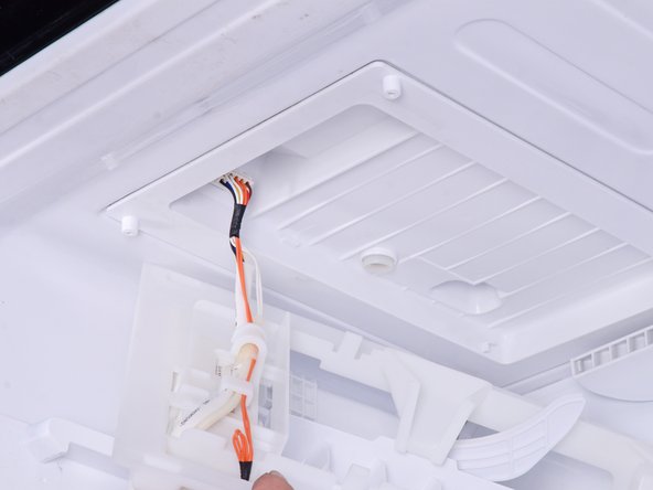

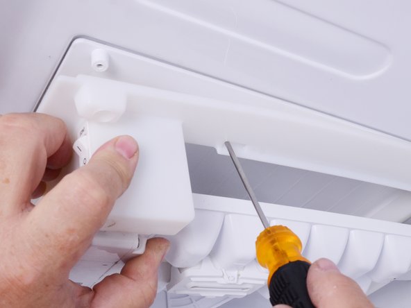

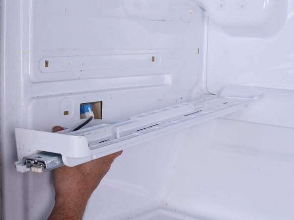

  12. LG Refrigerator Evaporator Fan Replacement, Release the ice maker: crwdns2935265:012crwdnd2935265:01crwdnd2935265:01crwdne2935265:0
    • Use a Phillips screwdriver to remove the screws securing the ice maker to the top of the freezer compartment.
  13. LG Refrigerator Evaporator Fan Replacement: crwdns2935265:013crwdnd2935265:01crwdnd2935265:03crwdne2935265:0 LG Refrigerator Evaporator Fan Replacement: crwdns2935265:013crwdnd2935265:02crwdnd2935265:03crwdne2935265:0 LG Refrigerator Evaporator Fan Replacement: crwdns2935265:013crwdnd2935265:03crwdnd2935265:03crwdne2935265:0
    • Insert a flat-blade screwdriver into the slot located on the right edge of the ice maker.
    • Pry outward with the screwdriver to release the locking tab securing the ice maker to the fridge.
    • When the tab releases, pull the right front corner of the ice maker down.
  14. LG Refrigerator Evaporator Fan Replacement: crwdns2935265:014crwdnd2935265:01crwdnd2935265:01crwdne2935265:0
    • Repeat the previous operation on the left side of the ice maker to release it.
  15. LG Refrigerator Evaporator Fan Replacement: crwdns2935265:015crwdnd2935265:01crwdnd2935265:03crwdne2935265:0 LG Refrigerator Evaporator Fan Replacement: crwdns2935265:015crwdnd2935265:02crwdnd2935265:03crwdne2935265:0 LG Refrigerator Evaporator Fan Replacement: crwdns2935265:015crwdnd2935265:03crwdnd2935265:03crwdne2935265:0
    • Grasp the front edge of the ice maker and pull it towards you.
    • Lower the ice maker.

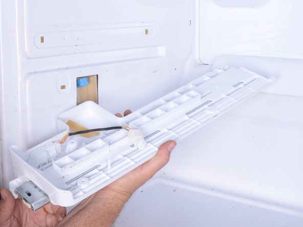

  16. LG Refrigerator Evaporator Fan Replacement, Disconnect and remove the ice maker: crwdns2935265:016crwdnd2935265:01crwdnd2935265:03crwdne2935265:0 LG Refrigerator Evaporator Fan Replacement, Disconnect and remove the ice maker: crwdns2935265:016crwdnd2935265:02crwdnd2935265:03crwdne2935265:0 LG Refrigerator Evaporator Fan Replacement, Disconnect and remove the ice maker: crwdns2935265:016crwdnd2935265:03crwdnd2935265:03crwdne2935265:0
    • Squeeze the ice maker connector to release it and pull it straight out to disconnect it.
    • Remove the ice maker.

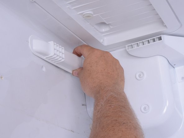

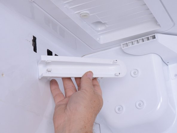

  17. LG Refrigerator Evaporator Fan Replacement, Remove air return cover: crwdns2935265:017crwdnd2935265:01crwdnd2935265:03crwdne2935265:0 LG Refrigerator Evaporator Fan Replacement, Remove air return cover: crwdns2935265:017crwdnd2935265:02crwdnd2935265:03crwdne2935265:0 LG Refrigerator Evaporator Fan Replacement, Remove air return cover: crwdns2935265:017crwdnd2935265:03crwdnd2935265:03crwdne2935265:0
    • Pinch the rear portion of the air return cover to release it from the freezer wall.
    • Pull the air return cover outward and remove it.

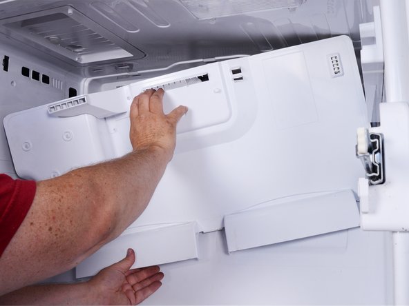

  18. LG Refrigerator Evaporator Fan Replacement, Unfasten the evaporator cover: crwdns2935265:018crwdnd2935265:01crwdnd2935265:01crwdne2935265:0
    • Use a Philips screwdriver to remove the screw (or screws) securing the evaporator cover.
  19. LG Refrigerator Evaporator Fan Replacement, Reposition the evaporator cover: crwdns2935265:019crwdnd2935265:01crwdnd2935265:02crwdne2935265:0 LG Refrigerator Evaporator Fan Replacement, Reposition the evaporator cover: crwdns2935265:019crwdnd2935265:02crwdnd2935265:02crwdne2935265:0
    • Don't try to remove the evaporator cover fully, as It is still connected to the fridge with a number of wires.
    • Grasp the evaporator cover by the air vent openings and pull the top edge toward you.
  20. LG Refrigerator Evaporator Fan Replacement: crwdns2935265:020crwdnd2935265:01crwdnd2935265:03crwdne2935265:0 LG Refrigerator Evaporator Fan Replacement: crwdns2935265:020crwdnd2935265:02crwdnd2935265:03crwdne2935265:0 LG Refrigerator Evaporator Fan Replacement: crwdns2935265:020crwdnd2935265:03crwdnd2935265:03crwdne2935265:0
    • Lift the evaporator cover slightly to release the tabs at the lower edge.
    • Swing the left edge of the evaporator cover toward you and lower it.

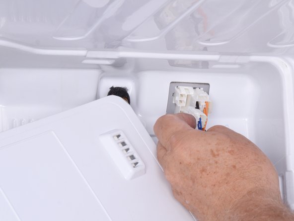

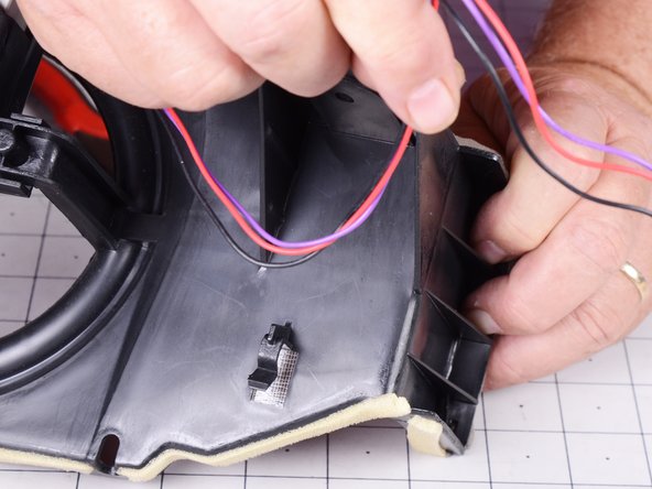

  21. LG Refrigerator Evaporator Fan Replacement, Disconnect the evaporator cover: crwdns2935265:021crwdnd2935265:01crwdnd2935265:03crwdne2935265:0 LG Refrigerator Evaporator Fan Replacement, Disconnect the evaporator cover: crwdns2935265:021crwdnd2935265:02crwdnd2935265:03crwdne2935265:0 LG Refrigerator Evaporator Fan Replacement, Disconnect the evaporator cover: crwdns2935265:021crwdnd2935265:03crwdnd2935265:03crwdne2935265:0
    • Disconnect the electrical connections in the upper left corner of the freezer.
    • Make a note of the locations of the connections for re-installation.
  22. LG Refrigerator Evaporator Fan Replacement: crwdns2935265:022crwdnd2935265:01crwdnd2935265:03crwdne2935265:0 LG Refrigerator Evaporator Fan Replacement: crwdns2935265:022crwdnd2935265:02crwdnd2935265:03crwdne2935265:0 LG Refrigerator Evaporator Fan Replacement: crwdns2935265:022crwdnd2935265:03crwdnd2935265:03crwdne2935265:0
    • Swing the left edge of the evaporator cover further toward you to access the connections in the upper right corner.
    • Squeeze and pull the connector to disconnect the thermistor mounted in the evaporator cover.
  23. LG Refrigerator Evaporator Fan Replacement, Remove the evaporator cover: crwdns2935265:023crwdnd2935265:01crwdnd2935265:02crwdne2935265:0 LG Refrigerator Evaporator Fan Replacement, Remove the evaporator cover: crwdns2935265:023crwdnd2935265:02crwdnd2935265:02crwdne2935265:0
    • Remove the evaporator cover.

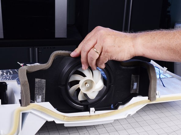

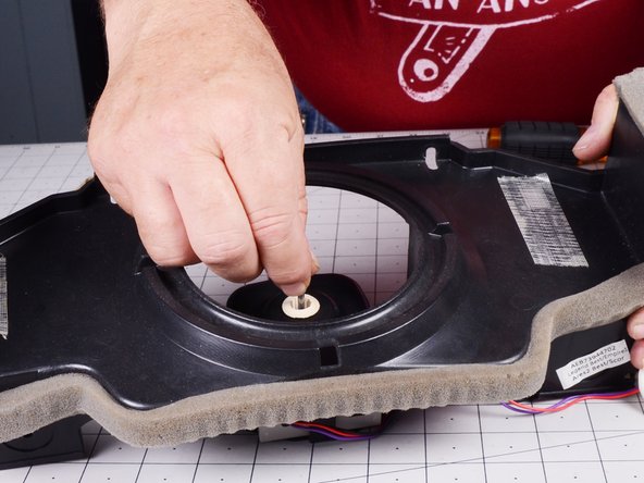

  24. LG Refrigerator Evaporator Fan Replacement, Unfasten and remove the evaporator fan assembly: crwdns2935265:024crwdnd2935265:01crwdnd2935265:03crwdne2935265:0 LG Refrigerator Evaporator Fan Replacement, Unfasten and remove the evaporator fan assembly: crwdns2935265:024crwdnd2935265:02crwdnd2935265:03crwdne2935265:0 LG Refrigerator Evaporator Fan Replacement, Unfasten and remove the evaporator fan assembly: crwdns2935265:024crwdnd2935265:03crwdnd2935265:03crwdne2935265:0
    • Use a Philips screwdriver to remove the screws securing the evaporator fan assembly to the evaporator cover.
    • Remove the evaporator fan assembly.

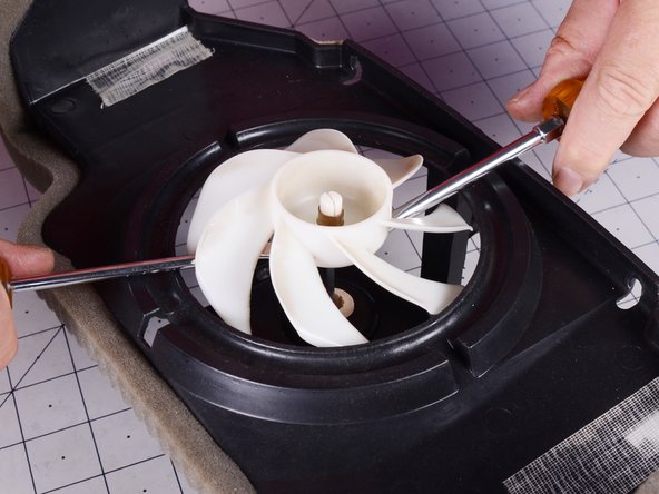

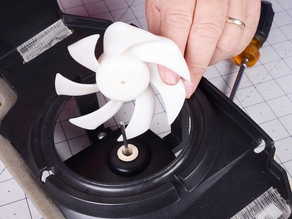

  25. LG Refrigerator Evaporator Fan Replacement, Remove the fan blades from the fan motor shaft: crwdns2935265:025crwdnd2935265:01crwdnd2935265:03crwdne2935265:0 LG Refrigerator Evaporator Fan Replacement, Remove the fan blades from the fan motor shaft: crwdns2935265:025crwdnd2935265:02crwdnd2935265:03crwdne2935265:0 LG Refrigerator Evaporator Fan Replacement, Remove the fan blades from the fan motor shaft: crwdns2935265:025crwdnd2935265:03crwdnd2935265:03crwdne2935265:0
    • Insert two flat-head screwdrivers through the top of the fan opening in the fan assembly.
    • Position the head of each screwdriver opposite each other underneath the fan hub.
    • Use the screwdrivers to pry the fan off the shaft.
    • Remove the fan.
  26. LG Refrigerator Evaporator Fan Replacement, Remove the fan motor: crwdns2935265:026crwdnd2935265:01crwdnd2935265:02crwdne2935265:0 LG Refrigerator Evaporator Fan Replacement, Remove the fan motor: crwdns2935265:026crwdnd2935265:02crwdnd2935265:02crwdne2935265:0
    • Cut any cable ties securing the motor wires to the evaporator fan assembly.
    • Unhook the motor wires from the evaporator fan assembly.
  27. LG Refrigerator Evaporator Fan Replacement: crwdns2935265:027crwdnd2935265:01crwdnd2935265:03crwdne2935265:0 LG Refrigerator Evaporator Fan Replacement: crwdns2935265:027crwdnd2935265:02crwdnd2935265:03crwdne2935265:0 LG Refrigerator Evaporator Fan Replacement: crwdns2935265:027crwdnd2935265:03crwdnd2935265:03crwdne2935265:0

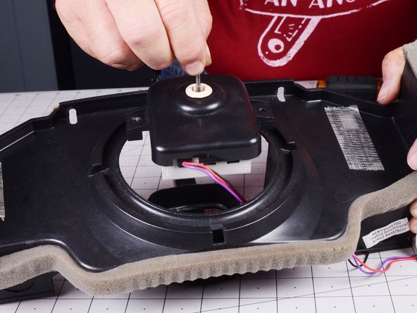

    • Use a Phillips screwdriver to remove the screws securing the evaporator fan motor cover.
    • Remove the evaporator fan motor from the evaporator fan assembly.
    • Your replacement motor may not come with the two rubber motor mounts. Transfer them from the old motor and motor cover.
