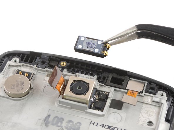

    2. LG G3 Screen Assembly Replacement: crwdns2935265:019crwdnd2935265:01crwdnd2935265:02crwdne2935265:0 LG G3 Screen Assembly Replacement: crwdns2935265:019crwdnd2935265:02crwdnd2935265:02crwdne2935265:0
      • During the removal of the earpiece speaker, remove it together with the foam gasket underneath.
      • Use a pair of tweezers to remove the earpiece speaker.

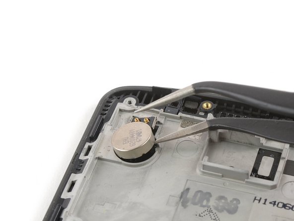

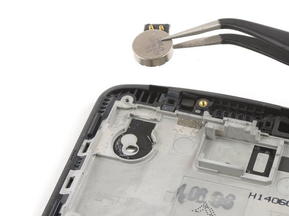

    5. LG G3 Screen Assembly Replacement: crwdns2935265:022crwdnd2935265:01crwdnd2935265:03crwdne2935265:0 LG G3 Screen Assembly Replacement: crwdns2935265:022crwdnd2935265:02crwdnd2935265:03crwdne2935265:0 LG G3 Screen Assembly Replacement: crwdns2935265:022crwdnd2935265:03crwdnd2935265:03crwdne2935265:0
      • Insert one of the tweezer arms under the vibration motor and pry it up.
      • Remove the vibration motor.

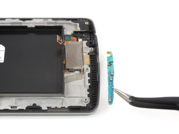

    8. LG G3 Screen Assembly Replacement: crwdns2935265:025crwdnd2935265:01crwdnd2935265:03crwdne2935265:0 LG G3 Screen Assembly Replacement: crwdns2935265:025crwdnd2935265:02crwdnd2935265:03crwdne2935265:0 LG G3 Screen Assembly Replacement: crwdns2935265:025crwdnd2935265:03crwdnd2935265:03crwdne2935265:0
      • Use a pair of tweezers to carefully pry up and remove the daughterboard at the bottom end of the screen assembly.
