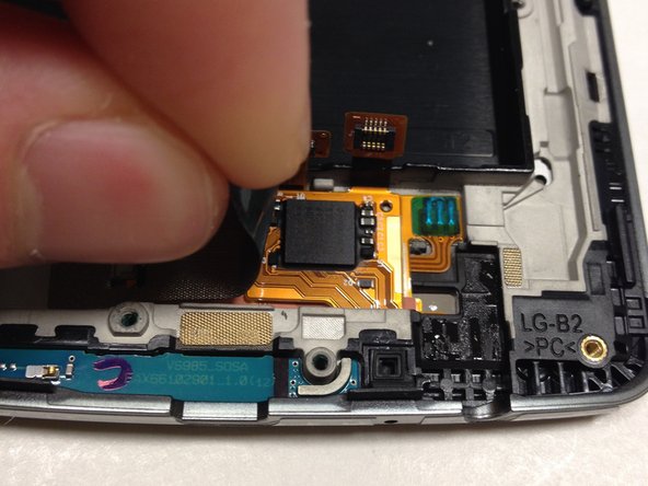

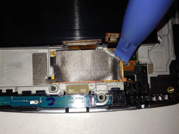

      • Remove the metal tape to reveal the ribbon cables connected to the screen
      • The metal tape is stuck on there pretty well. Get the plastic opening tool under the right-hand side and corners and slowly work your way to getting it off
      • Be careful when removing the metal tape. We can reuse it after we replace the screen
    2. LG G3 LCD and Digitizer Replacement: crwdns2935265:019crwdnd2935265:01crwdnd2935265:02crwdne2935265:0 LG G3 LCD and Digitizer Replacement: crwdns2935265:019crwdnd2935265:02crwdnd2935265:02crwdne2935265:0

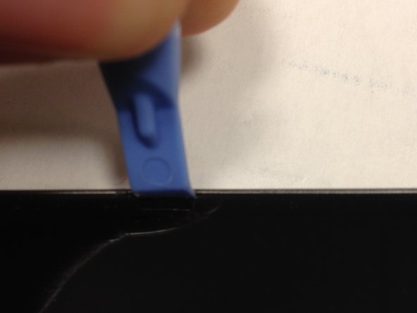

      • If you wish to preserve the LCD screen for whatever reason, it is recommended you use a heat gun around the sides in order to weaken the adhesive that keeps the screen in place
      • Take something thin, such as a knife, and wedge it between the screen and the body of the phone
      • One you have created some space, wedge your plastic opening tool into the space and remove the knife
      • Move your plastic opening tool up and down the side of the phone while lightly pulling up. Repeat this for all sides until the screen comes out
      • If you wish to preserve the LCD screen, be careful how deep you wedge the plastic opening tool in and how hard you pull up to get the screen out. Depending on the depth of the plastic opening tool and strength used, there is a high risk of damaging the LCD screen
