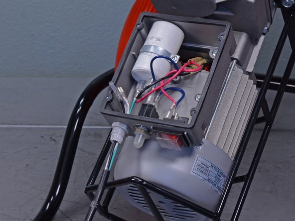

  3. Kushlan Cement Mixer 600DDS 2014 Power Components Replacement, Remove the electrical panel: crwdns2935265:03crwdnd2935265:01crwdnd2935265:01crwdne2935265:0
    • Use a Phillips screwdriver to remove the four screws securing the electrical panel.
  4. Kushlan Cement Mixer 600DDS 2014 Power Components Replacement, Remove the electrical panel: crwdns2935265:04crwdnd2935265:01crwdnd2935265:01crwdne2935265:0
    • Remove the electrical panel.

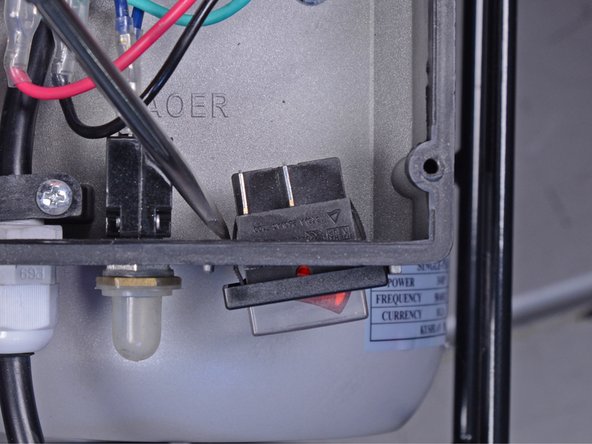

  5. Kushlan Cement Mixer 600DDS 2014 Power Components Replacement, Remove the on/off switch: crwdns2935265:05crwdnd2935265:01crwdnd2935265:03crwdne2935265:0 Kushlan Cement Mixer 600DDS 2014 Power Components Replacement, Remove the on/off switch: crwdns2935265:05crwdnd2935265:02crwdnd2935265:03crwdne2935265:0 Kushlan Cement Mixer 600DDS 2014 Power Components Replacement, Remove the on/off switch: crwdns2935265:05crwdnd2935265:03crwdnd2935265:03crwdne2935265:0
    • Use a pair of needle-nose pliers to disconnect the four wires from the back of the on/off switch.
    • During reassembly, ensure the wires are connected back into their original locations and the on/off switch is not upside-down.

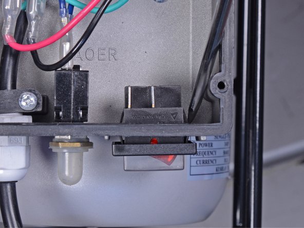

  6. Kushlan Cement Mixer 600DDS 2014 Power Components Replacement: crwdns2935265:06crwdnd2935265:01crwdnd2935265:03crwdne2935265:0 Kushlan Cement Mixer 600DDS 2014 Power Components Replacement: crwdns2935265:06crwdnd2935265:02crwdnd2935265:03crwdne2935265:0 Kushlan Cement Mixer 600DDS 2014 Power Components Replacement: crwdns2935265:06crwdnd2935265:03crwdnd2935265:03crwdne2935265:0
    • Use a flathead screwdriver to press the sides of the on/off switch through the opening in the electrical box.
  7. Kushlan Cement Mixer 600DDS 2014 Power Components Replacement: crwdns2935265:07crwdnd2935265:01crwdnd2935265:01crwdne2935265:0
    • Remove the on/off switch.

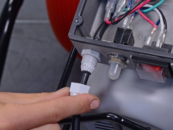

    • Use an adjustable wrench to remove the power cord's strain relief fitting cap.
  12. Kushlan Cement Mixer 600DDS 2014 Power Components Replacement: crwdns2935265:012crwdnd2935265:01crwdnd2935265:02crwdne2935265:0 Kushlan Cement Mixer 600DDS 2014 Power Components Replacement: crwdns2935265:012crwdnd2935265:02crwdnd2935265:02crwdne2935265:0
    • Slide the cap off of the strain relief fitting.
  13. Kushlan Cement Mixer 600DDS 2014 Power Components Replacement: crwdns2935265:013crwdnd2935265:01crwdnd2935265:03crwdne2935265:0 Kushlan Cement Mixer 600DDS 2014 Power Components Replacement: crwdns2935265:013crwdnd2935265:02crwdnd2935265:03crwdne2935265:0 Kushlan Cement Mixer 600DDS 2014 Power Components Replacement: crwdns2935265:013crwdnd2935265:03crwdnd2935265:03crwdne2935265:0
    • Feed the power cord and its black, white, and green wires out through the strain relief fitting.
    • Transfer the strain relief fitting cap onto the new power cord.

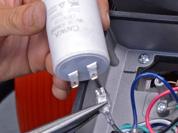

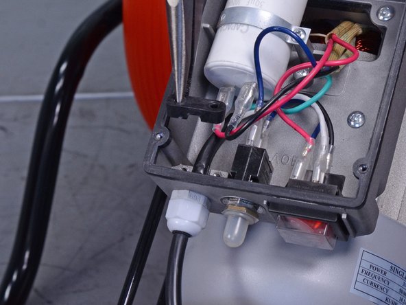

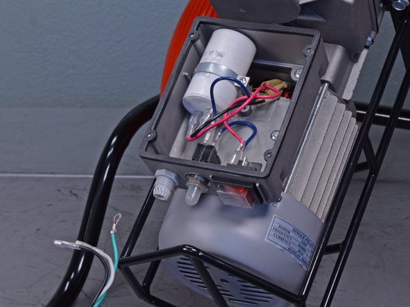

  14. Kushlan Cement Mixer 600DDS 2014 Power Components Replacement, Remove the capacitor: crwdns2935265:014crwdnd2935265:01crwdnd2935265:01crwdne2935265:0
    • Use a Phillips screwdriver to remove the screw securing the capacitor support.
  15. Kushlan Cement Mixer 600DDS 2014 Power Components Replacement: crwdns2935265:015crwdnd2935265:01crwdnd2935265:01crwdne2935265:0
    • Remove the capacitor support.
  16. Kushlan Cement Mixer 600DDS 2014 Power Components Replacement: crwdns2935265:016crwdnd2935265:01crwdnd2935265:03crwdne2935265:0 Kushlan Cement Mixer 600DDS 2014 Power Components Replacement: crwdns2935265:016crwdnd2935265:02crwdnd2935265:03crwdne2935265:0 Kushlan Cement Mixer 600DDS 2014 Power Components Replacement: crwdns2935265:016crwdnd2935265:03crwdnd2935265:03crwdne2935265:0
    • Use a pair of needle nose pliers to disconnect the red and black wires from the capacitor.
    • Remove the capacitor.
    • Use tape or a zip tie to differentiate this set of red and white wires from the other set of red and white wires running to the on/off switch to ensure proper reinstallation.
