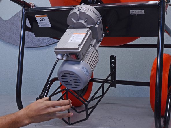

  3. Kushlan Cement Mixer 600DDS 2014 Drivetrain Replacement, Remove the motor cage bolts: crwdns2935265:03crwdnd2935265:01crwdnd2935265:01crwdne2935265:0
    • Use a 13 mm socket to remove the four bolts securing the motor cage to the frame.
  4. Kushlan Cement Mixer 600DDS 2014 Drivetrain Replacement, Remove the motor cage: crwdns2935265:04crwdnd2935265:01crwdnd2935265:02crwdne2935265:0 Kushlan Cement Mixer 600DDS 2014 Drivetrain Replacement, Remove the motor cage: crwdns2935265:04crwdnd2935265:02crwdnd2935265:02crwdne2935265:0
    • Remove the motor cage.

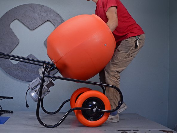

  5. Kushlan Cement Mixer 600DDS 2014 Drivetrain Replacement, Remove the drum: crwdns2935265:05crwdnd2935265:01crwdnd2935265:01crwdne2935265:0
    • Use a 19 mm socket to remove the 70 mm-long bolt securing the drum to the output shaft.
  6. Kushlan Cement Mixer 600DDS 2014 Drivetrain Replacement: crwdns2935265:06crwdnd2935265:01crwdnd2935265:03crwdne2935265:0 Kushlan Cement Mixer 600DDS 2014 Drivetrain Replacement: crwdns2935265:06crwdnd2935265:02crwdnd2935265:03crwdne2935265:0 Kushlan Cement Mixer 600DDS 2014 Drivetrain Replacement: crwdns2935265:06crwdnd2935265:03crwdnd2935265:03crwdne2935265:0
    • Lift the drum straight off of the output shaft and set it aside.
    • Two people may be required depending on the weight of the drum.

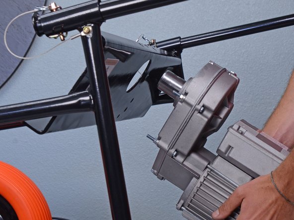

  7. Kushlan Cement Mixer 600DDS 2014 Drivetrain Replacement, Remove the gearbox and motor assembly: crwdns2935265:07crwdnd2935265:01crwdnd2935265:01crwdne2935265:0
    • Have a second person hold the gearbox and motor assembly while you remove the nuts to prevent it from dropping.
    • Use a 10 mm socket to remove the four nuts securing the gearbox to the frame.
  8. Kushlan Cement Mixer 600DDS 2014 Drivetrain Replacement: crwdns2935265:08crwdnd2935265:01crwdnd2935265:02crwdne2935265:0 Kushlan Cement Mixer 600DDS 2014 Drivetrain Replacement: crwdns2935265:08crwdnd2935265:02crwdnd2935265:02crwdne2935265:0
    • Remove the gearbox and motor assembly from the frame.

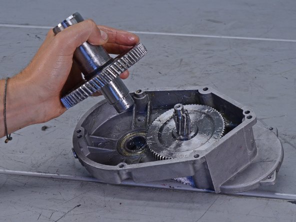

    • Use a pair of pry bars to break the gear and output shaft loose from the gearbox.
    • Once loose, remove the gear and output shaft by hand.

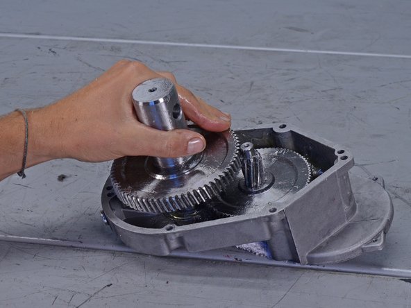

  22. Kushlan Cement Mixer 600DDS 2014 Drivetrain Replacement: crwdns2935265:022crwdnd2935265:01crwdnd2935265:03crwdne2935265:0 Kushlan Cement Mixer 600DDS 2014 Drivetrain Replacement: crwdns2935265:022crwdnd2935265:02crwdnd2935265:03crwdne2935265:0 Kushlan Cement Mixer 600DDS 2014 Drivetrain Replacement: crwdns2935265:022crwdnd2935265:03crwdnd2935265:03crwdne2935265:0
    • Use a pair of pry bars to break the second gear and pinion gear loose from the gearbox case.
    • Once loose, remove the gear and pinion gear by hand.
    • Before reassembly, wipe out as much of the old grease as possible and add plenty of new grease to each new component as you install them.
