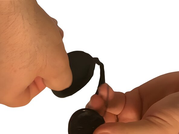

    • Remove the ear clip by gently pulling it away from the headphone.
    • Peel off the ear cushion by gripping the edges and slowly pulling it away from the earpiece.

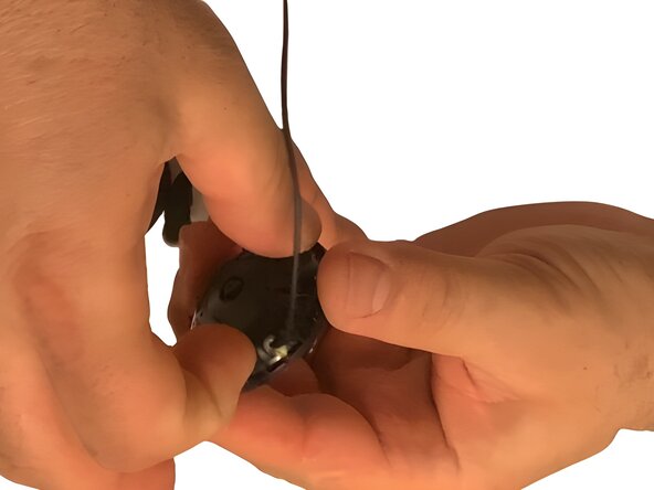

  2. Koss KSC75 Driver Replacement: crwdns2935265:02crwdnd2935265:01crwdnd2935265:03crwdne2935265:0 Koss KSC75 Driver Replacement: crwdns2935265:02crwdnd2935265:02crwdnd2935265:03crwdne2935265:0 Koss KSC75 Driver Replacement: crwdns2935265:02crwdnd2935265:03crwdnd2935265:03crwdne2935265:0
    • Locate the wire plate at the bottom of the earphone where the wire enters the earpiece.
    • Grip the earphone firmly by the sides and use your fingers to gently pry off the plate.
    • Potential for driver damage; do not use excessive force when removing the plate. Hold the earphone by the sides.

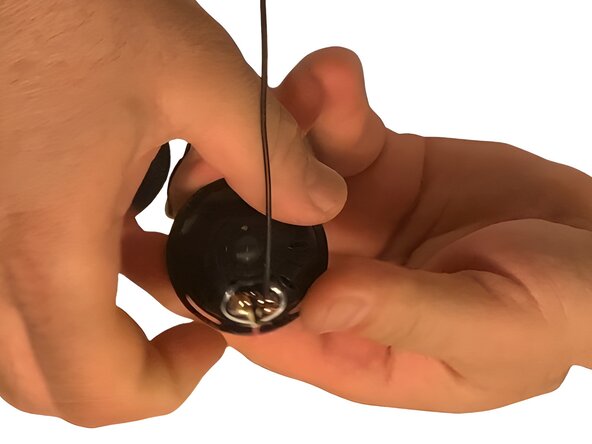

  3. Koss KSC75 Driver Replacement: crwdns2935265:03crwdnd2935265:01crwdnd2935265:01crwdne2935265:0
    • Use a wire cutter to carefully cut the wire close to where it is soldered on the board to detach the wire from the driver.
    • If you are unsure which wire is soldered to the board: Follow the wire from the headphone cable entry point to where it connects inside the earpiece. Look for two or more thin wires attached to small metal dots (solder joints) inside the casing.

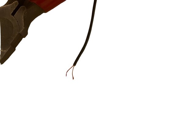

  4. Koss KSC75 Driver Replacement: crwdns2935265:04crwdnd2935265:01crwdnd2935265:01crwdne2935265:0
    • If the wire is frayed, broken, or discolored, use wire cutters to cut at least ½ inch (1–2 cm) beyond the visibly damaged area. Cut straight across the wire to ensure even ends.
    • Cutting too short can make it harder to reconnect the wire to the circuit board. Leave enough slack for soldering.
    • If you are using a razor, put the wire on a flat surface and carefully slice with little pressure to avoid pressing the blade into your finger.

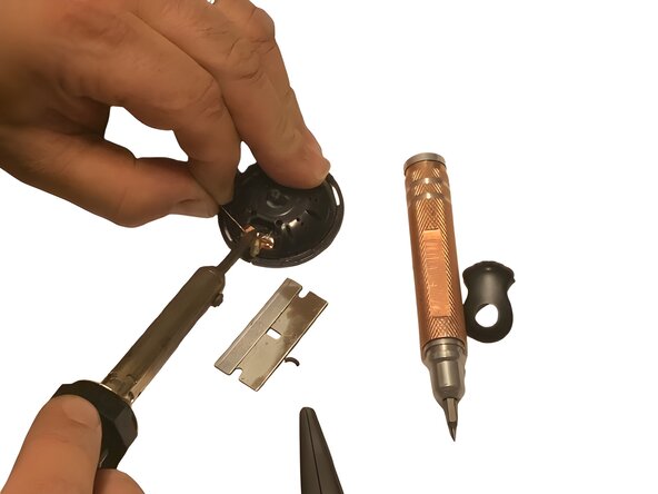

  7. Koss KSC75 Driver Replacement: crwdns2935265:07crwdnd2935265:01crwdnd2935265:03crwdne2935265:0 Koss KSC75 Driver Replacement: crwdns2935265:07crwdnd2935265:02crwdnd2935265:03crwdne2935265:0 Koss KSC75 Driver Replacement: crwdns2935265:07crwdnd2935265:03crwdnd2935265:03crwdne2935265:0
    • Do not overheat the terminals, as too much heat can damage the driver.
    • Identify the soldering terminals inside the earpiece, then secure the wire in place by positioning the exposed end over the correct terminal. There are usually two per side:
    • One for the signal wire (red or green).
    • One for the ground wire (bare copper or gold)
    • With one hand, hold the soldering iron against the wire and terminal for 1–2 seconds to heat the connection.
    • With your other hand, feed solder to the joint so it melts and flows around the wire.
    • Remove the soldering iron and let the solder cool for a few seconds before moving the wire.
    • Repeat for the second wire, ensuring both connections are secure and not touching each other before proceeding.

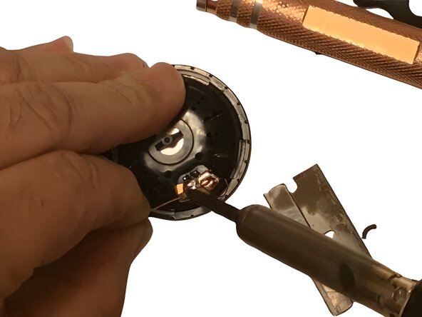

  8. Koss KSC75 Driver Replacement: crwdns2935265:08crwdnd2935265:01crwdnd2935265:01crwdne2935265:0
    • Inspect all soldered connections to make sure the wires are firmly attached and not touching other components.
    • Gently tug the wire to test its strength. If it comes loose, re-solder it.
    • A good solder joint should be smooth and secure. If rough or cracked, reheat and add solder. Lead-free solder may appear dull instead of shiny—this is normal. Focus on a strong connection.
