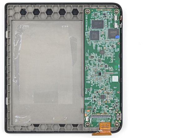

  6. Kobo Libra Colour Screen Replacement, Remove the back cover: crwdns2935265:06crwdnd2935265:01crwdnd2935265:03crwdne2935265:0 Kobo Libra Colour Screen Replacement, Remove the back cover: crwdns2935265:06crwdnd2935265:02crwdnd2935265:03crwdne2935265:0 Kobo Libra Colour Screen Replacement, Remove the back cover: crwdns2935265:06crwdnd2935265:03crwdnd2935265:03crwdne2935265:0
    • At this point, you should be able to grip the back cover and release its remaining clips. If not, slide a pick under the perimeter of the back cover until you can grip an edge.
    • Grip the right edge of the back cover and lift it away from the eReader to release the remaining clips.
    • Remove the back cover.
    • During reassembly, align the back cover over the eReader and press along the perimeter until all its clips snap back into place.

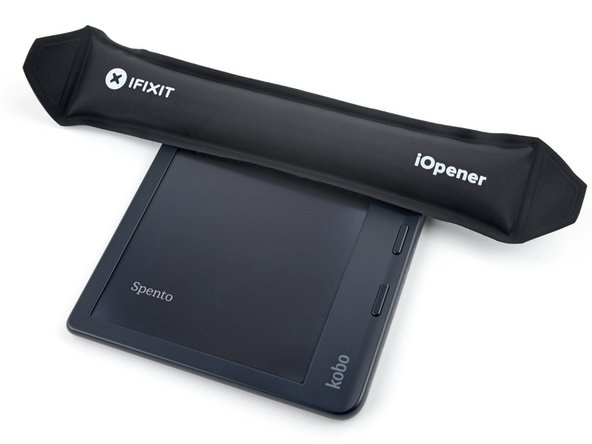

  9. Kobo Libra Colour Screen Replacement, Soften the power button board coating: crwdns2935265:09crwdnd2935265:01crwdnd2935265:02crwdne2935265:0 Kobo Libra Colour Screen Replacement, Soften the power button board coating: crwdns2935265:09crwdnd2935265:02crwdnd2935265:02crwdne2935265:0
    • Heat an iOpener and lay it on the power button board at the top left corner for 90 seconds to soften the coating.
    • Alternatively, you can use a hair dryer or a heat gun for 30 seconds.

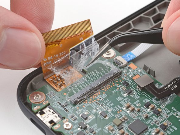

  10. Kobo Libra Colour Screen Replacement, Remove the coating: crwdns2935265:010crwdnd2935265:01crwdnd2935265:03crwdne2935265:0 Kobo Libra Colour Screen Replacement, Remove the coating: crwdns2935265:010crwdnd2935265:02crwdnd2935265:03crwdne2935265:0 Kobo Libra Colour Screen Replacement, Remove the coating: crwdns2935265:010crwdnd2935265:03crwdnd2935265:03crwdne2935265:0
    • Use the tip of a spudger to scrape the coating off the ZIF connector's locking tab—enough so you can grab clumps of it with pointed tweezers.
  11. Kobo Libra Colour Screen Replacement: crwdns2935265:011crwdnd2935265:01crwdnd2935265:03crwdne2935265:0 Kobo Libra Colour Screen Replacement: crwdns2935265:011crwdnd2935265:02crwdnd2935265:03crwdne2935265:0 Kobo Libra Colour Screen Replacement: crwdns2935265:011crwdnd2935265:03crwdnd2935265:03crwdne2935265:0
    • Use pointed tweezers to peel off the coating around the locking tab and its hinge on the ZIF connector.
    • If the coating becomes too brittle and hard to peel off, reheat the power button board and try again.
    • This is a meticulous process! Failure to remove enough of the coating could damage the locking tab during disconnection, so take your time!

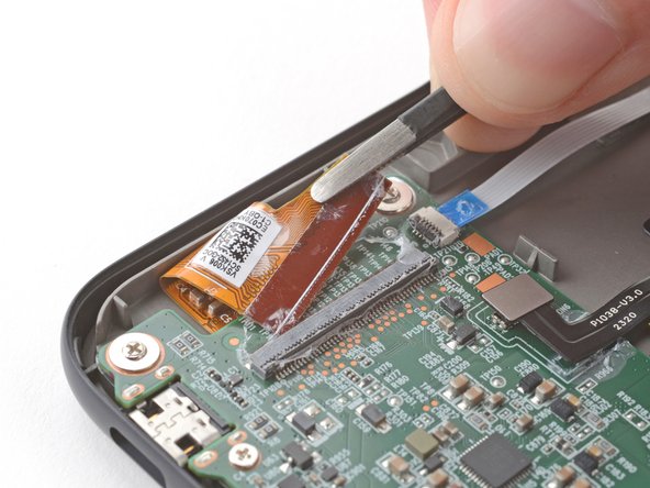

  16. Kobo Libra Colour Screen Replacement, Remove the coating: crwdns2935265:016crwdnd2935265:01crwdnd2935265:03crwdne2935265:0 Kobo Libra Colour Screen Replacement, Remove the coating: crwdns2935265:016crwdnd2935265:02crwdnd2935265:03crwdne2935265:0 Kobo Libra Colour Screen Replacement, Remove the coating: crwdns2935265:016crwdnd2935265:03crwdnd2935265:03crwdne2935265:0
    • Scrape off and remove the coating on the interconnect cable ZIF connector located on the motherboard.
  17. Kobo Libra Colour Screen Replacement, Disconnect the interconnect cable: crwdns2935265:017crwdnd2935265:01crwdnd2935265:03crwdne2935265:0 Kobo Libra Colour Screen Replacement, Disconnect the interconnect cable: crwdns2935265:017crwdnd2935265:02crwdnd2935265:03crwdne2935265:0 Kobo Libra Colour Screen Replacement, Disconnect the interconnect cable: crwdns2935265:017crwdnd2935265:03crwdnd2935265:03crwdne2935265:0
    • Use the tip of a spudger to lift up the locking tab on the ZIF connector.
    • Use tweezers, or your fingers, to grip the blue pull tab on the interconnect cable and disconnect it.

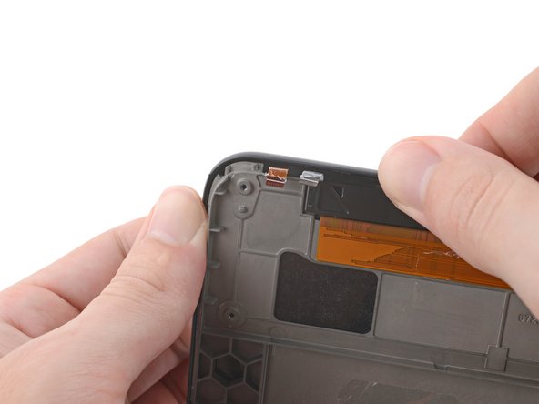

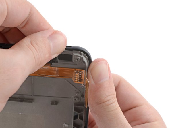

  18. Kobo Libra Colour Screen Replacement, Soften the interconnect cable adhesive: crwdns2935265:018crwdnd2935265:01crwdnd2935265:03crwdne2935265:0 Kobo Libra Colour Screen Replacement, Soften the interconnect cable adhesive: crwdns2935265:018crwdnd2935265:02crwdnd2935265:03crwdne2935265:0 Kobo Libra Colour Screen Replacement, Soften the interconnect cable adhesive: crwdns2935265:018crwdnd2935265:03crwdnd2935265:03crwdne2935265:0
    • Apply a heated iOpener to the top edge of the eReader for 90 seconds to soften the adhesive under the interconnect cable.
  19. Kobo Libra Colour Screen Replacement, Remove the interconnect cable: crwdns2935265:019crwdnd2935265:01crwdnd2935265:03crwdne2935265:0 Kobo Libra Colour Screen Replacement, Remove the interconnect cable: crwdns2935265:019crwdnd2935265:02crwdnd2935265:03crwdne2935265:0 Kobo Libra Colour Screen Replacement, Remove the interconnect cable: crwdns2935265:019crwdnd2935265:03crwdnd2935265:03crwdne2935265:0
    • Hold one end of the interconnect cable and use your other hand to insert the tip of an opening pick underneath it.
    • Peel the cable away from the frame while sliding the pick in the same direction to separate the adhesive.
    • Work slowly to avoid creasing or folding cable, and reheat when necessary.
    • Remove the interconnect cable.

  34. Kobo Libra Colour Screen Replacement, Disconnect the digitizer cables: crwdns2935265:034crwdnd2935265:01crwdnd2935265:03crwdne2935265:0 Kobo Libra Colour Screen Replacement, Disconnect the digitizer cables: crwdns2935265:034crwdnd2935265:02crwdnd2935265:03crwdne2935265:0 Kobo Libra Colour Screen Replacement, Disconnect the digitizer cables: crwdns2935265:034crwdnd2935265:03crwdnd2935265:03crwdne2935265:0
    • Use the point of a spudger to lift up the locking tabs on the ZIF connectors.
    • The locking tabs should be nearly vertical when unlocked. If not, remove more coating until the tabs can move freely.

  36. Kobo Libra Colour Screen Replacement: crwdns2935265:036crwdnd2935265:01crwdnd2935265:03crwdne2935265:0 Kobo Libra Colour Screen Replacement: crwdns2935265:036crwdnd2935265:02crwdnd2935265:03crwdne2935265:0 Kobo Libra Colour Screen Replacement: crwdns2935265:036crwdnd2935265:03crwdnd2935265:03crwdne2935265:0
    • Slide one arm of a pair of pointed tweezers underneath the cables to separate the coating securing them to the motherboard.
    • You only need to separate enough coating so you can grip the cables with blunt nose tweezers.
  37. Kobo Libra Colour Screen Replacement: crwdns2935265:037crwdnd2935265:01crwdnd2935265:03crwdne2935265:0 Kobo Libra Colour Screen Replacement: crwdns2935265:037crwdnd2935265:02crwdnd2935265:03crwdne2935265:0 Kobo Libra Colour Screen Replacement: crwdns2935265:037crwdnd2935265:03crwdnd2935265:03crwdne2935265:0
    • Because of the awkward angle, this step requires some patience to avoid tearing the cables. Work slowly and apply heat regularly.
    • Use blunt nose tweezers to pull the cables away from their ZIF connectors slowly and steadily at a level angle to separate the coating.
    • Gripping the tweezers closer to the tip can help get a tighter hold on the cables.
    • Keep pulling on the cables until they're completely disconnected.

  38. Kobo Libra Colour Screen Replacement, Soften the display cable coating: crwdns2935265:038crwdnd2935265:01crwdnd2935265:02crwdne2935265:0 Kobo Libra Colour Screen Replacement, Soften the display cable coating: crwdns2935265:038crwdnd2935265:02crwdnd2935265:02crwdne2935265:0
    • Apply a heated iOpener to the display cable ZIF connector for 90 seconds to soften the coating.
  39. Kobo Libra Colour Screen Replacement, Remove the coating: crwdns2935265:039crwdnd2935265:01crwdnd2935265:03crwdne2935265:0 Kobo Libra Colour Screen Replacement, Remove the coating: crwdns2935265:039crwdnd2935265:02crwdnd2935265:03crwdne2935265:0 Kobo Libra Colour Screen Replacement, Remove the coating: crwdns2935265:039crwdnd2935265:03crwdnd2935265:03crwdne2935265:0
    • The display cable ZIF connector is larger and requires a different procedure to disconnect properly.
    • Use the tip of a spudger to scrape the coating along the ZIF connector's black locking tab—enough so you can grab clumps of it with pointed tweezers.
  40. Kobo Libra Colour Screen Replacement: crwdns2935265:040crwdnd2935265:01crwdnd2935265:03crwdne2935265:0 Kobo Libra Colour Screen Replacement: crwdns2935265:040crwdnd2935265:02crwdnd2935265:03crwdne2935265:0 Kobo Libra Colour Screen Replacement: crwdns2935265:040crwdnd2935265:03crwdnd2935265:03crwdne2935265:0
    • If the coating becomes too brittle and hard to peel off, reheat the connector and try again.

  45. Kobo Libra Colour Screen Replacement, Remove the motherboard screws: crwdns2935265:045crwdnd2935265:01crwdnd2935265:02crwdne2935265:0 Kobo Libra Colour Screen Replacement, Remove the motherboard screws: crwdns2935265:045crwdnd2935265:02crwdnd2935265:02crwdne2935265:0
    • Use a Phillips screwdriver to remove the seven screws securing the motherboard:
    • Four 2.4 mm‑long screws
    • Three 3.9 mm‑long screws
  46. Kobo Libra Colour Screen Replacement, Remove the motherboard: crwdns2935265:046crwdnd2935265:01crwdnd2935265:03crwdne2935265:0 Kobo Libra Colour Screen Replacement, Remove the motherboard: crwdns2935265:046crwdnd2935265:02crwdnd2935265:03crwdne2935265:0 Kobo Libra Colour Screen Replacement, Remove the motherboard: crwdns2935265:046crwdnd2935265:03crwdnd2935265:03crwdne2935265:0
    • Use a spudger to pry up the motherboard enough so you can grip it with your fingers.
    • Pull the motherboard toward the opposite side of the eReader to slide it out of its two clips.
    • Remove the motherboard.

    • Push the top left corner of the front cover while pulling the screen in the opposite direction to release the clips and separate the adhesive.
    • You'll hear and feel the adhesive slowly separate as you push on the front cover.
    • If you're having trouble, reheat the top edge for one minute before trying again.
  51. Kobo Libra Colour Screen Replacement: crwdns2935265:051crwdnd2935265:01crwdnd2935265:03crwdne2935265:0 Kobo Libra Colour Screen Replacement: crwdns2935265:051crwdnd2935265:02crwdnd2935265:03crwdne2935265:0 Kobo Libra Colour Screen Replacement: crwdns2935265:051crwdnd2935265:03crwdnd2935265:03crwdne2935265:0
    • While keeping the corner of the front cover separated with one hand, use your other hand to peel the left edge of the front cover off the frame.
  52. Kobo Libra Colour Screen Replacement: crwdns2935265:052crwdnd2935265:01crwdnd2935265:03crwdne2935265:0 Kobo Libra Colour Screen Replacement: crwdns2935265:052crwdnd2935265:02crwdnd2935265:03crwdne2935265:0 Kobo Libra Colour Screen Replacement: crwdns2935265:052crwdnd2935265:03crwdnd2935265:03crwdne2935265:0
    • Continue working around the perimeter of the front cover until all of the clips release and the adhesive is completely separated.

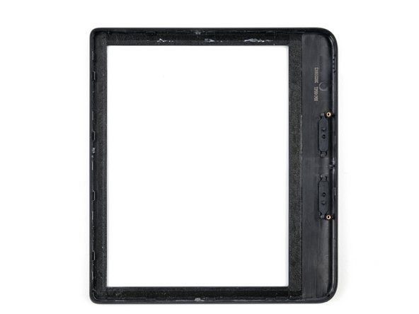

  53. Kobo Libra Colour Screen Replacement, Remove the front cover: crwdns2935265:053crwdnd2935265:01crwdnd2935265:03crwdne2935265:0 Kobo Libra Colour Screen Replacement, Remove the front cover: crwdns2935265:053crwdnd2935265:02crwdnd2935265:03crwdne2935265:0 Kobo Libra Colour Screen Replacement, Remove the front cover: crwdns2935265:053crwdnd2935265:03crwdnd2935265:03crwdne2935265:0
    Tesa 61395 Tape
    $2.99
    • Lift the front cover off the frame and remove it.
    • During reassembly, align the front cover over the frame and press down around the perimeter until the clips snap back into place.
    • If the adhesive isn't sticky anymore, you can use a thin double-sided tape like Tesa tape to replace it.
