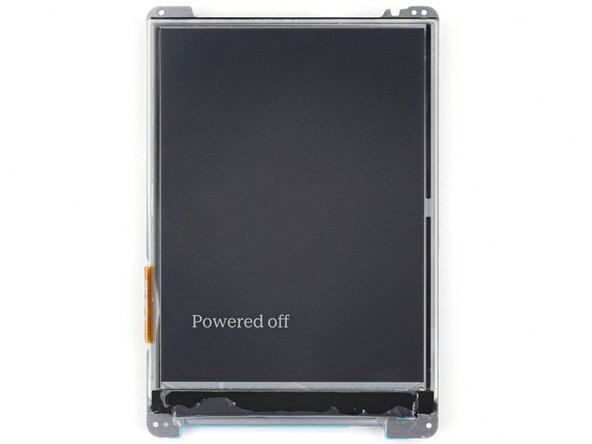

    • Drain your eReader's battery as much as possible before starting your repair. Ideally, it should be fully discharged.
    • Optionally, to drain the battery faster, navigate to MoreSettingsEnergy saving and privacy and set Automatically go to sleep after and Automatically power off after to Never.
    • When working on or near the battery, don't use sharp metal tools to avoid puncturing and shorting the battery.
    • Unplug all cables and fully shut down your eReader.
    • Your screen should be black and say Powered off.

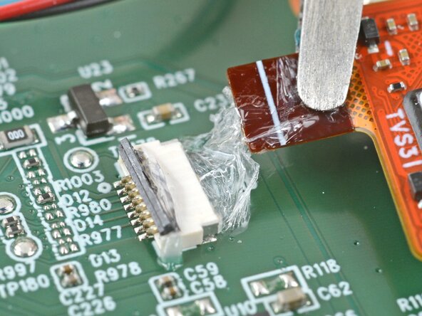

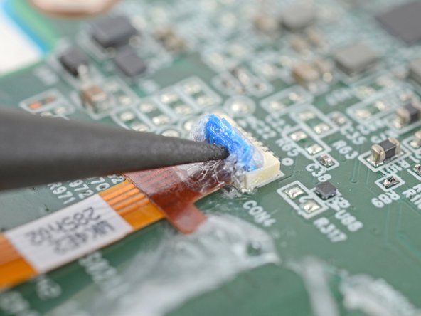

  7. Kobo Clara BW (P365) Screen Replacement, Coating information: crwdns2935265:07crwdnd2935265:01crwdnd2935265:03crwdne2935265:0 Kobo Clara BW (P365) Screen Replacement, Coating information: crwdns2935265:07crwdnd2935265:02crwdnd2935265:03crwdne2935265:0 Kobo Clara BW (P365) Screen Replacement, Coating information: crwdns2935265:07crwdnd2935265:03crwdnd2935265:03crwdne2935265:0
    • Nearly the entire surface of the eReader's internals is covered in a thin, plastic-like waterproof coating. Keep the following in mind as you continue disassembly:
    • While this won't hurt your device, removing the coating compromises the device to potential water damage.
    • The coating is brittle and can flake into many small pieces. Heating the coating helps, but working with it is still a time-consuming process.
    • The ZIF connector locking tabs are coated in a gel that can jam the hinge and keep the locking tab from completely unlocking. Make sure the tabs are completely upright before disconnecting any cables.
    • Depending on your repair, you might have to remove the coating completely from the connectors and their cables.
    • If at any point the coating becomes too difficult to work with, heat it for 90 seconds with an iOpener or a hair dryer.

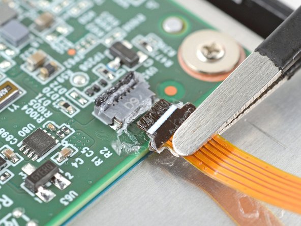

  12. Kobo Clara BW (P365) Screen Replacement, Disconnect the power button ZIF connector: crwdns2935265:012crwdnd2935265:01crwdnd2935265:03crwdne2935265:0 Kobo Clara BW (P365) Screen Replacement, Disconnect the power button ZIF connector: crwdns2935265:012crwdnd2935265:02crwdnd2935265:03crwdne2935265:0 Kobo Clara BW (P365) Screen Replacement, Disconnect the power button ZIF connector: crwdns2935265:012crwdnd2935265:03crwdnd2935265:03crwdne2935265:0
    • Use the point of a spudger to lift up the locking tab on the power button cable ZIF connector.
    • The locking tab should be nearly vertical when unlocked. If it isn't, gently push the tab forward to compress the waterproofing gel and unlock the tab.
    • Use a pair of blunt nose tweezers to grip the cable close to the head and pull it away from its ZIF connector slowly and steadily to separate the coating.
    • During reassembly:
    • Inspect the head of the cable and the ZIF connector for any remaining coating that could prevent a good connection.
    • Peel off the coating—heating the cable and the ZIF connector when the coating becomes too brittle.
    • It doesn't have to look pretty! You just need to remove enough coating to have the cable sit properly in its connector.

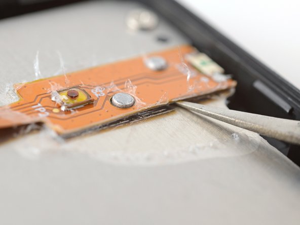

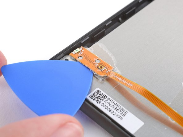

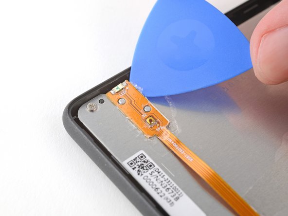

  13. Kobo Clara BW (P365) Screen Replacement, Separate the power button adhesive: crwdns2935265:013crwdnd2935265:01crwdnd2935265:03crwdne2935265:0 Kobo Clara BW (P365) Screen Replacement, Separate the power button adhesive: crwdns2935265:013crwdnd2935265:02crwdnd2935265:03crwdne2935265:0 Kobo Clara BW (P365) Screen Replacement, Separate the power button adhesive: crwdns2935265:013crwdnd2935265:03crwdnd2935265:03crwdne2935265:0
    • Insert an arm of a pair of sharp tweezers under the edge of the power button board.
    • Slide the arm along the edge of the board to separate enough adhesive to fit an opening pick under the board.

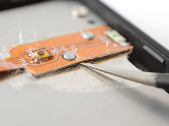

  14. Kobo Clara BW (P365) Screen Replacement: crwdns2935265:014crwdnd2935265:01crwdnd2935265:03crwdne2935265:0 Kobo Clara BW (P365) Screen Replacement: crwdns2935265:014crwdnd2935265:02crwdnd2935265:03crwdne2935265:0 Kobo Clara BW (P365) Screen Replacement: crwdns2935265:014crwdnd2935265:03crwdnd2935265:03crwdne2935265:0
    • Insert the tip of an opening pick underneath the power button board.
    • Slide the pick along the edge of the power button board to separate the adhesive.
    • Gently twist the pick to separate the adhesive on both sides.

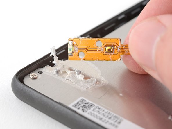

  15. Kobo Clara BW (P365) Screen Replacement, Remove the power button board: crwdns2935265:015crwdnd2935265:01crwdnd2935265:02crwdne2935265:0 Kobo Clara BW (P365) Screen Replacement, Remove the power button board: crwdns2935265:015crwdnd2935265:02crwdnd2935265:02crwdne2935265:0
    • Peel the power button board up and off of the frame to remove it.
    • During reassembly, follow this guide to transfer your power button board to a new screen or to install a new one.

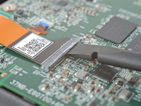

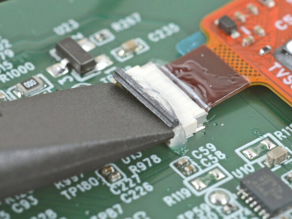

  16. Kobo Clara BW (P365) Screen Replacement, Disconnect the digitizer cable: crwdns2935265:016crwdnd2935265:01crwdnd2935265:03crwdne2935265:0 Kobo Clara BW (P365) Screen Replacement, Disconnect the digitizer cable: crwdns2935265:016crwdnd2935265:02crwdnd2935265:03crwdne2935265:0 Kobo Clara BW (P365) Screen Replacement, Disconnect the digitizer cable: crwdns2935265:016crwdnd2935265:03crwdnd2935265:03crwdne2935265:0
    • Various small, fragile surface-mounted components surround the motherboard ZIF connectors. Avoid prying against them.
    • Use the flat end of a spudger to lift up the locking tab on the digitizer cable ZIF connector.

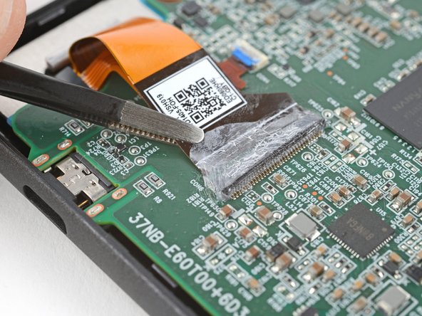

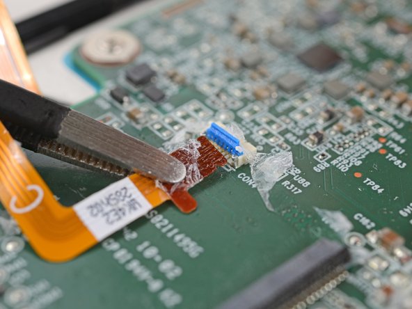

  17. Kobo Clara BW (P365) Screen Replacement, Disconnect the display connector: crwdns2935265:017crwdnd2935265:01crwdnd2935265:03crwdne2935265:0 Kobo Clara BW (P365) Screen Replacement, Disconnect the display connector: crwdns2935265:017crwdnd2935265:02crwdnd2935265:03crwdne2935265:0 Kobo Clara BW (P365) Screen Replacement, Disconnect the display connector: crwdns2935265:017crwdnd2935265:03crwdnd2935265:03crwdne2935265:0
    • Use the flat end of a spudger to lift up the locking tab on the display cable ZIF connector.
    • If the coating feels stubborn, you may need to lightly heat it with an iOpener or a hair dryer.

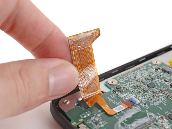

  18. Kobo Clara BW (P365) Screen Replacement: crwdns2935265:018crwdnd2935265:01crwdnd2935265:02crwdne2935265:0 Kobo Clara BW (P365) Screen Replacement: crwdns2935265:018crwdnd2935265:02crwdnd2935265:02crwdne2935265:0
    • Pull the display cable away from its ZIF connector slowly and steadily at a level angle to separate the coating at the corners.
    • If you're having trouble, try rocking the cable side-to-side while pulling.
    • Once the cable comes completely out of its socket, lift it up and peel off any remaining coating holding it to the motherboard.
    • Lift the display cable out of the way of the backlight cable underneath.

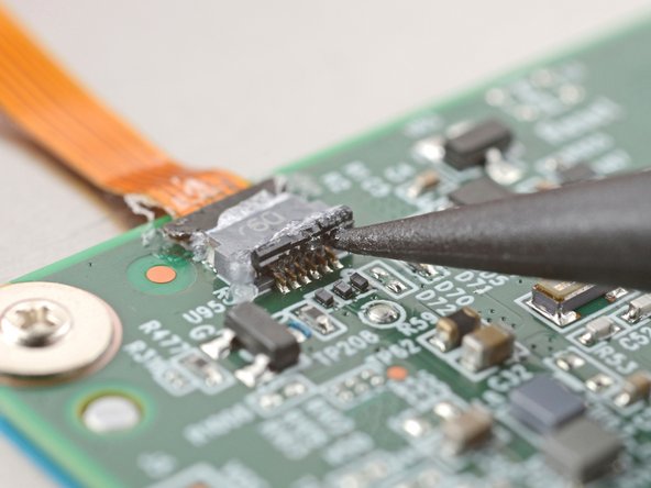

  19. Kobo Clara BW (P365) Screen Replacement, Disconnect the backlight cable: crwdns2935265:019crwdnd2935265:01crwdnd2935265:03crwdne2935265:0 Kobo Clara BW (P365) Screen Replacement, Disconnect the backlight cable: crwdns2935265:019crwdnd2935265:02crwdnd2935265:03crwdne2935265:0 Kobo Clara BW (P365) Screen Replacement, Disconnect the backlight cable: crwdns2935265:019crwdnd2935265:03crwdnd2935265:03crwdne2935265:0
    • Use the point of a spudger to lift up the locking tab on the backlight cable ZIF connector.

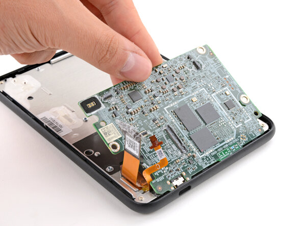

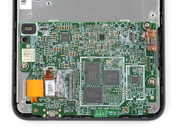

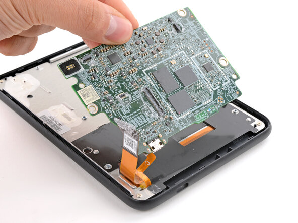

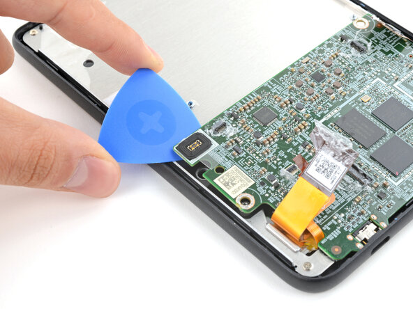

  20. Kobo Clara BW (P365) Screen Replacement, Unscrew the motherboard: crwdns2935265:020crwdnd2935265:01crwdnd2935265:02crwdne2935265:0 Kobo Clara BW (P365) Screen Replacement, Unscrew the motherboard: crwdns2935265:020crwdnd2935265:02crwdnd2935265:02crwdne2935265:0
    • Use a Phillips screwdriver to remove the three 2.4 mm‑long screws securing the motherboard.
  21. Kobo Clara BW (P365) Screen Replacement, Remove the motherboard: crwdns2935265:021crwdnd2935265:01crwdnd2935265:02crwdne2935265:0 Kobo Clara BW (P365) Screen Replacement, Remove the motherboard: crwdns2935265:021crwdnd2935265:02crwdnd2935265:02crwdne2935265:0
    • Slide an opening pick under the top left corner of the motherboard and lift it up enough to grip it with your fingers.
  22. Kobo Clara BW (P365) Screen Replacement: crwdns2935265:022crwdnd2935265:01crwdnd2935265:03crwdne2935265:0 Kobo Clara BW (P365) Screen Replacement: crwdns2935265:022crwdnd2935265:02crwdnd2935265:03crwdne2935265:0 Kobo Clara BW (P365) Screen Replacement: crwdns2935265:022crwdnd2935265:03crwdnd2935265:03crwdne2935265:0
    • Lift the top edge of the motherboard and pull it toward the top of the eReader to remove it.
    • Slide the charging port into its slot at a slight downward angle before pressing the motherboard flat to the frame.
    • Follow this guide to update the VCOM number on your eReader to match your screen.

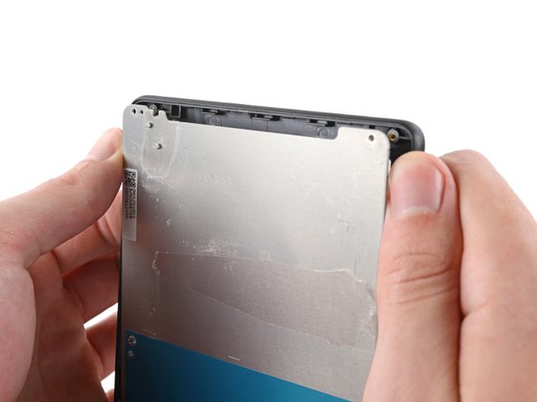

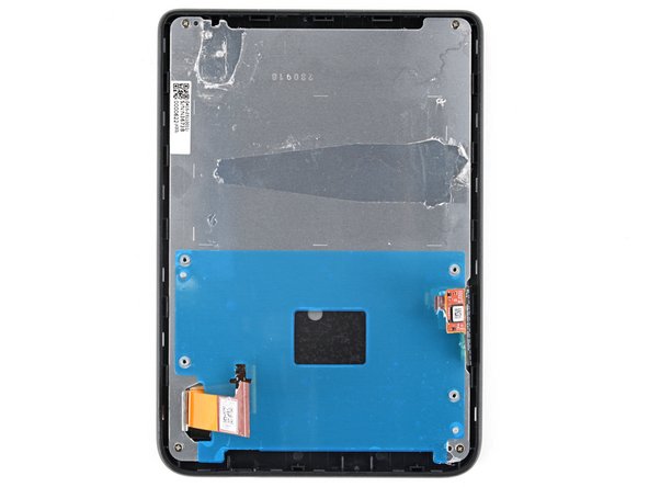

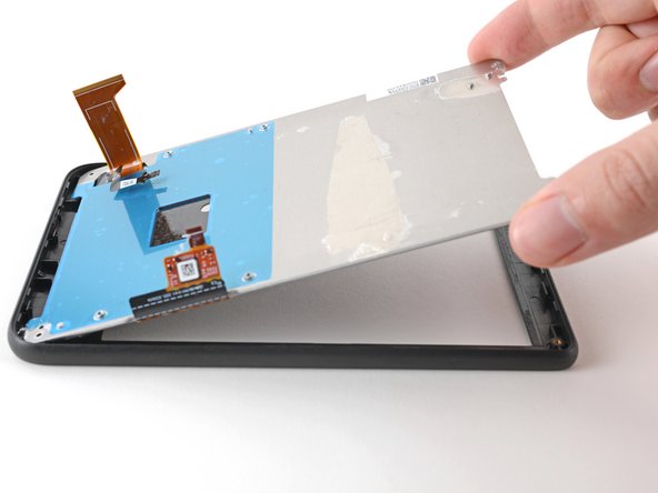

  23. Kobo Clara BW (P365) Screen Replacement, Remove the front cover screws: crwdns2935265:023crwdnd2935265:01crwdnd2935265:02crwdne2935265:0 Kobo Clara BW (P365) Screen Replacement, Remove the front cover screws: crwdns2935265:023crwdnd2935265:02crwdnd2935265:02crwdne2935265:0
    • Use a Phillips screwdriver to remove the four 3 mm‑long screws securing corners of the front cover.

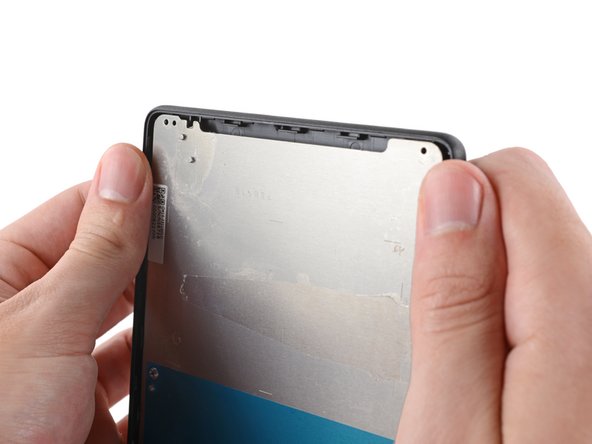

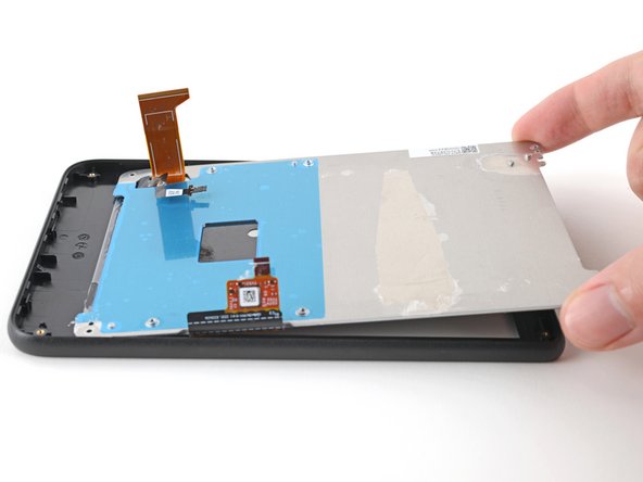

  24. Kobo Clara BW (P365) Screen Replacement, Separate the adhesive: crwdns2935265:024crwdnd2935265:01crwdnd2935265:03crwdne2935265:0 Kobo Clara BW (P365) Screen Replacement, Separate the adhesive: crwdns2935265:024crwdnd2935265:02crwdnd2935265:03crwdne2935265:0 Kobo Clara BW (P365) Screen Replacement, Separate the adhesive: crwdns2935265:024crwdnd2935265:03crwdnd2935265:03crwdne2935265:0
    • The screen is secured by adhesive along the perimeter of the front cover and a layer of coating at the bottom edge.
    • Bend the top edge of the front cover around the screen to separate the adhesive.
  25. Kobo Clara BW (P365) Screen Replacement: crwdns2935265:025crwdnd2935265:01crwdnd2935265:03crwdne2935265:0 Kobo Clara BW (P365) Screen Replacement: crwdns2935265:025crwdnd2935265:02crwdnd2935265:03crwdne2935265:0 Kobo Clara BW (P365) Screen Replacement: crwdns2935265:025crwdnd2935265:03crwdnd2935265:03crwdne2935265:0
    • Lift the top edge of the screen to separate any remaining adhesive around the perimeter of the front cover.
    • Slide the screen toward the top of the eReader to expose the coating at the bottom edge.

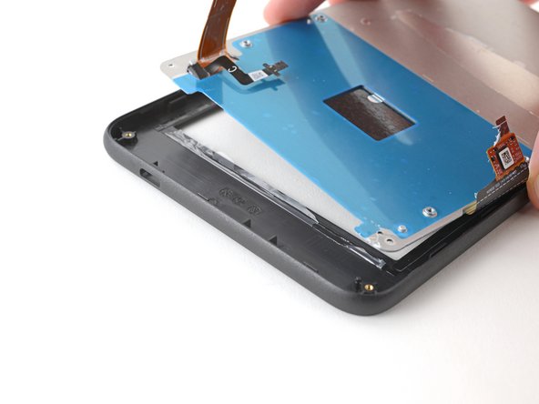

  26. Kobo Clara BW (P365) Screen Replacement, Remove the screen: crwdns2935265:026crwdnd2935265:01crwdnd2935265:03crwdne2935265:0 Kobo Clara BW (P365) Screen Replacement, Remove the screen: crwdns2935265:026crwdnd2935265:02crwdnd2935265:03crwdne2935265:0 Kobo Clara BW (P365) Screen Replacement, Remove the screen: crwdns2935265:026crwdnd2935265:03crwdnd2935265:03crwdne2935265:0
    • Lift and rotate the screen off the bottom edge of the front cover to separate the coating.
    • Remove the screen.
    • You've now disassembled your eReader enough to transfer the internals to your new screen.
    • Align the front cover over the screen and press down around the perimeter until the clips snap back into place.
    • Follow this guide to update the VCOM number on your eReader to match the replacement screen.
