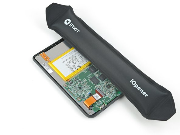

  7. Kobo Clara BW (P365) Motherboard Replacement, Coating information: crwdns2935265:07crwdnd2935265:01crwdnd2935265:03crwdne2935265:0 Kobo Clara BW (P365) Motherboard Replacement, Coating information: crwdns2935265:07crwdnd2935265:02crwdnd2935265:03crwdne2935265:0 Kobo Clara BW (P365) Motherboard Replacement, Coating information: crwdns2935265:07crwdnd2935265:03crwdnd2935265:03crwdne2935265:0
    • Nearly the entire surface of the eReader's internals is covered in a thin, plastic-like waterproof coating. Keep the following in mind as you continue disassembly:
    • While this won't hurt your device, removing the coating compromises the device to potential water damage.
    • The coating is brittle and can flake into many small pieces. Heating the coating helps, but working with it is still a time-consuming process.
    • The ZIF connector locking tabs are coated in a gel that can jam the hinge and keep the locking tab from completely unlocking. Make sure the tabs are completely upright before disconnecting any cables.
    • Depending on your repair, you might have to remove the coating completely from the connectors and their cables.
    • If at any point the coating becomes too difficult to work with, heat it for 90 seconds with an iOpener or a hair dryer.

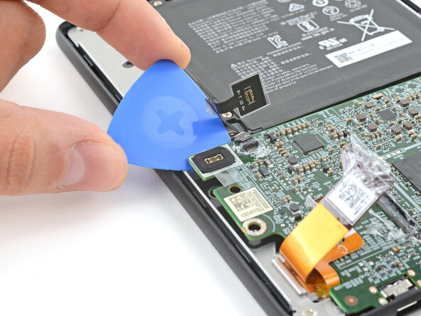

  8. Kobo Clara BW (P365) Motherboard Replacement, Disconnect the battery: crwdns2935265:08crwdnd2935265:01crwdnd2935265:02crwdne2935265:0 Kobo Clara BW (P365) Motherboard Replacement, Disconnect the battery: crwdns2935265:08crwdnd2935265:02crwdnd2935265:02crwdne2935265:0
    • Use a clean fingernail or the flat end of a spudger to pry up and disconnect the battery press connector.
    • Don't pull on what looks like a clear connector pull tab. The tab is secured to the socket gasket.

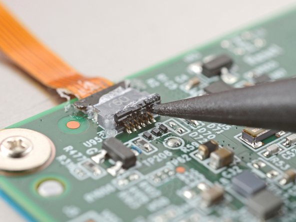

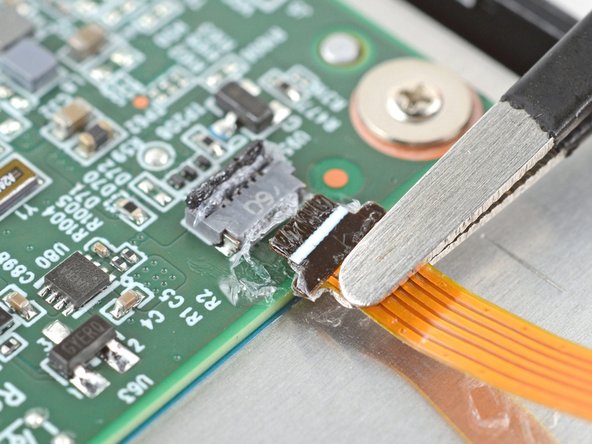

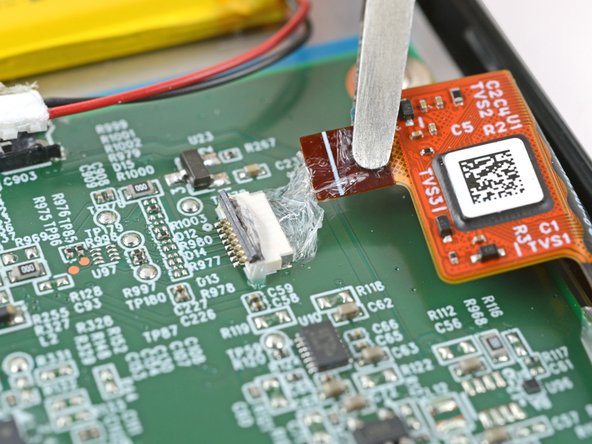

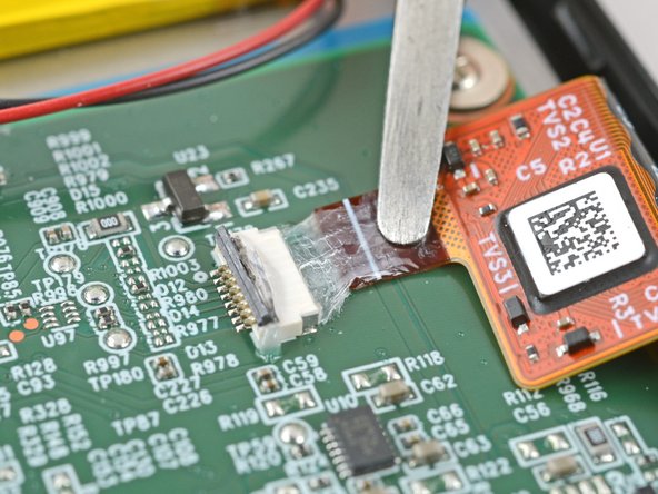

  9. Kobo Clara BW (P365) Motherboard Replacement, Disconnect the power button ZIF connector: crwdns2935265:09crwdnd2935265:01crwdnd2935265:03crwdne2935265:0 Kobo Clara BW (P365) Motherboard Replacement, Disconnect the power button ZIF connector: crwdns2935265:09crwdnd2935265:02crwdnd2935265:03crwdne2935265:0 Kobo Clara BW (P365) Motherboard Replacement, Disconnect the power button ZIF connector: crwdns2935265:09crwdnd2935265:03crwdnd2935265:03crwdne2935265:0
    • Various small, fragile surface-mounted components surround the motherboard ZIF connectors. Avoid prying against them.
    • Use the point of a spudger to lift up the locking tab on the power button cable ZIF connector.
    • The locking tab should be nearly vertical when unlocked. If it isn't, gently push the tab forward to compress the waterproofing gel and unlock the tab.
    • Use a pair of blunt nose tweezers to grip the cable close to the head and pull it away from its ZIF connector slowly and steadily to separate the coating.
    • During reassembly:
    • Inspect the head of the cable and the ZIF connector for any remaining coating that could prevent a good connection.
    • Peel off the coating—heating the cable and the ZIF connector when the coating becomes too brittle.
    • It doesn't have to look pretty! You just need to remove enough coating to have the cable sit properly in its connector.

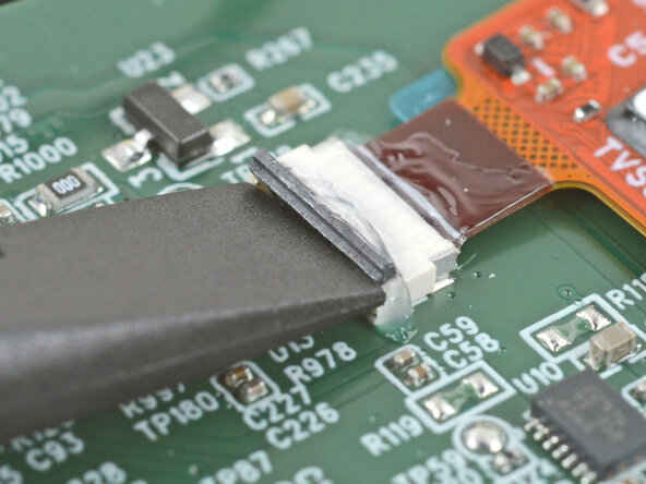

  10. Kobo Clara BW (P365) Motherboard Replacement, Disconnect the digitizer cable: crwdns2935265:010crwdnd2935265:01crwdnd2935265:03crwdne2935265:0 Kobo Clara BW (P365) Motherboard Replacement, Disconnect the digitizer cable: crwdns2935265:010crwdnd2935265:02crwdnd2935265:03crwdne2935265:0 Kobo Clara BW (P365) Motherboard Replacement, Disconnect the digitizer cable: crwdns2935265:010crwdnd2935265:03crwdnd2935265:03crwdne2935265:0
    • Use the flat end of a spudger to lift up the locking tab on the digitizer cable ZIF connector.
    • If the coating feels stubborn, you may need to lightly heat it with an iOpener or a hair dryer.

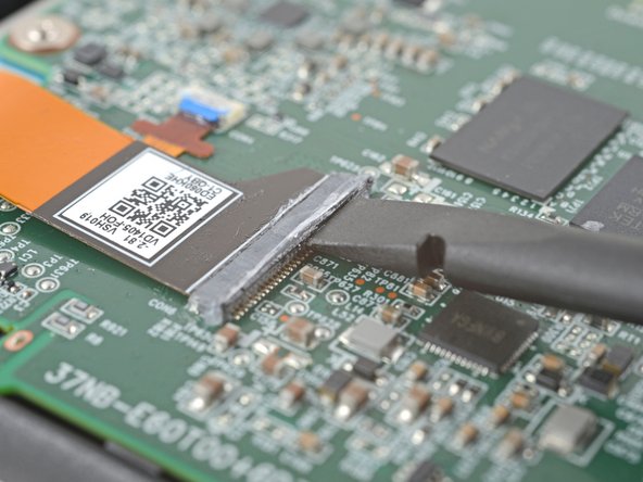

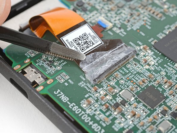

  11. Kobo Clara BW (P365) Motherboard Replacement, Disconnect the display connector: crwdns2935265:011crwdnd2935265:01crwdnd2935265:03crwdne2935265:0 Kobo Clara BW (P365) Motherboard Replacement, Disconnect the display connector: crwdns2935265:011crwdnd2935265:02crwdnd2935265:03crwdne2935265:0 Kobo Clara BW (P365) Motherboard Replacement, Disconnect the display connector: crwdns2935265:011crwdnd2935265:03crwdnd2935265:03crwdne2935265:0
    • Use the flat end of a spudger to lift up the locking tab on the display cable ZIF connector.

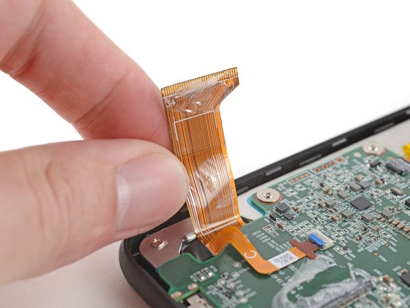

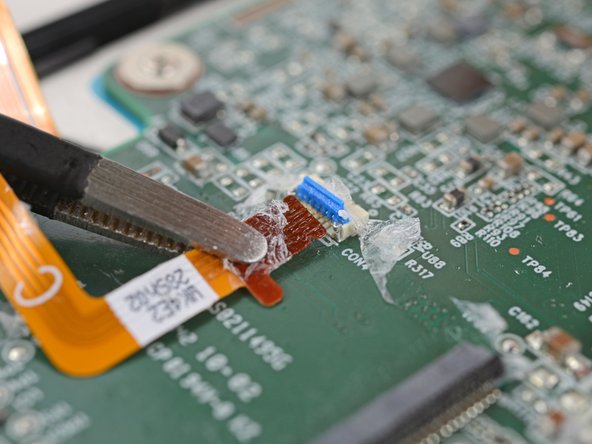

  12. Kobo Clara BW (P365) Motherboard Replacement, Clean and move the display connector: crwdns2935265:012crwdnd2935265:01crwdnd2935265:02crwdne2935265:0 Kobo Clara BW (P365) Motherboard Replacement, Clean and move the display connector: crwdns2935265:012crwdnd2935265:02crwdnd2935265:02crwdne2935265:0
    • Pull the display cable away from its ZIF connector slowly and steadily at a level angle to separate the coating at the corners.
    • If you're having trouble, try rocking the cable side-to-side while pulling.
    • Once the cable comes completely out of its socket, lift it up and peel off any remaining coating holding it to the motherboard.
    • Lift the display cable out of the way of the backlight cable underneath.

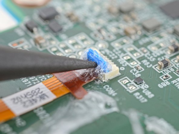

  13. Kobo Clara BW (P365) Motherboard Replacement, Disconnect the backlight cable: crwdns2935265:013crwdnd2935265:01crwdnd2935265:03crwdne2935265:0 Kobo Clara BW (P365) Motherboard Replacement, Disconnect the backlight cable: crwdns2935265:013crwdnd2935265:02crwdnd2935265:03crwdne2935265:0 Kobo Clara BW (P365) Motherboard Replacement, Disconnect the backlight cable: crwdns2935265:013crwdnd2935265:03crwdnd2935265:03crwdne2935265:0
    • Use the point of a spudger to lift up the locking tab on the backlight cable ZIF connector.

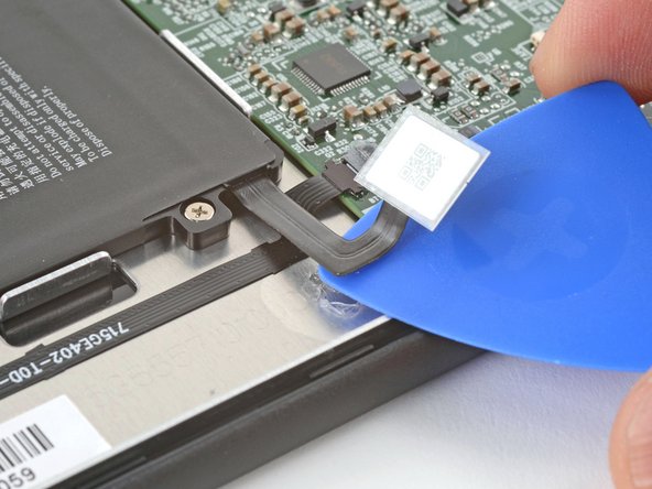

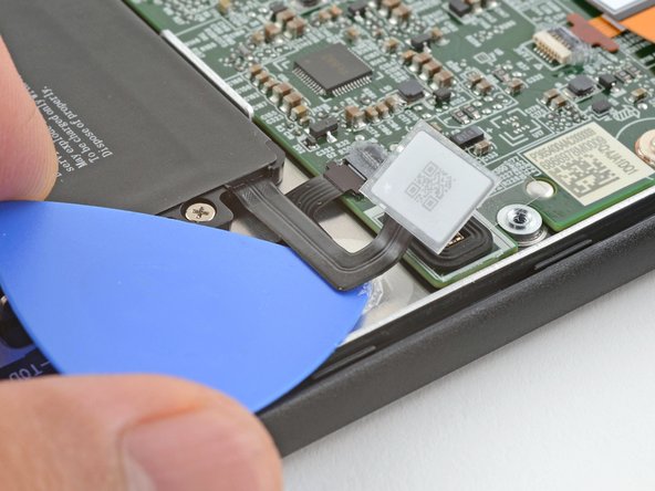

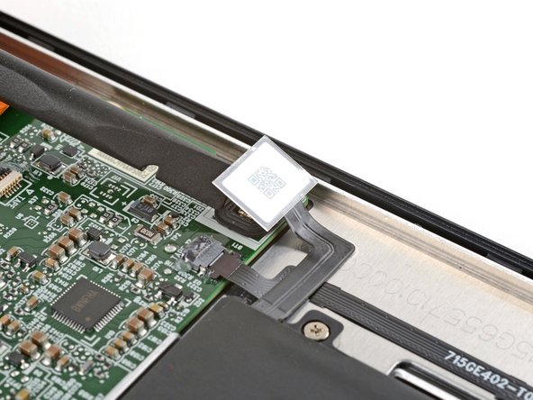

  15. Kobo Clara BW (P365) Motherboard Replacement, Un-stick the battery cable: crwdns2935265:015crwdnd2935265:01crwdnd2935265:03crwdne2935265:0 Kobo Clara BW (P365) Motherboard Replacement, Un-stick the battery cable: crwdns2935265:015crwdnd2935265:02crwdnd2935265:03crwdne2935265:0 Kobo Clara BW (P365) Motherboard Replacement, Un-stick the battery cable: crwdns2935265:015crwdnd2935265:03crwdnd2935265:03crwdne2935265:0
    • Insert the tip of an opening pick under the battery flex cable.
    • Slide the pick along the cable to separate it from the waterproof coating.
    • You'll probably pull up a bit of coating from the frame. This is fine and won't affect the eReader's functionality.

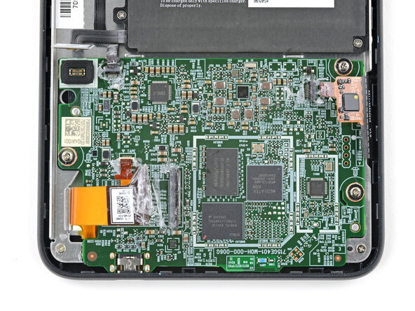

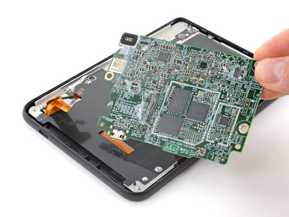

  16. Kobo Clara BW (P365) Motherboard Replacement, Remove the motherboard: crwdns2935265:016crwdnd2935265:01crwdnd2935265:02crwdne2935265:0 Kobo Clara BW (P365) Motherboard Replacement, Remove the motherboard: crwdns2935265:016crwdnd2935265:02crwdnd2935265:02crwdne2935265:0
    • Slide an opening pick under the top left corner of the motherboard and lift it up enough to grip it with your fingers.
  17. Kobo Clara BW (P365) Motherboard Replacement: crwdns2935265:017crwdnd2935265:01crwdnd2935265:02crwdne2935265:0 Kobo Clara BW (P365) Motherboard Replacement: crwdns2935265:017crwdnd2935265:02crwdnd2935265:02crwdne2935265:0
    • Lift the top edge of the motherboard and pull it towards the top of the eReader to remove it.
    • Slide the charging port into its slot at a slight downward angle before pressing the motherboard flat to the frame.
    • Follow this guide to update the VCOM number on your eReader to match your screen.
