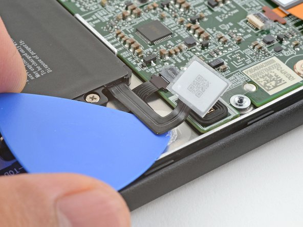

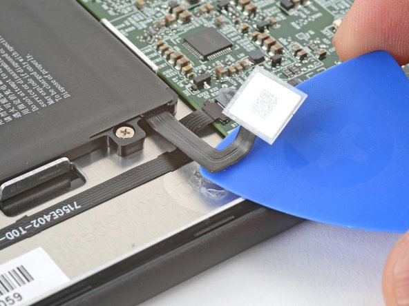

  9. Kobo Clara BW (N365B) Battery Replacement, Un-stick the battery cable: crwdns2935265:09crwdnd2935265:01crwdnd2935265:03crwdne2935265:0 Kobo Clara BW (N365B) Battery Replacement, Un-stick the battery cable: crwdns2935265:09crwdnd2935265:02crwdnd2935265:03crwdne2935265:0 Kobo Clara BW (N365B) Battery Replacement, Un-stick the battery cable: crwdns2935265:09crwdnd2935265:03crwdnd2935265:03crwdne2935265:0
    • Insert the tip of an opening pick under the battery flex cable.
    • Slide the pick along the cable to separate it from the waterproof coating.
    • You'll probably pull up a bit of coating from the frame. This is fine and won't affect the eReader's functionality.

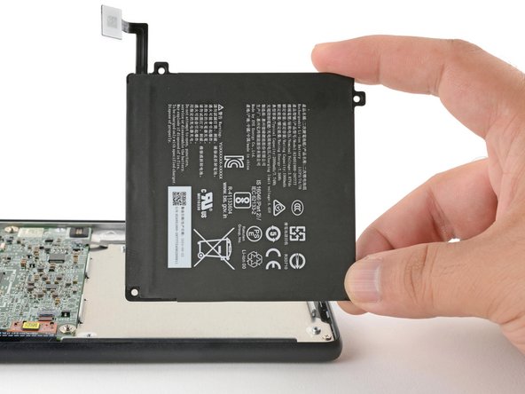

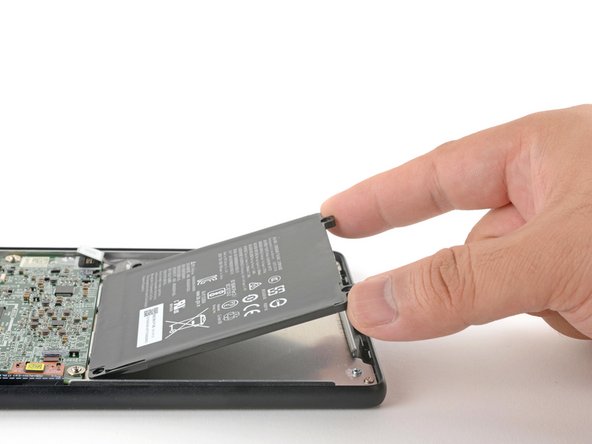

  11. Kobo Clara BW (N365B) Battery Replacement, Remove the battery: crwdns2935265:011crwdnd2935265:01crwdnd2935265:03crwdne2935265:0 Kobo Clara BW (N365B) Battery Replacement, Remove the battery: crwdns2935265:011crwdnd2935265:02crwdnd2935265:03crwdne2935265:0 Kobo Clara BW (N365B) Battery Replacement, Remove the battery: crwdns2935265:011crwdnd2935265:03crwdnd2935265:03crwdne2935265:0
    • Lift the battery off the frame and remove it.
    • If you're transferring the battery to a new screen, inspect the battery for any dents or deformations.
    • Never reuse a damaged battery! If your battery shows any signs of damage, replace it with a new one.
