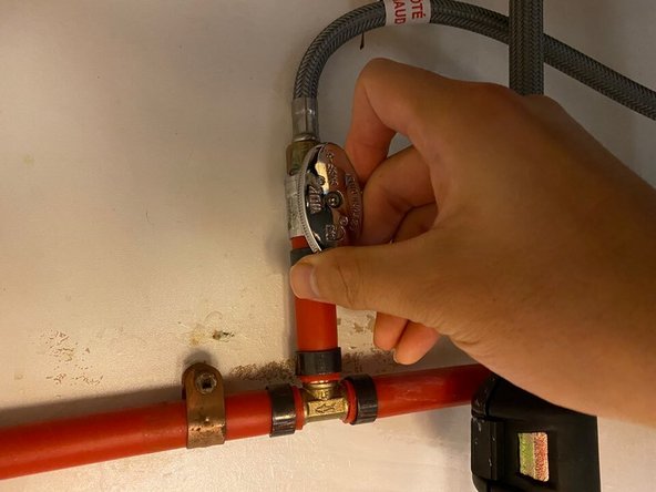

      • Rotate the hot and cold water valve knobs under the sink clockwise to turn off the water.
      • Turn on the faucet to relieve the pressure and any remaining water for about one minute.

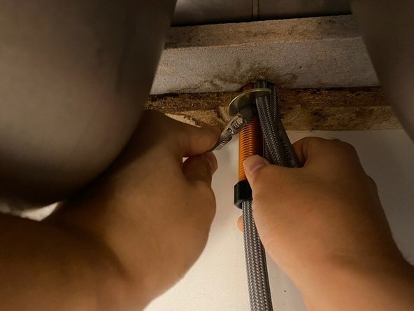

      • Loosen and remove the nuts underneath the sink by using an adjustable wrench.
      • Remove the mounting bracket.

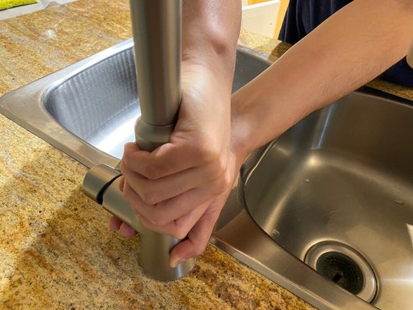

      • Use your hands to pull the faucet out of the sink.
      • Clean away any grime or sealant with a cleaning spray and towel.

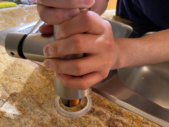

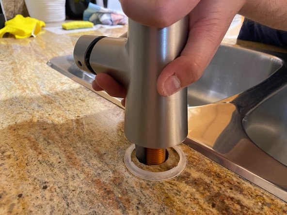

      • Place the trim ring on the faucet hole.
      • Feed the faucet into the faucet hole and position it.
      • Different faucets install differently, so be sure to read and follow the instructions for your faucet.

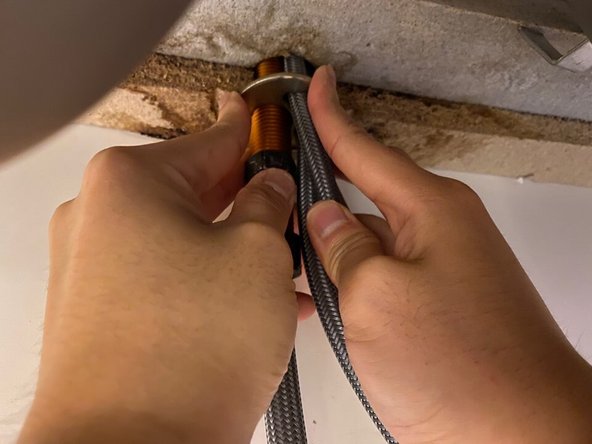

      • Underneath the sink, put the mounting bracket back in place, and turn the nuts to tighten them.

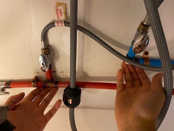

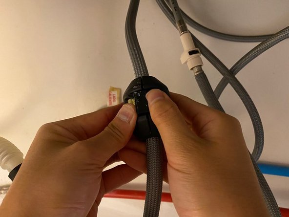

      • Hook the water supply lines up by turning the hot and cold supply line nuts counter clockwise.

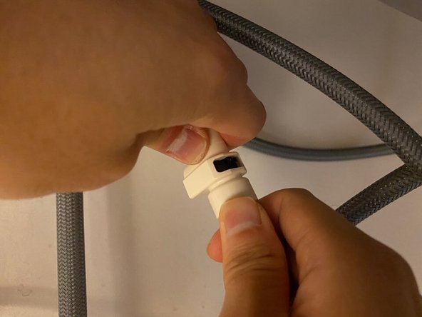

      • For pull-down faucets, attach the weight kit on the spray hose and connect it to both the spray head and the pull-out hose.

      • Rotate the hot and cold water valve knobs counter clockwise to turn on the water under the sink.
      • Once it is all done, check if there are any leaks.
