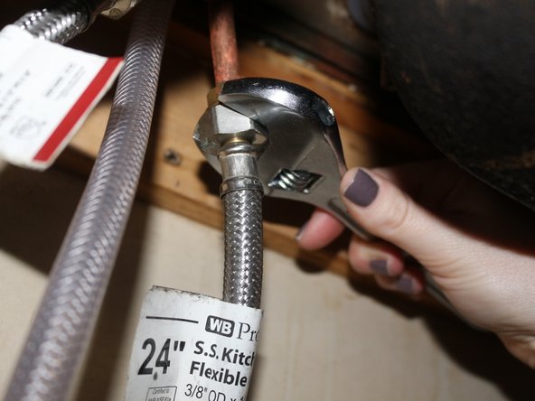

    • Pull on the sink faucet spray head from above the sink to find the main hose connection point to the water line located underneath the sink.
    • Unscrew the hose from the main faucet’s water line connection point.
    • A wrench may be necessary in order to loosen the nut.
    • Remove the hose from the sink sprayer location.
    • Connect the new hose by pressing it into the connection point. Then screw hose back on clockwise.
    • A wrench may be necessary in order to secure the end of the hose to the nut.
