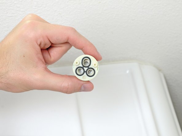

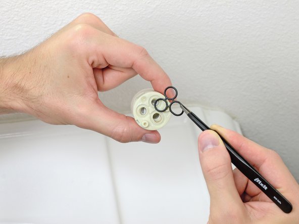

    12. How To Fix A Leaky Faucet: crwdns2935265:012crwdnd2935265:01crwdnd2935265:03crwdne2935265:0 How To Fix A Leaky Faucet: crwdns2935265:012crwdnd2935265:02crwdnd2935265:03crwdne2935265:0 How To Fix A Leaky Faucet: crwdns2935265:012crwdnd2935265:03crwdnd2935265:03crwdne2935265:0
      • Remove the cartridge o-rings.
      • If the leak has been coming only from the end of the faucet, replace the cartridge.
      • If the faucet has been leaking from the base or from the faucet handle, replace the o-rings.
      • When installing new o-rings, be sure to properly seat them into the grooves on the underside of the cartridge. A misaligned o-ring can easily cause a new leak.
