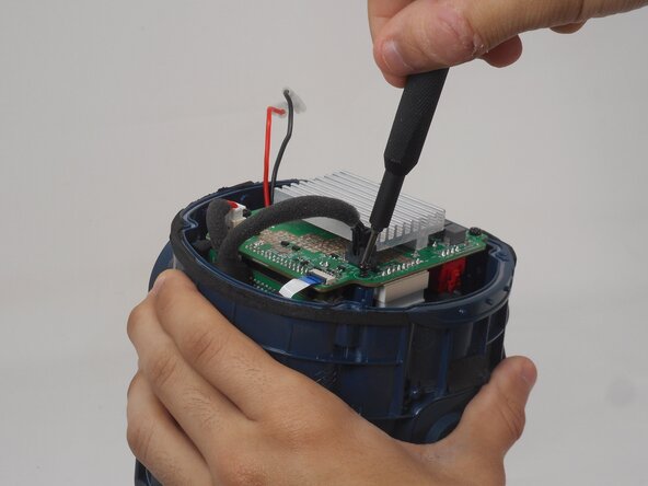

  11. JBL Xtreme 4 Motherboard Replacement, Motherboard: crwdns2935265:011crwdnd2935265:01crwdnd2935265:02crwdne2935265:0 JBL Xtreme 4 Motherboard Replacement, Motherboard: crwdns2935265:011crwdnd2935265:02crwdnd2935265:02crwdne2935265:0
    • Use a screwdriver to remove four 8.5 mm screws that secure the power supply board.

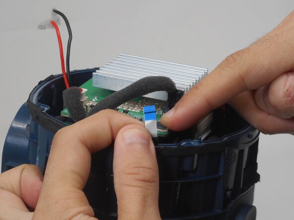

  12. JBL Xtreme 4 Motherboard Replacement: crwdns2935265:012crwdnd2935265:01crwdnd2935265:02crwdne2935265:0 JBL Xtreme 4 Motherboard Replacement: crwdns2935265:012crwdnd2935265:02crwdnd2935265:02crwdne2935265:0
    • Lift the black ZIF locking flap that secures the ribbon cable.
    • Pull the ribbon cable directly out of its socket.

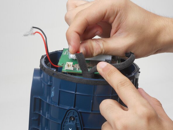

  13. JBL Xtreme 4 Motherboard Replacement: crwdns2935265:013crwdnd2935265:01crwdnd2935265:02crwdne2935265:0 JBL Xtreme 4 Motherboard Replacement: crwdns2935265:013crwdnd2935265:02crwdnd2935265:02crwdne2935265:0
    • Unplug the two cable connectors from the power supply board by pulling them straight up and out of their sockets.
  14. JBL Xtreme 4 Motherboard Replacement: crwdns2935265:014crwdnd2935265:01crwdnd2935265:02crwdne2935265:0 JBL Xtreme 4 Motherboard Replacement: crwdns2935265:014crwdnd2935265:02crwdnd2935265:02crwdne2935265:0
    • Carefully lift the power supply board and move it to the side to access the motherboard.

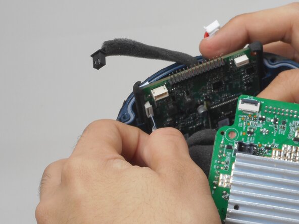

  15. JBL Xtreme 4 Motherboard Replacement: crwdns2935265:015crwdnd2935265:01crwdnd2935265:02crwdne2935265:0 JBL Xtreme 4 Motherboard Replacement: crwdns2935265:015crwdnd2935265:02crwdnd2935265:02crwdne2935265:0
    • Disconnect the two ribbon cables attached to the motherboard.
  16. JBL Xtreme 4 Motherboard Replacement: crwdns2935265:016crwdnd2935265:01crwdnd2935265:01crwdne2935265:0
    • Detach the remaining cable connector from the motherboard.
  17. JBL Xtreme 4 Motherboard Replacement: crwdns2935265:017crwdnd2935265:01crwdnd2935265:01crwdne2935265:0
    • Use angled tweezers to lift and disconnect the coaxial cable.

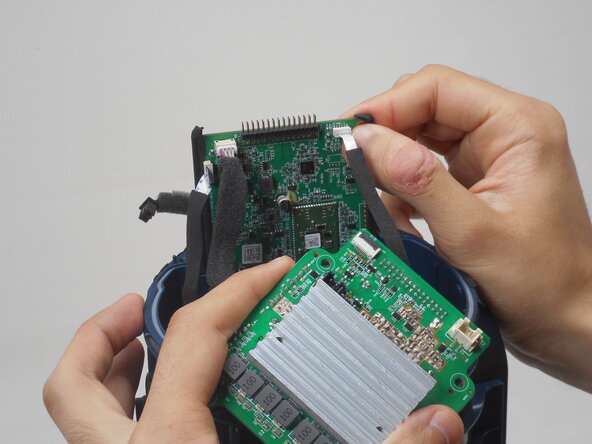

  18. JBL Xtreme 4 Motherboard Replacement: crwdns2935265:018crwdnd2935265:01crwdnd2935265:01crwdne2935265:0
    • Lift the motherboard out of the speaker housing to remove it completely.
