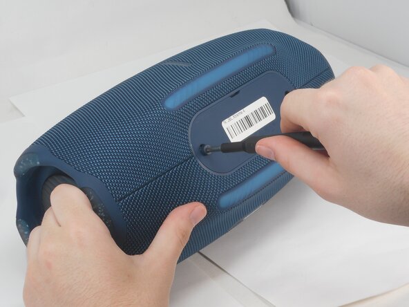

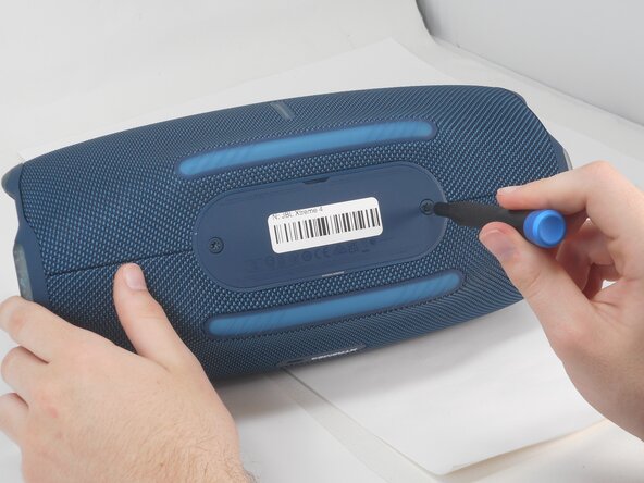

    • Use a T20 Torx screwdriver to remove the two 12.5 mm screws that secure the battery cover.

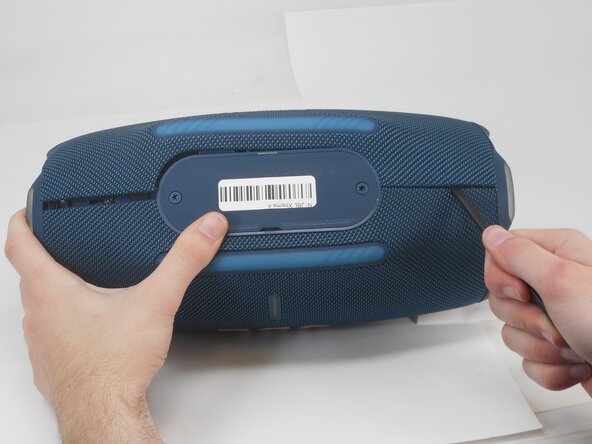

  4. JBL Xtreme 4 Charging Port Replacement, Outside Cover: crwdns2935265:04crwdnd2935265:01crwdnd2935265:02crwdne2935265:0 JBL Xtreme 4 Charging Port Replacement, Outside Cover: crwdns2935265:04crwdnd2935265:02crwdnd2935265:02crwdne2935265:0

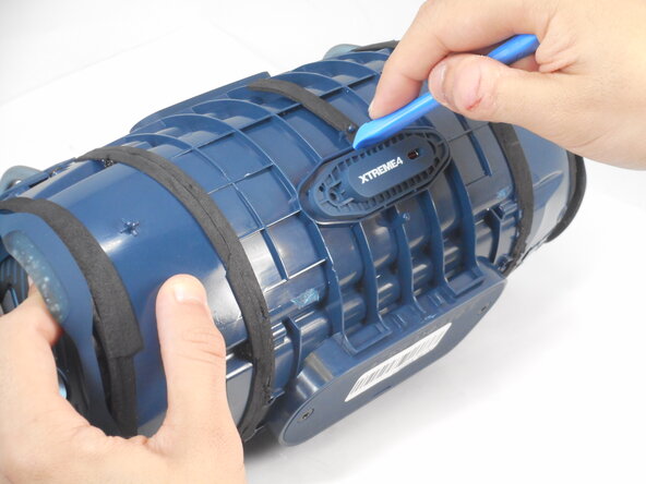

    • Insert the flat end of a spudger into the mesh cover seam beside the battery compartment.
    • Pry on both sides of the battery compartment until the mesh cover releases.

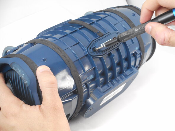

    • Remove the two 8.5 mm Phillips screws on the charging port cover.
    • Pry the cover off with an opening tool.

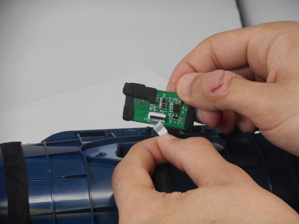

    • Disconnect the ribbon cable by gently pulling it out.

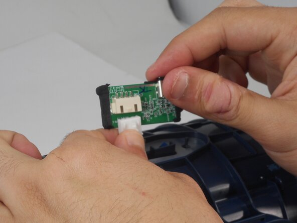

    • Remove the final cable connection by pinching the tab and pulling it directly out of its socket.
