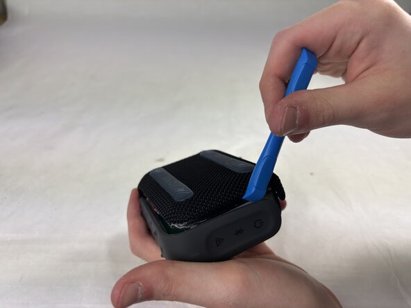

      • Use an opening tool to pry off both sides of the speaker cover.
      • Make sure to be careful to not force it apart and break it.

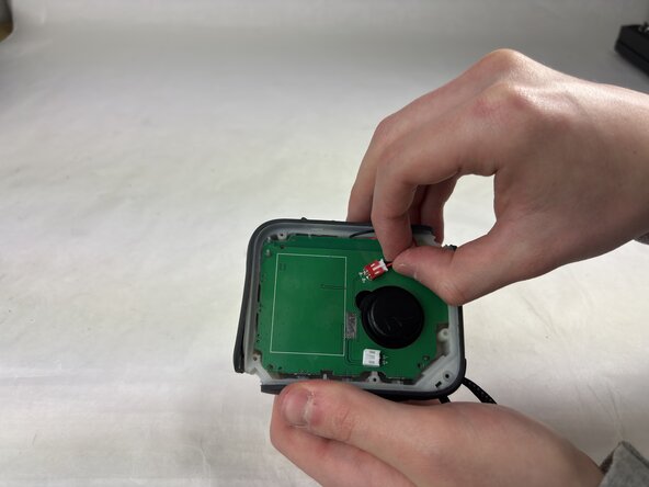

    3. JBL Go 4 Motherboard Replacement: crwdns2935265:03crwdnd2935265:01crwdnd2935265:02crwdne2935265:0 JBL Go 4 Motherboard Replacement: crwdns2935265:03crwdnd2935265:02crwdnd2935265:02crwdne2935265:0
      • Gently remove the white and red pieces from their connectors on the motherboard with your hands.
      • They should come out relatively easy, this is the last piece needed before removing the motherboard.

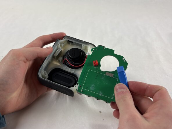

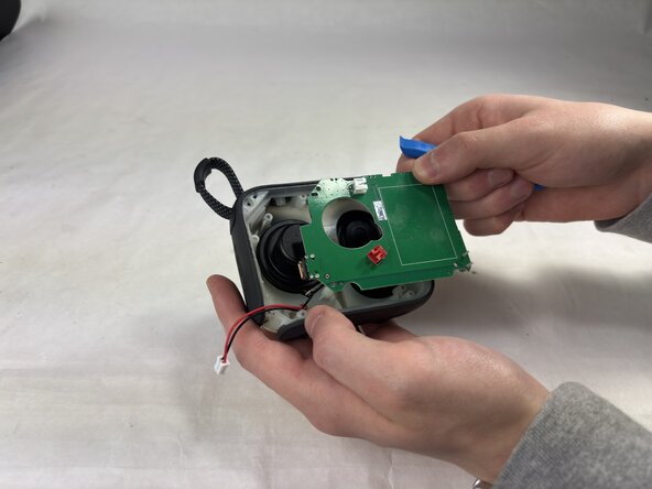

    4. JBL Go 4 Motherboard Replacement: crwdns2935265:04crwdnd2935265:01crwdnd2935265:03crwdne2935265:0 JBL Go 4 Motherboard Replacement: crwdns2935265:04crwdnd2935265:02crwdnd2935265:03crwdne2935265:0 JBL Go 4 Motherboard Replacement: crwdns2935265:04crwdnd2935265:03crwdnd2935265:03crwdne2935265:0
      • Use an opening tool to pry the motherboard away from the rest of the speaker.
      • Make sure to be very gentle, to cause no damage to the rest of the speaker.
