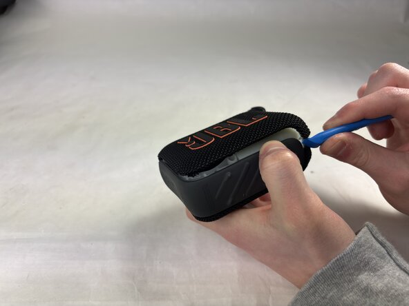

      • Insert an opening tool into the seam in between the grille and chassis, in the top corner opposite the strap.
      • Slide the tool along the edge of the housing until the grille releases.
      • Remove the grille.
      • Be sure that the battery has been drained completely before attempting this replacement.

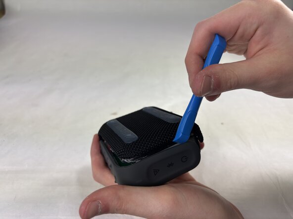

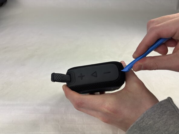

      • Insert an opening tool in the opposite corner, lifting carefully.
      • Slide the tool along the edge until the cover pops off.
      • Gently pull the housing up and to the side.
      • When the plate becomes loose, be incredibly gentle to avoid damaging the cable that connects the battery to the housing.

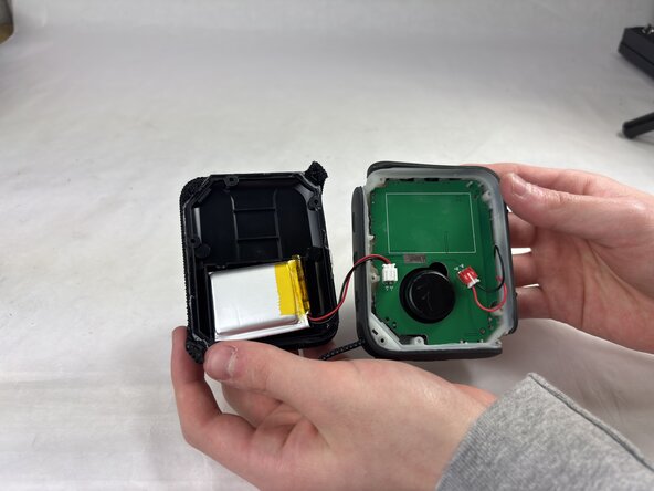

      • Find the connection between the motherboard and the battery cable as labeled.
      • Gently depress the plastic tabs and slowly wiggle the connector until it comes free.
      • Be incredibly gentle with this connector as any excessive force can damage the motherboard.

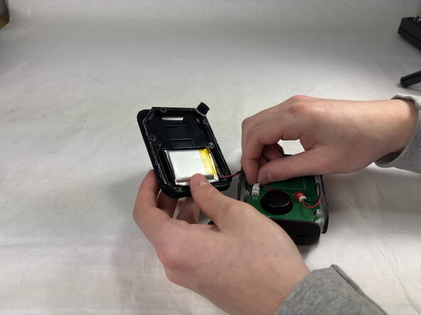

      • Insert an opening tool beneath the battery, on the side opposite to the battery cable.
      • Using a lever motion, pry the battery out slowly, sliding it further under to break the adhesive up.
      • It's important to note that the battery is held on with a small adhesive pad, so more force than should feel necessary will be needed.
For optimal performance, after completing this guide, calibrate your newly installed battery.
