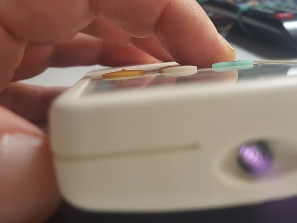

    • Remote controls use an infrared LED in the front. Sometimes it can be seen behind some kind of "window", which is why users point the remote at a device for it to work. It can be tested using the corresponding device, but it is always convenient to know additional forms of testing:
    • Using a digital camera: the infrared can be visible using almost any digital camera. There is no need to be fancy--simply use your phone's camera for this. Point the remote at your camera and press some buttons. They should make the LED produce a bluish-purplish light only visible in the camera screen. Here are some examples.

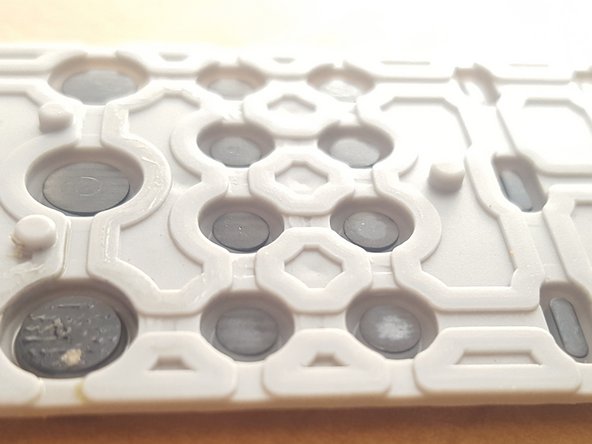

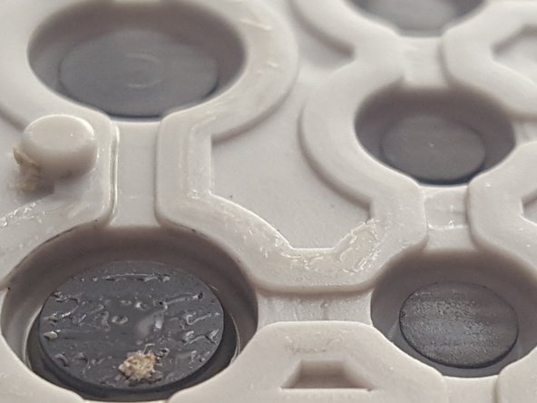

    • The first photo shows how much dirt and debris accumulated under the cover and on top of the flexible, grey keypad.
    • Pull the flexible rubber from the circuit, and on the back check that the keys end in a black piece that might be graphite or something similar. Normally the most used keys are more stained, as can be seen in the photos.
    • Gently wash the outer casings and the rubber flexible keypad with neutral soap and a discarded toothbrush. DO NOT wash the circuit board! Dry them thoroughly.

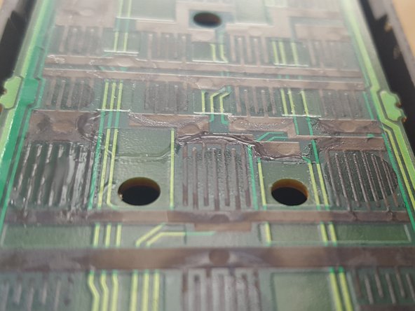

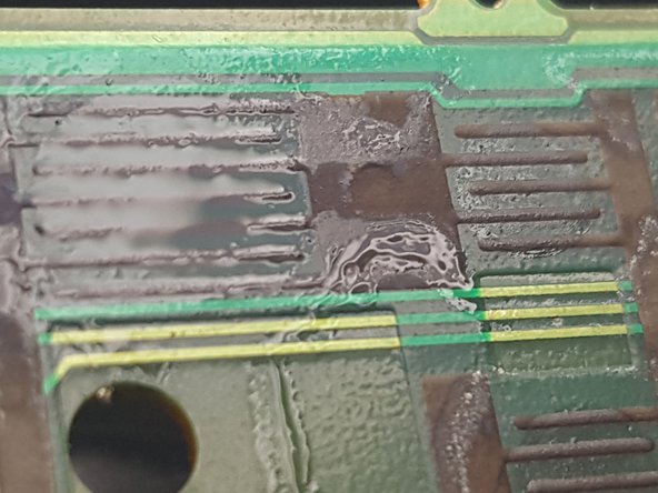

  4. Infrared Remote Control Cleaning, Cleaning the Printed Circuit: crwdns2935265:04crwdnd2935265:01crwdnd2935265:03crwdne2935265:0 Infrared Remote Control Cleaning, Cleaning the Printed Circuit: crwdns2935265:04crwdnd2935265:02crwdnd2935265:03crwdne2935265:0 Infrared Remote Control Cleaning, Cleaning the Printed Circuit: crwdns2935265:04crwdnd2935265:03crwdnd2935265:03crwdne2935265:0
    • The black tracks of the circuitboard will accumulate grease and dirt, specifically on the black screen-printed tracks that form the opposing combs that come into contact with the black part of the keys when pressed.
    • The tracks of the circuit can be cleaned with a cotton swab dipped in alcohol (common in a medicine cabinet) or, if possible, with isopropyl alcohol. Be careful not to erase the letters that the manufacturer sometimes prints on the board. Never wash the circuit board with water.
    • Let it completely dry. Appreciate the result of the cleaning.
