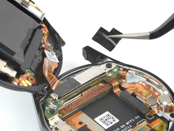

  5. Huawei Watch GT 3 Motherboard & Daughterboard Replacement, Peel off the black tape: crwdns2935265:05crwdnd2935265:01crwdnd2935265:02crwdne2935265:0 Huawei Watch GT 3 Motherboard & Daughterboard Replacement, Peel off the black tape: crwdns2935265:05crwdnd2935265:02crwdnd2935265:02crwdne2935265:0
    • Use a pair of tweezers to peel the black tape off the battery connector bracket.

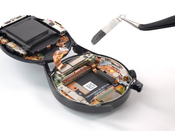

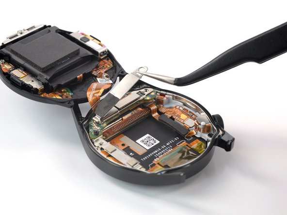

  7. Huawei Watch GT 3 Motherboard & Daughterboard Replacement, Remove the battery connector bracket: crwdns2935265:07crwdnd2935265:01crwdnd2935265:03crwdne2935265:0 Huawei Watch GT 3 Motherboard & Daughterboard Replacement, Remove the battery connector bracket: crwdns2935265:07crwdnd2935265:02crwdnd2935265:03crwdne2935265:0 Huawei Watch GT 3 Motherboard & Daughterboard Replacement, Remove the battery connector bracket: crwdns2935265:07crwdnd2935265:03crwdnd2935265:03crwdne2935265:0
    • Use a pair of tweezers to remove the battery connector bracket.
    • The connector bracket is secured with a small metal hook next to the screw recess. This hook sits very tight und you might need to bend it a little to the side to remove the bracket.

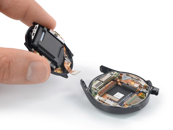

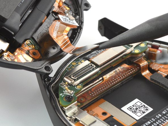

  8. Huawei Watch GT 3 Motherboard & Daughterboard Replacement, Disconnect the back cover assembly: crwdns2935265:08crwdnd2935265:01crwdnd2935265:03crwdne2935265:0 Huawei Watch GT 3 Motherboard & Daughterboard Replacement, Disconnect the back cover assembly: crwdns2935265:08crwdnd2935265:02crwdnd2935265:03crwdne2935265:0 Huawei Watch GT 3 Motherboard & Daughterboard Replacement, Disconnect the back cover assembly: crwdns2935265:08crwdnd2935265:03crwdnd2935265:03crwdne2935265:0
    • Use a spudger to disconnect the rear panel assembly cable by prying the connector straight up from its socket.
    • Remove the rear panel assembly.

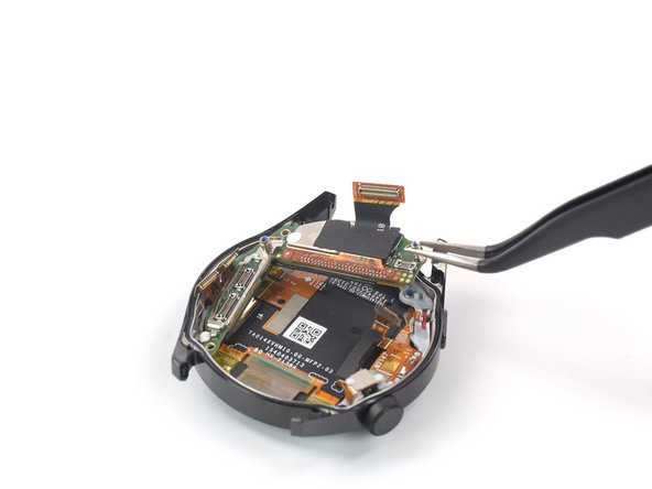

  10. Huawei Watch GT 3 Motherboard & Daughterboard Replacement, Disconnect the motherboard flex cable: crwdns2935265:010crwdnd2935265:01crwdnd2935265:02crwdne2935265:0 Huawei Watch GT 3 Motherboard & Daughterboard Replacement, Disconnect the motherboard flex cable: crwdns2935265:010crwdnd2935265:02crwdnd2935265:02crwdne2935265:0
    • Use a spudger to disconnect the motherboard flex cable by prying the connector straight up from its socket.

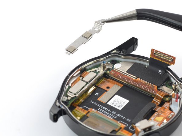

  12. Huawei Watch GT 3 Motherboard & Daughterboard Replacement, Remove the display connector bracket: crwdns2935265:012crwdnd2935265:01crwdnd2935265:03crwdne2935265:0 Huawei Watch GT 3 Motherboard & Daughterboard Replacement, Remove the display connector bracket: crwdns2935265:012crwdnd2935265:02crwdnd2935265:03crwdne2935265:0 Huawei Watch GT 3 Motherboard & Daughterboard Replacement, Remove the display connector bracket: crwdns2935265:012crwdnd2935265:03crwdnd2935265:03crwdne2935265:0
    • Use a pair of tweezers to remove the display connector bracket.
