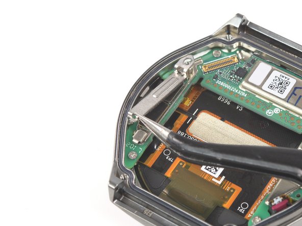

  6. Huawei Watch GT 2e Motherboard Replacement, Remove the bracket: crwdns2935265:07crwdnd2935265:01crwdnd2935265:03crwdne2935265:0 Huawei Watch GT 2e Motherboard Replacement, Remove the bracket: crwdns2935265:07crwdnd2935265:02crwdnd2935265:03crwdne2935265:0 Huawei Watch GT 2e Motherboard Replacement, Remove the bracket: crwdns2935265:07crwdnd2935265:03crwdnd2935265:03crwdne2935265:0
    • Use a pair of tweezers to slide the interconnect cable bracket down and left to unlatch it.
    • Remove the interconnect cable bracket.
    • For reassembly make sure to slide the bracket into place from bottom left towards top right to engage the small latch.

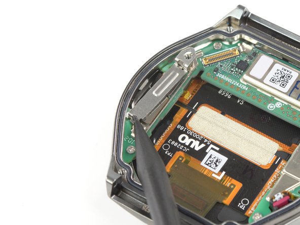

  8. Huawei Watch GT 2e Motherboard Replacement, Free the bracket: crwdns2935265:09crwdnd2935265:01crwdnd2935265:02crwdne2935265:0 Huawei Watch GT 2e Motherboard Replacement, Free the bracket: crwdns2935265:09crwdnd2935265:02crwdnd2935265:02crwdne2935265:0
    • Use the point of a spudger to slide the bottom part of the display connector bracket towards the buttons to disengage its latch.
    • When reassembling make sure the top part of the bracket sits properly before sliding the bottom part into place.

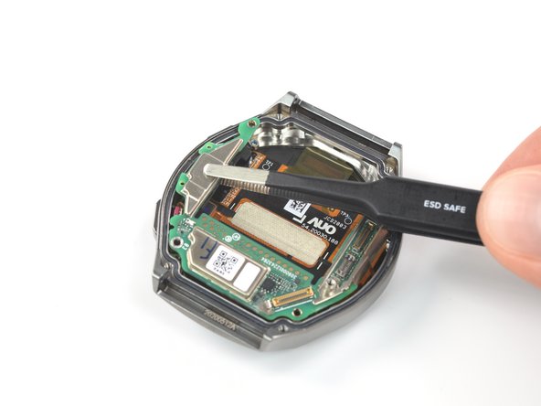

  9. Huawei Watch GT 2e Motherboard Replacement, Remove the bracket: crwdns2935265:010crwdnd2935265:01crwdnd2935265:03crwdne2935265:0 Huawei Watch GT 2e Motherboard Replacement, Remove the bracket: crwdns2935265:010crwdnd2935265:02crwdnd2935265:03crwdne2935265:0 Huawei Watch GT 2e Motherboard Replacement, Remove the bracket: crwdns2935265:010crwdnd2935265:03crwdnd2935265:03crwdne2935265:0
    • Grab the bottom part of the bracket with a pair of tweezers and lift it up and out of its top latch.
    • Remove the bracket.
    • For reassembly first position the top part of the bracket into its latch and over the screw boss before sliding the bottom part into place.

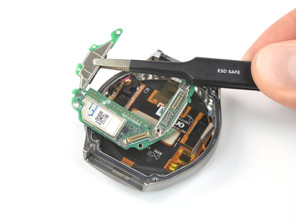

  13. Huawei Watch GT 2e Motherboard Replacement, Remove the motherboard: crwdns2935265:014crwdnd2935265:01crwdnd2935265:03crwdne2935265:0 Huawei Watch GT 2e Motherboard Replacement, Remove the motherboard: crwdns2935265:014crwdnd2935265:02crwdnd2935265:03crwdne2935265:0 Huawei Watch GT 2e Motherboard Replacement, Remove the motherboard: crwdns2935265:014crwdnd2935265:03crwdnd2935265:03crwdne2935265:0
    • Use a pair of tweezers to grab the part of the motherboard closest to the buttons.
    • Lift up that side of the motherboard first to free it from underneath the case on the opposite side.
    • Remove the motherboard.
    • For reassembly shift the motherboard into place underneath the case near the display cables before lower the part near the buttons.
