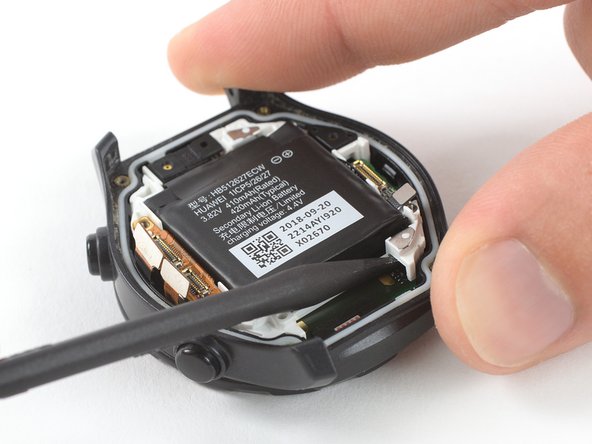

    • Avoid damaging the resistors on top of the motherboard during the following removal procedure.
    • The motherboard and the battery assembly are held together by two screws on the bottom of the motherboard. In order to replace the battery assembly, you need to pry the full assembly out of the watch frame.
    • Insert the pointed end of a spudger into the recess at the bottom right corner of the white battery frame.
    • Use the spudger to pry up the right corner of the assembly consisting of the battery and the motherboard.
  14. Huawei Watch 2 Battery Assembly Replacement: crwdns2935265:014crwdnd2935265:01crwdnd2935265:02crwdne2935265:0 Huawei Watch 2 Battery Assembly Replacement: crwdns2935265:014crwdnd2935265:02crwdnd2935265:02crwdne2935265:0
    • Insert the pointed end of a spudger into the recess at the bottom left corner of the white battery frame.
    • Use the spudger to pry up the left corner of the assembly consisting of the battery and the motherboard.

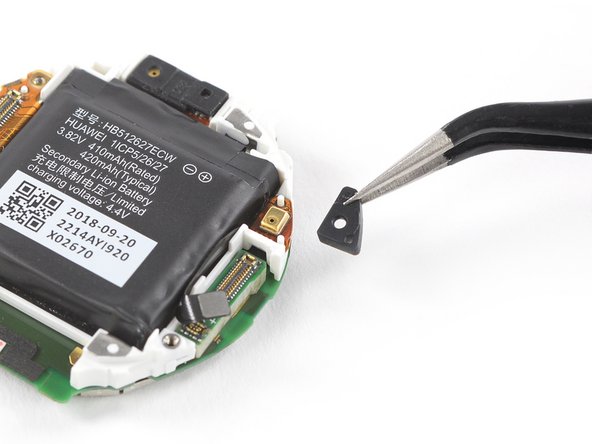

    • Use a pair of tweezers to remove the battery and motherboard assembly.
  16. Huawei Watch 2 Battery Assembly Replacement: crwdns2935265:016crwdnd2935265:01crwdnd2935265:02crwdne2935265:0 Huawei Watch 2 Battery Assembly Replacement: crwdns2935265:016crwdnd2935265:02crwdnd2935265:02crwdne2935265:0
    • Use a pair of tweezers to remove the black rubber gasket from the microphone next to the top right corner of the battery.
  17. Huawei Watch 2 Battery Assembly Replacement: crwdns2935265:017crwdnd2935265:01crwdnd2935265:01crwdne2935265:0
    • Remove the two Phillips screws (1.8 mm length) from the bottom of the motherboard.
  18. Huawei Watch 2 Battery Assembly Replacement: crwdns2935265:018crwdnd2935265:01crwdnd2935265:03crwdne2935265:0 Huawei Watch 2 Battery Assembly Replacement: crwdns2935265:018crwdnd2935265:02crwdnd2935265:03crwdne2935265:0 Huawei Watch 2 Battery Assembly Replacement: crwdns2935265:018crwdnd2935265:03crwdnd2935265:03crwdne2935265:0
    • Use a pair of tweezers to remove the motherboard from the battery assembly.
    • At this point during reassembly make sure that the flex cable on the bottom side of the battery assembly is connected to the motherboard.
