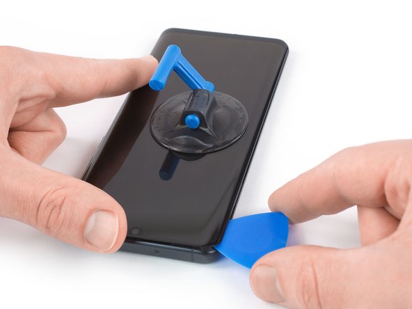

  28. Huawei P30 Pro Screen & Digitizer Replacement: crwdns2935265:028crwdnd2935265:01crwdnd2935265:02crwdne2935265:0 Huawei P30 Pro Screen & Digitizer Replacement: crwdns2935265:028crwdnd2935265:02crwdnd2935265:02crwdne2935265:0
    • Once the screen is warm to the touch, apply a suction cup to the left edge of the phone.
    • Pull the suction cup upwards and insert an opening pick in the gap between the display glass and the plastic bezel.
    • Cut the adhesive by sliding the opening pick to the top left corner of the phone.

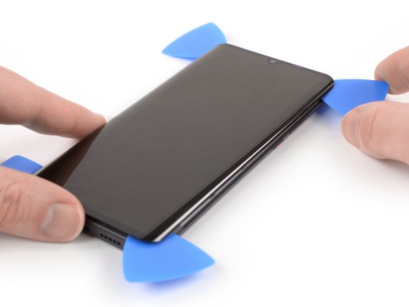

  29. Huawei P30 Pro Screen & Digitizer Replacement: crwdns2935265:029crwdnd2935265:01crwdnd2935265:02crwdne2935265:0 Huawei P30 Pro Screen & Digitizer Replacement: crwdns2935265:029crwdnd2935265:02crwdnd2935265:02crwdne2935265:0
    • Insert a second opening pick and slide it to the bottom left corner of the phone to cut the adhesive.
    • Leave the opening picks in their place to prevent the adhesive from resealing.
  30. Huawei P30 Pro Screen & Digitizer Replacement: crwdns2935265:030crwdnd2935265:01crwdnd2935265:02crwdne2935265:0 Huawei P30 Pro Screen & Digitizer Replacement: crwdns2935265:030crwdnd2935265:02crwdnd2935265:02crwdne2935265:0
    • Insert a third opening pick under the bottom left corner of the phone.
    • Slide the opening pick along the bottom edge of the phone to cut the adhesive.
    • Leave the opening pick in the bottom right corner to prevent the adhesive from resealing.
  31. Huawei P30 Pro Screen & Digitizer Replacement: crwdns2935265:031crwdnd2935265:01crwdnd2935265:03crwdne2935265:0 Huawei P30 Pro Screen & Digitizer Replacement: crwdns2935265:031crwdnd2935265:02crwdnd2935265:03crwdne2935265:0 Huawei P30 Pro Screen & Digitizer Replacement: crwdns2935265:031crwdnd2935265:03crwdnd2935265:03crwdne2935265:0
    • Insert a fourth opening pick at the bottom right corner of the phone.
    • Slide the opening pick along the right edge of the phone to cut the adhesive.
    • If cutting becomes too difficult, reheat and reapply the iOpener.

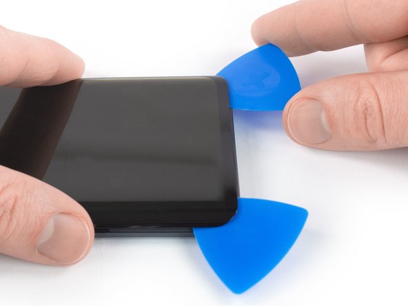

  32. Huawei P30 Pro Screen & Digitizer Replacement: crwdns2935265:032crwdnd2935265:01crwdnd2935265:02crwdne2935265:0 Huawei P30 Pro Screen & Digitizer Replacement: crwdns2935265:032crwdnd2935265:02crwdnd2935265:02crwdne2935265:0
    • Insert a fifth opening pick at the top right corner of the phone.
    • When nearing the front facing camera, only work with the tip of the opening pick to avoid damaging or smearing the camera.
    • Slide the opening pick along the top edge of the phone to cut the remaining adhesive.
    • Don't try to remove the display all the way yet—the display cable is still threaded through the frame and adhered on the inner side of the midframe.
