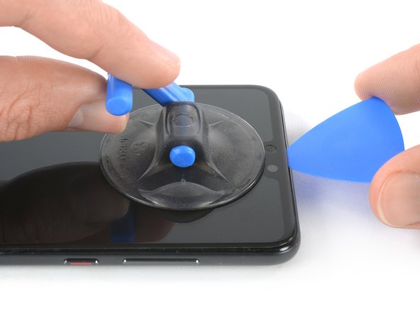

  28. Huawei P20 Pro Screen Replacement: crwdns2935265:028crwdnd2935265:01crwdnd2935265:03crwdne2935265:0 Huawei P20 Pro Screen Replacement: crwdns2935265:028crwdnd2935265:02crwdnd2935265:03crwdne2935265:0 Huawei P20 Pro Screen Replacement: crwdns2935265:028crwdnd2935265:03crwdnd2935265:03crwdne2935265:0
    • Once the screen is warm to the touch, apply a suction cup to the upper edge of the phone.
    • Pull the suction cup upwards and insert an opening pick in the gap between the display glass and the plastic bezel. Start to cut the adhesive by sliding the opening pick to the top left corner.
    • Make sure you get in the right gap between the display and the plastic bezel. Do not pry between the bezel and the midframe.

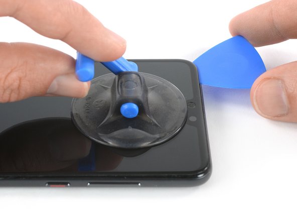

  29. Huawei P20 Pro Screen Replacement: crwdns2935265:029crwdnd2935265:01crwdnd2935265:02crwdne2935265:0 Huawei P20 Pro Screen Replacement: crwdns2935265:029crwdnd2935265:02crwdnd2935265:02crwdne2935265:0
    • Insert a second opening pick and slide it to the top right corner of the phone.
    • Leave the picks in their places to prevent the adhesive from resealing.

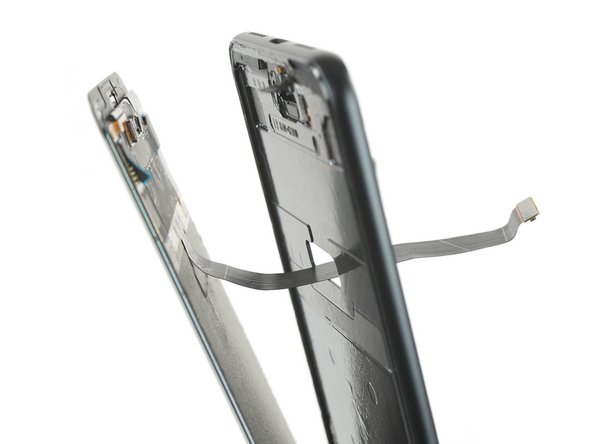

    • Try not to remove the display all the way yet, the display cable is still threaded through the frame and adhered on the opposite side.
  33. Huawei P20 Pro Screen Replacement: crwdns2935265:033crwdnd2935265:01crwdnd2935265:02crwdne2935265:0 Huawei P20 Pro Screen Replacement: crwdns2935265:033crwdnd2935265:02crwdnd2935265:02crwdne2935265:0
    • Use a pair of tweezers to peel the display flex cable free from the frame.
    • Thread the display flex cable through the gap in the frame and remove the display.
