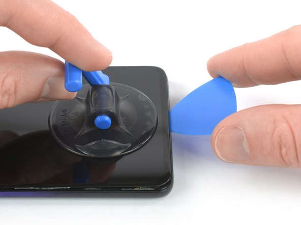

    • Secure a suction handle to the bottom of the back cover, as close to the edge as possible.
    • If the phone's rear glass is cracked, the suction handle may not stick. Try lifting it with strong tape, or superglue the suction handle in place and allow it to cure so you can proceed.
    • Lift the back cover with the suction handle to create a small gap between the cover and the frame.
    • Insert an opening pick into the gap.
    • If you have trouble, apply more heat to further soften the adhesive. Follow the iOpener instructions to avoid overheating.
    • Slide the opening pick to the bottom right corner.

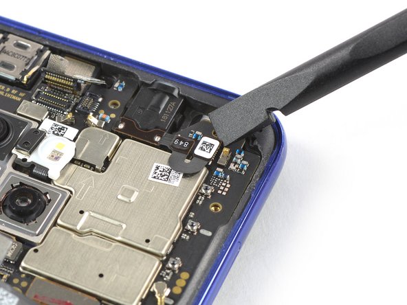

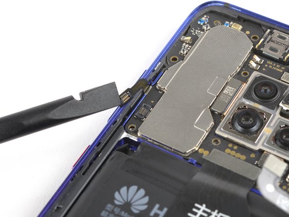

  14. Huawei Mate 20 LCD & Digitizer Replacement: crwdns2935265:014crwdnd2935265:01crwdnd2935265:03crwdne2935265:0 Huawei Mate 20 LCD & Digitizer Replacement: crwdns2935265:014crwdnd2935265:02crwdnd2935265:03crwdne2935265:0 Huawei Mate 20 LCD & Digitizer Replacement: crwdns2935265:014crwdnd2935265:03crwdnd2935265:03crwdne2935265:0
    • Use a spudger to pry up and disconnect the fingerprint flex cable.

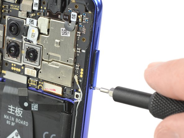

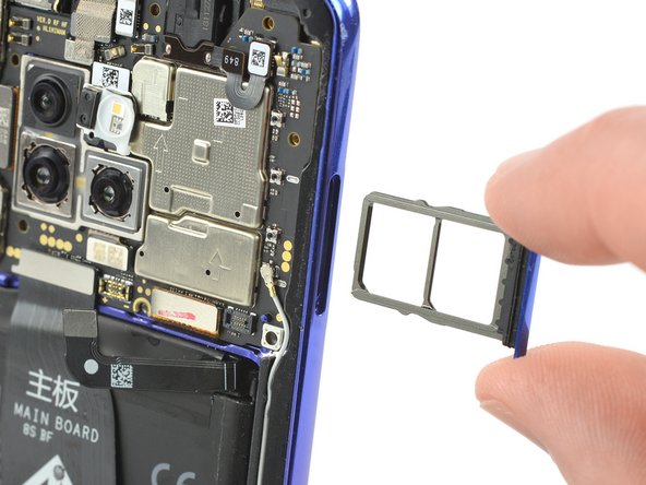

    Huawei Mate 20 LCD & Digitizer Replacement, Motherboard Assembly: crwdns2935265:016crwdnd2935265:01crwdnd2935265:03crwdne2935265:0 Huawei Mate 20 LCD & Digitizer Replacement, Motherboard Assembly: crwdns2935265:016crwdnd2935265:02crwdnd2935265:03crwdne2935265:0 Huawei Mate 20 LCD & Digitizer Replacement, Motherboard Assembly: crwdns2935265:016crwdnd2935265:03crwdnd2935265:03crwdne2935265:0
    • Remove the SIM card tray.

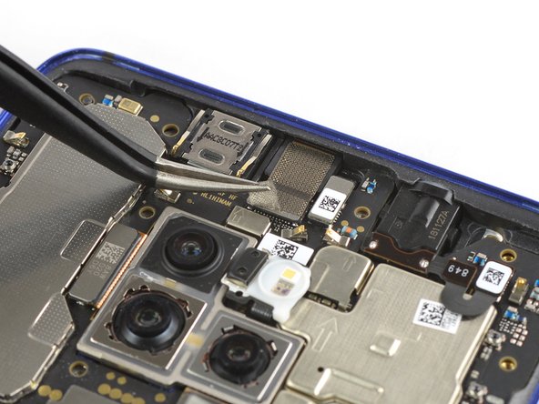

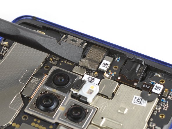

  19. Huawei Mate 20 LCD & Digitizer Replacement: crwdns2935265:019crwdnd2935265:01crwdnd2935265:02crwdne2935265:0 Huawei Mate 20 LCD & Digitizer Replacement: crwdns2935265:019crwdnd2935265:02crwdnd2935265:02crwdne2935265:0
    • Use a spudger to pry up and disconnect the sensor assembly flex cable.
  20. Huawei Mate 20 LCD & Digitizer Replacement: crwdns2935265:020crwdnd2935265:01crwdnd2935265:02crwdne2935265:0 Huawei Mate 20 LCD & Digitizer Replacement: crwdns2935265:020crwdnd2935265:02crwdnd2935265:02crwdne2935265:0
    • Use a spudger to pry up and disconnect the headphone jack flex cable.

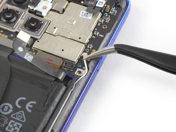

  21. Huawei Mate 20 LCD & Digitizer Replacement: crwdns2935265:021crwdnd2935265:01crwdnd2935265:02crwdne2935265:0 Huawei Mate 20 LCD & Digitizer Replacement: crwdns2935265:021crwdnd2935265:02crwdnd2935265:02crwdne2935265:0
    • Use a pair of tweezers to carefully pry up and disconnect the antenna cable.
  22. Huawei Mate 20 LCD & Digitizer Replacement: crwdns2935265:022crwdnd2935265:01crwdnd2935265:02crwdne2935265:0 Huawei Mate 20 LCD & Digitizer Replacement: crwdns2935265:022crwdnd2935265:02crwdnd2935265:02crwdne2935265:0
    • Use a spudger to pry up and disconnect the display flex cable.

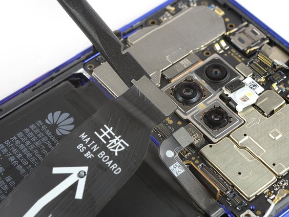

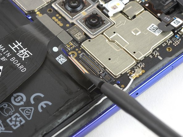

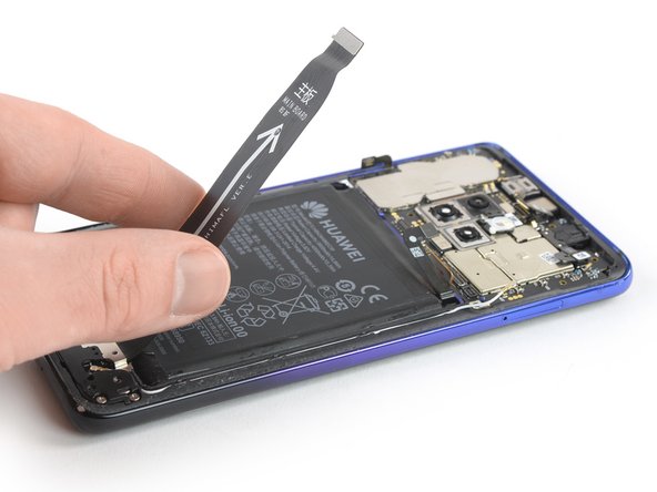

  23. Huawei Mate 20 LCD & Digitizer Replacement: crwdns2935265:023crwdnd2935265:01crwdnd2935265:03crwdne2935265:0 Huawei Mate 20 LCD & Digitizer Replacement: crwdns2935265:023crwdnd2935265:02crwdnd2935265:03crwdne2935265:0 Huawei Mate 20 LCD & Digitizer Replacement: crwdns2935265:023crwdnd2935265:03crwdnd2935265:03crwdne2935265:0
    • Use a spudger to pry up and disconnect the main flex cable.
    • Carefully fold the main flex cable back and out of the way so you have enough space to work on the bottom edge of the motherboard assembly.

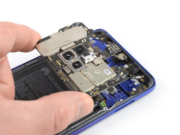

  24. Huawei Mate 20 LCD & Digitizer Replacement: crwdns2935265:024crwdnd2935265:01crwdnd2935265:02crwdne2935265:0 Huawei Mate 20 LCD & Digitizer Replacement: crwdns2935265:024crwdnd2935265:02crwdnd2935265:02crwdne2935265:0
    • Insert a spudger into the gap between the motherboard assembly and the midframe at the bottom edge of the motherboard.
    • Use the spudger to pry up the motherboard assembly.
  25. Huawei Mate 20 LCD & Digitizer Replacement: crwdns2935265:025crwdnd2935265:01crwdnd2935265:02crwdne2935265:0 Huawei Mate 20 LCD & Digitizer Replacement: crwdns2935265:025crwdnd2935265:02crwdnd2935265:02crwdne2935265:0
    • Carefully remove the motherboard assembly. Avoid damaging surrounding components such as the battery or the headphone jack flex cable during this process.

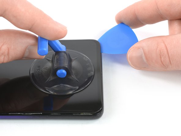

  26. Huawei Mate 20 LCD & Digitizer Replacement, LCD & Digitizer: crwdns2935265:026crwdnd2935265:01crwdnd2935265:02crwdne2935265:0 Huawei Mate 20 LCD & Digitizer Replacement, LCD & Digitizer: crwdns2935265:026crwdnd2935265:02crwdnd2935265:02crwdne2935265:0
    • Apply a heated iOpener to the screen and all edges of the phone for at least two minutes, to loosen the adhesive.
    • In the following step make sure you get in the right gap between the display and the plastic bezel. Do not pry between the bezel and the midframe.
  27. Huawei Mate 20 LCD & Digitizer Replacement: crwdns2935265:027crwdnd2935265:01crwdnd2935265:03crwdne2935265:0 Huawei Mate 20 LCD & Digitizer Replacement: crwdns2935265:027crwdnd2935265:02crwdnd2935265:03crwdne2935265:0 Huawei Mate 20 LCD & Digitizer Replacement: crwdns2935265:027crwdnd2935265:03crwdnd2935265:03crwdne2935265:0
    • Once the screen is warm to the touch, apply a suction cup to the bottom edge of the phone.
    • Pull the suction cup upwards and insert an opening pick in the gap between the display glass and the midframe. Start to cut the adhesive by sliding the opening pick to the bottom right corner.
