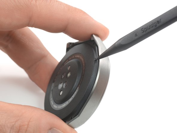

  3. How to open the Huawei Watch GT 2e, Open a small gap: crwdns2935265:04crwdnd2935265:01crwdnd2935265:03crwdne2935265:0 How to open the Huawei Watch GT 2e, Open a small gap: crwdns2935265:04crwdnd2935265:02crwdnd2935265:03crwdne2935265:0 How to open the Huawei Watch GT 2e, Open a small gap: crwdns2935265:04crwdnd2935265:03crwdnd2935265:03crwdne2935265:0
    • Place the point of a spudger in the small hole on the side of the rear case.
    • Use the spudger to push the rear case away from the housing to create a small gap. Use steady force to separate the two parts.
    • Steady the rear case with a finger to avoid it suddenly popping open and damaging the flex cable.
    • Don’t open the rear case all the way just yet. It is still connected to the motherboard with a thin flex cable.

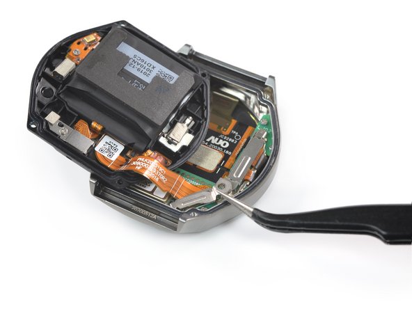

  5. How to open the Huawei Watch GT 2e, Remove the bracket screw: crwdns2935265:06crwdnd2935265:01crwdnd2935265:01crwdne2935265:0
    $3.99
    • Remove the 2.5 mm-long Phillips screw securing the interconnect cable bracket.
    • When re-assembling you might need a pair of pointy angled tweezers to position the screw since they are non-ferrous and therefore don’t stick to the magnetic bit.

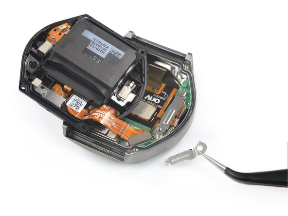

  6. How to open the Huawei Watch GT 2e, Remove the bracket: crwdns2935265:07crwdnd2935265:01crwdnd2935265:03crwdne2935265:0 How to open the Huawei Watch GT 2e, Remove the bracket: crwdns2935265:07crwdnd2935265:02crwdnd2935265:03crwdne2935265:0 How to open the Huawei Watch GT 2e, Remove the bracket: crwdns2935265:07crwdnd2935265:03crwdnd2935265:03crwdne2935265:0
    • Use a pair of tweezers to slide the interconnect cable bracket down and left to unlatch it.
    • Remove the interconnect cable bracket.
    • For reassembly make sure to slide the bracket into place from bottom left towards top right to engage the small latch.
