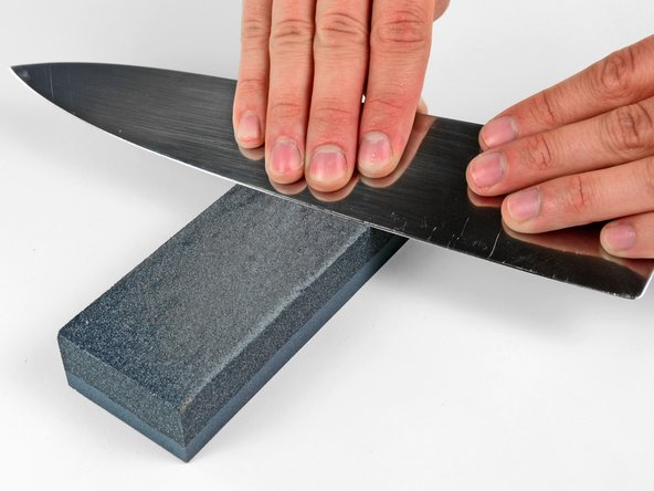

  2. How to Sharpen Knives: crwdns2935265:02crwdnd2935265:01crwdnd2935265:02crwdne2935265:0 How to Sharpen Knives: crwdns2935265:02crwdnd2935265:02crwdnd2935265:02crwdne2935265:0
    • If you want to avoid some of the scratches seen on the sharpened blade (see below), use pieces of tape to cover the side of your knife during the sharpening process.
    • The sharpening stone I'm using is dual grit. The first picture is a side view of the stone. The coarse grit is on the left, and the fine grit is on the right.
    • During sharpening, you can get better results if you use a bit of oil on the stone. Oil helps keep metal powder and excess grit out of the way of the blade as you push it across the stone. Oil is not strictly required.

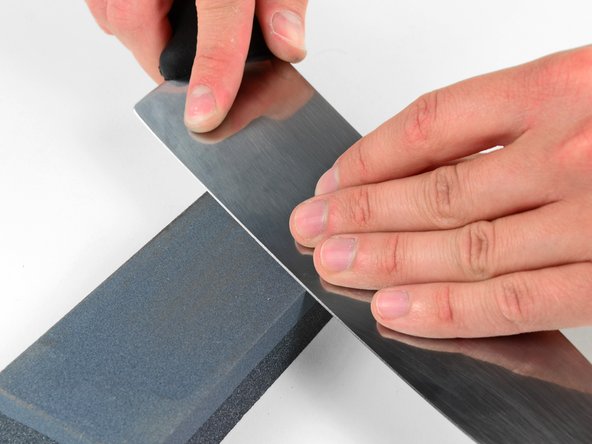

  3. How to Sharpen Knives: crwdns2935265:03crwdnd2935265:01crwdnd2935265:03crwdne2935265:0 How to Sharpen Knives: crwdns2935265:03crwdnd2935265:02crwdnd2935265:03crwdne2935265:0 How to Sharpen Knives: crwdns2935265:03crwdnd2935265:03crwdnd2935265:03crwdne2935265:0
    • To get rid of the nicks and rough areas on the blade, I'll be using the coarse grit side of the stone first. If the edge of your blade needs a light sharpening, you can use just the fine grit side of the stone for the sharpening process.
    • With the edge of the blade in contact with the large, flat side of the stone, angle the blade about 20-25 degrees from the flat face of the stone.
    • While applying light pressure, push the blade forward along the face of the stone.
    • To help sharpen the blade uniformly, you may wish to push the blade both forward and to the side to cover more of the blade with one pass.
    • Continue to sharpen the length of the blade until the cutting edge has a uniform bevel along its length. If there are chips, continue to sharpen that area until they are gone. The key is to keep the knife angled consistently away from the stone while uniformly sharpening the length of its blade.
  4. How to Sharpen Knives: crwdns2935265:04crwdnd2935265:01crwdnd2935265:03crwdne2935265:0 How to Sharpen Knives: crwdns2935265:04crwdnd2935265:02crwdnd2935265:03crwdne2935265:0 How to Sharpen Knives: crwdns2935265:04crwdnd2935265:03crwdnd2935265:03crwdne2935265:0
    • Once one side of the blade has been uniformly sharpened with the coarse grit, repeat the process to uniformly bevel the length of the cutting edge on the other side of the knife.
    • Be sure to apply pressure to the portion of the blade in contact with the flat plane of the stone. Pressing more on the knife closest to the edges of the stone will cause the knife to dig into the edge of the stone, causing the edge to be non-uniform. Pressing against the flattest portion of the stone will feel very smooth when you glide your knife across its surface.
  5. How to Sharpen Knives: crwdns2935265:05crwdnd2935265:01crwdnd2935265:02crwdne2935265:0 How to Sharpen Knives: crwdns2935265:05crwdnd2935265:02crwdnd2935265:02crwdne2935265:0
    • Once you have removed the nicks and you've uniformly beveled both sides of the knife's edge, flip the stone over to use the fine grit side.
    • Repeat the process which is detailed in the previous steps to uniformly sharpen both sides of the blade with the fine grit stone.
