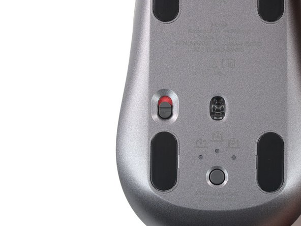

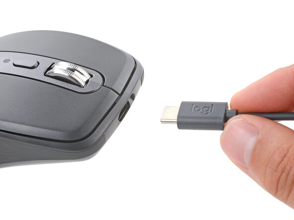

      • Slide the mouse's power switch to the OFF position and unplug any cables.
      • Flip the mouse over so the feet are facing up.
      • The unique shape of some mice can prevent them from laying flat. If you need to, lay your mouse on a soft towel to prevent wobble.

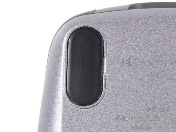

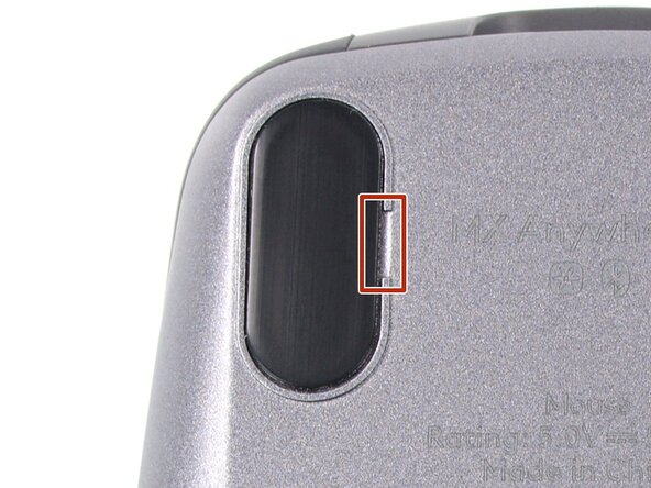

      • While you wait for the adhesive to soften, note the following:
      • There are small gaps in the rims surrounding each foot. This is where to insert your tool when peeling up the feet.
    4. How to Open Your Logitech MX Anywhere 3, Remove the feet: crwdns2935265:04crwdnd2935265:01crwdnd2935265:03crwdne2935265:0 How to Open Your Logitech MX Anywhere 3, Remove the feet: crwdns2935265:04crwdnd2935265:02crwdnd2935265:03crwdne2935265:0 How to Open Your Logitech MX Anywhere 3, Remove the feet: crwdns2935265:04crwdnd2935265:03crwdnd2935265:03crwdne2935265:0

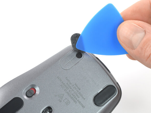

      • Push the tip of an opening pick (or spudger) underneath the mouse foot, into the gap in the rim.
      • Go slowly, and make sure the pick slides underneath both the foot and its adhesive pad—these layers separate easily.
      • If you plan on reusing your mouse feet, be careful not to crease them or separate them from their adhesive pads.
      • Slide your pick under the foot and lift to remove it.
      • Repeat the process to remove the three remaining mouse feet. If you're having trouble sliding the tool under a foot, reheat it and try again.

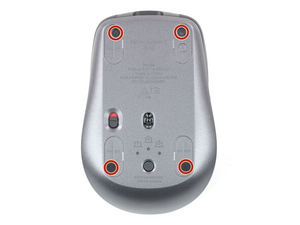

      • Use a Phillips screwdriver to remove the four 4.3 mm‑long screws securing the two halves of the mouse together.

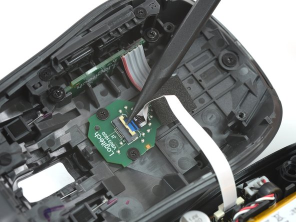

    3. How to Open Your Logitech MX Anywhere 3, Disconnect the interconnect cable: crwdns2935265:07crwdnd2935265:01crwdnd2935265:02crwdne2935265:0 How to Open Your Logitech MX Anywhere 3, Disconnect the interconnect cable: crwdns2935265:07crwdnd2935265:02crwdnd2935265:02crwdne2935265:0
      • Use the point of a spudger or a clean fingernail to flip up the small, hinged locking flap on the interconnect cable ZIF connector (located on the underside of the top shell).
    4. How to Open Your Logitech MX Anywhere 3, Separate the cable adhesive: crwdns2935265:08crwdnd2935265:01crwdnd2935265:02crwdne2935265:0 How to Open Your Logitech MX Anywhere 3, Separate the cable adhesive: crwdns2935265:08crwdnd2935265:02crwdnd2935265:02crwdne2935265:0

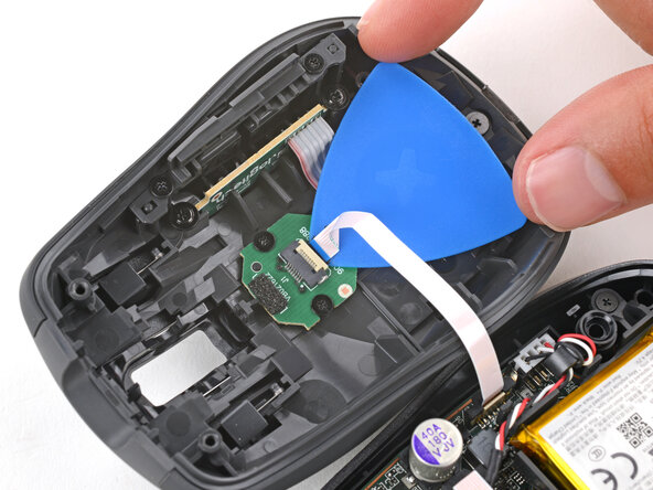

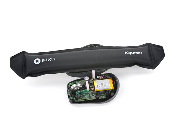

      • There may be a small piece of adhesive securing the interconnect cable to the board on the top shell, right where the cable goes into its socket.
      • Apply a heated iOpener to the board on the underside of the mouse's top half for two minutes.
      • Gently slide the tip of an opening pick under the cable to separate its adhesive.
    5. How to Open Your Logitech MX Anywhere 3: crwdns2935265:09crwdnd2935265:01crwdnd2935265:02crwdne2935265:0 How to Open Your Logitech MX Anywhere 3: crwdns2935265:09crwdnd2935265:02crwdnd2935265:02crwdne2935265:0
      • Use your fingers or tweezers to pull the cable straight out of its socket.
      • During reassembly, insert the cable with its blue tab facing up, then flip down the locking flap.

My interconnect cable wasn't glued hard, but was attached via adhesive which took careful effort to peel away. I had to remove the screws on the board to get to the lower level to clean up coffee, though fortunately there was very little. However when I went to reassemble, I found a free spring and no clue where it came from. Thankfully, enlarging the third picture in step 5 shows where the spring is under the wheel assembly and I was able to reassemble successfully (also the two screws holding the wheel assembly are slightly longer than all others). I even managed to reinsert and restick the interconnect cable correctly.
