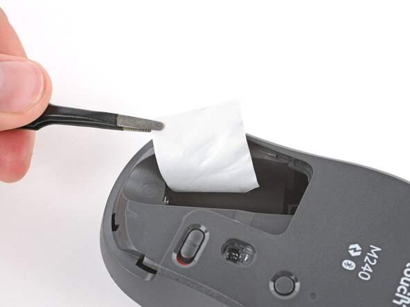

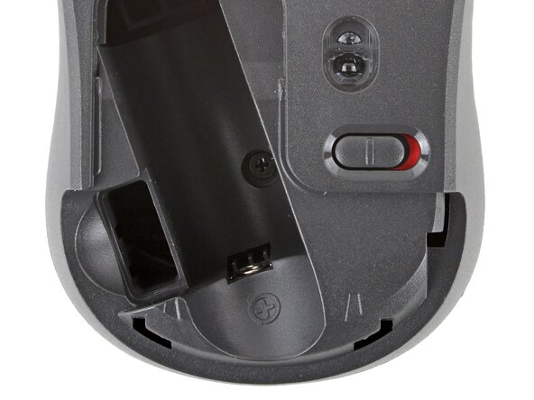

  4. How to Open Your Logitech M240 Wireless Mouse, Remove the sticker: crwdns2935265:04crwdnd2935265:01crwdnd2935265:01crwdne2935265:0
    • The sticker in the battery recess hides a screw. If you don't mind damaging the sticker, you can skip this step and pierce through it with your screwdriver.
    • Use a pair of tweezers to slowly peel up and remove the sticker from the battery recess.
    • If you're having trouble, heat the sticker with an iOpener or hair dryer to make it easier to remove.

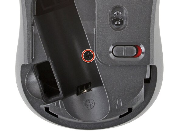

  5. How to Open Your Logitech M240 Wireless Mouse, Remove the case screw: crwdns2935265:05crwdnd2935265:01crwdnd2935265:02crwdne2935265:0 How to Open Your Logitech M240 Wireless Mouse, Remove the case screw: crwdns2935265:05crwdnd2935265:02crwdnd2935265:02crwdne2935265:0
    • Use a Phillips screwdriver to remove the 5.5 mm‑long screw from the battery recess.

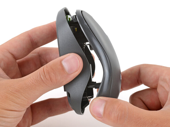

  6. How to Open Your Logitech M240 Wireless Mouse, Separate the two halves: crwdns2935265:06crwdnd2935265:01crwdnd2935265:03crwdne2935265:0 How to Open Your Logitech M240 Wireless Mouse, Separate the two halves: crwdns2935265:06crwdnd2935265:02crwdnd2935265:03crwdne2935265:0 How to Open Your Logitech M240 Wireless Mouse, Separate the two halves: crwdns2935265:06crwdnd2935265:03crwdnd2935265:03crwdne2935265:0

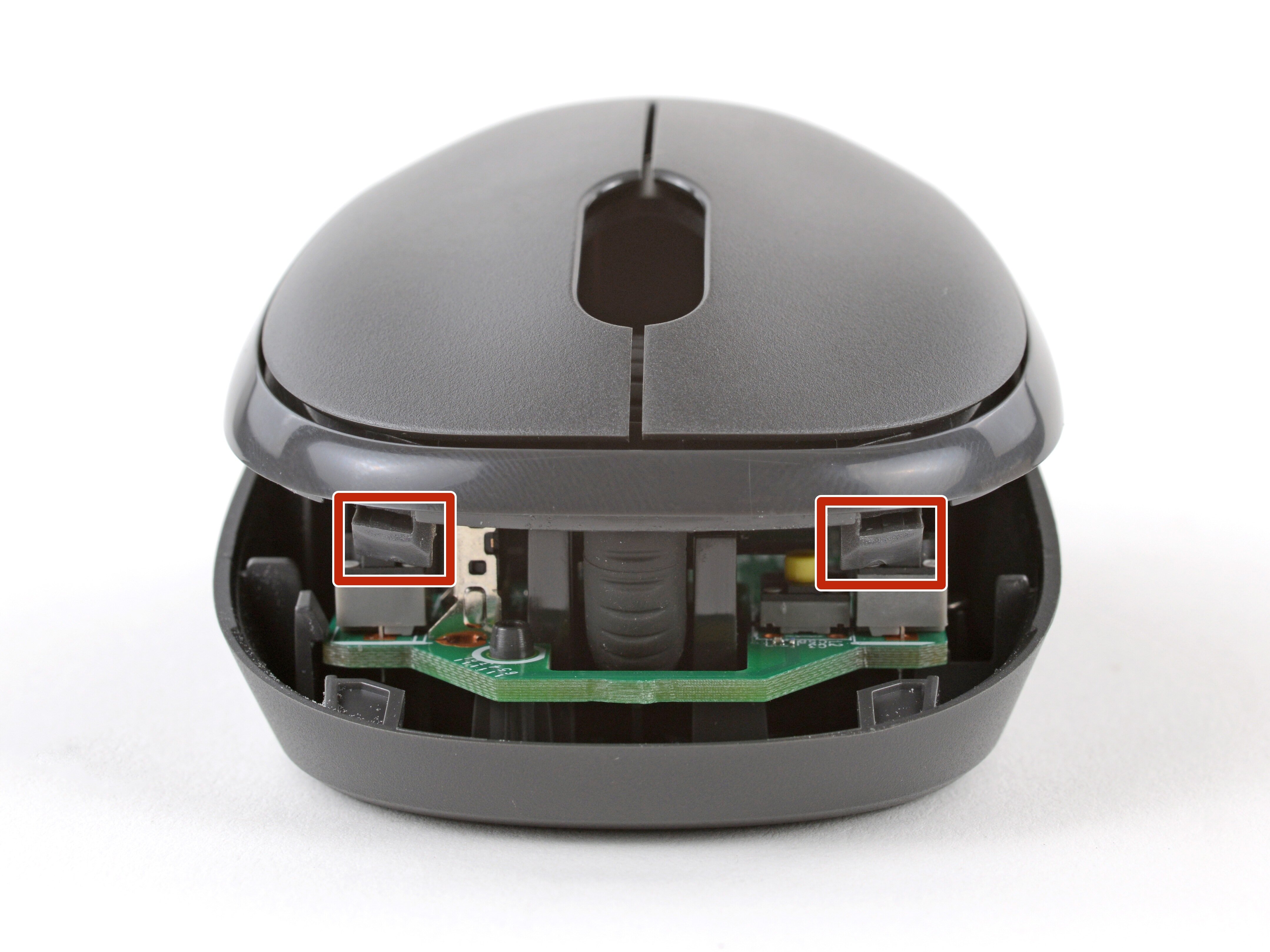

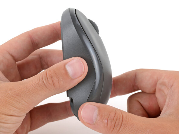

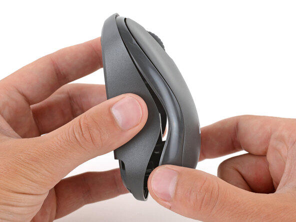

    • The two halves of the mouse are secured by two clips near the front.
    • Hold the bottom half of the mouse steady and pull the top half away and down to separate it.

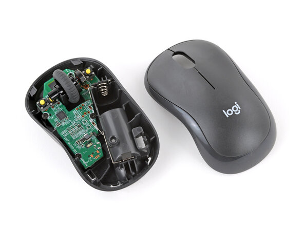

  7. How to Open Your Logitech M240 Wireless Mouse: crwdns2935265:07crwdnd2935265:01crwdnd2935265:01crwdne2935265:0
    • Your mouse is now open.
