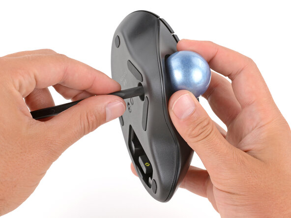

  4. How to Open Your Logitech Ergo M575S, Remove the trackball: crwdns2935265:04crwdnd2935265:01crwdnd2935265:03crwdne2935265:0 How to Open Your Logitech Ergo M575S, Remove the trackball: crwdns2935265:04crwdnd2935265:02crwdnd2935265:03crwdne2935265:0 How to Open Your Logitech Ergo M575S, Remove the trackball: crwdns2935265:04crwdnd2935265:03crwdnd2935265:03crwdne2935265:0
    • Insert a spudger into the trackball hole on the bottom of the mouse and push the trackball out of its recess.

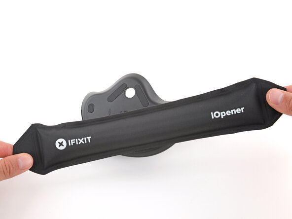

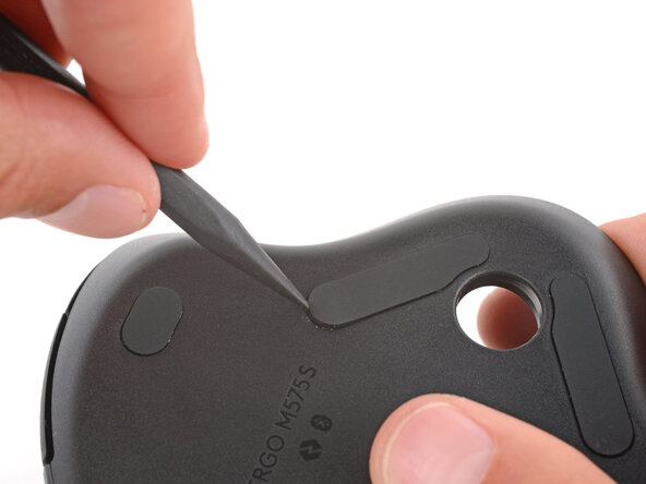

  5. How to Open Your Logitech Ergo M575S, Heat the feet: crwdns2935265:05crwdnd2935265:01crwdnd2935265:02crwdne2935265:0 How to Open Your Logitech Ergo M575S, Heat the feet: crwdns2935265:05crwdnd2935265:02crwdnd2935265:02crwdne2935265:0
    • The mouse feet cover screws and must be removed to open the mouse.
    • Heat an iOpener and lay it on the mouse feet for one minute to soften the adhesive securing the feet.
    • Alternatively, you can use a hair dryer on the Low heat setting to soften the adhesive.
    • If you're using a hair dryer, only heat the feet a few seconds at a time or you may warp the plastic shell.

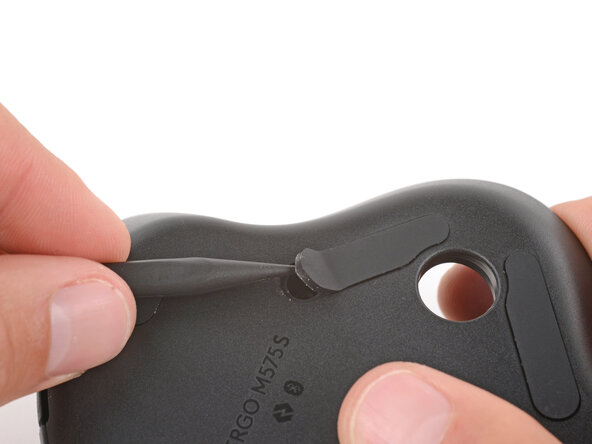

  6. How to Open Your Logitech Ergo M575S, Remove the feet: crwdns2935265:06crwdnd2935265:01crwdnd2935265:03crwdne2935265:0 How to Open Your Logitech Ergo M575S, Remove the feet: crwdns2935265:06crwdnd2935265:02crwdnd2935265:03crwdne2935265:0 How to Open Your Logitech Ergo M575S, Remove the feet: crwdns2935265:06crwdnd2935265:03crwdnd2935265:03crwdne2935265:0
    • If you're reusing the feet, be careful not to damage them during removal.
    • Slide the point of a spudger under the end of one of the feet and lift until you can grip it with your fingers.
    • Use your fingers to peel up and remove the mouse foot.
    • If the foot separated from its adhesive, use tweezers to remove any bits from the recess. You'll need to replace any feet that separate from their adhesive.

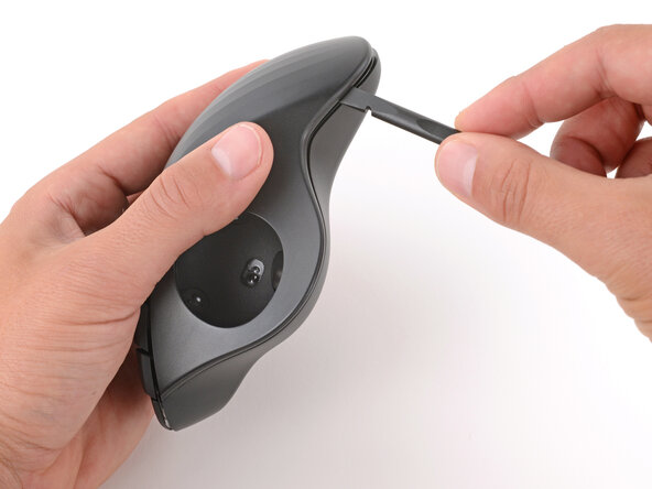

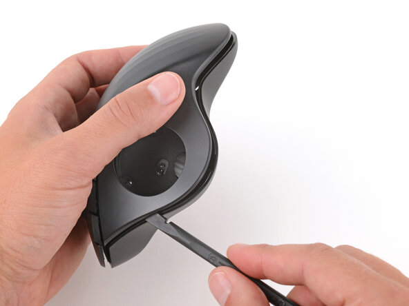

  9. How to Open Your Logitech Ergo M575S, Separate the mouse halves: crwdns2935265:09crwdnd2935265:01crwdnd2935265:03crwdne2935265:0 How to Open Your Logitech Ergo M575S, Separate the mouse halves: crwdns2935265:09crwdnd2935265:02crwdnd2935265:03crwdne2935265:0 How to Open Your Logitech Ergo M575S, Separate the mouse halves: crwdns2935265:09crwdnd2935265:03crwdnd2935265:03crwdne2935265:0
    • Insert the flat end of a spudger between the two halves of the mouse, near the front.
    • Slide the spudger towards the back of the mouse and gently pry to release the clips securing the two halves.

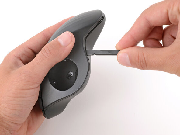

  10. How to Open Your Logitech Ergo M575S: crwdns2935265:010crwdnd2935265:01crwdnd2935265:03crwdne2935265:0 How to Open Your Logitech Ergo M575S: crwdns2935265:010crwdnd2935265:02crwdnd2935265:03crwdne2935265:0 How to Open Your Logitech Ergo M575S: crwdns2935265:010crwdnd2935265:03crwdnd2935265:03crwdne2935265:0
    • Repeat the process to separate the other side of the mouse.
    • Don't try to fully separate the two halves yet—a ribbon cable still connects them.

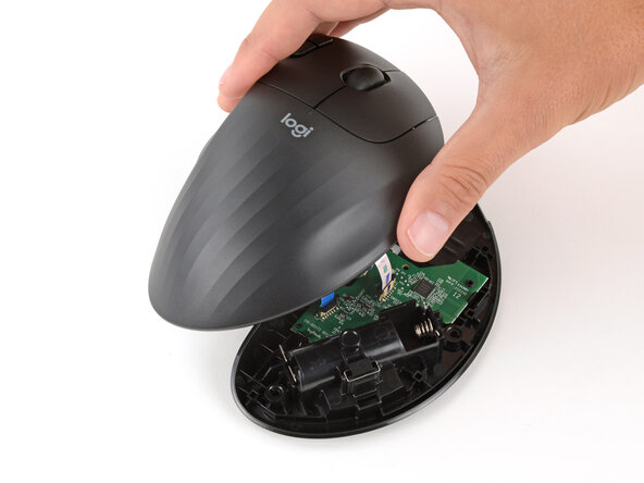

  11. How to Open Your Logitech Ergo M575S, Reposition the top half: crwdns2935265:011crwdnd2935265:01crwdnd2935265:03crwdne2935265:0 How to Open Your Logitech Ergo M575S, Reposition the top half: crwdns2935265:011crwdnd2935265:02crwdnd2935265:03crwdne2935265:0 How to Open Your Logitech Ergo M575S, Reposition the top half: crwdns2935265:011crwdnd2935265:03crwdnd2935265:03crwdne2935265:0
    • Gently lift the top half and place it to the left of the mouse so you can access the internals.

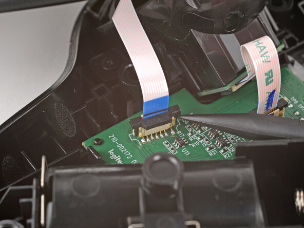

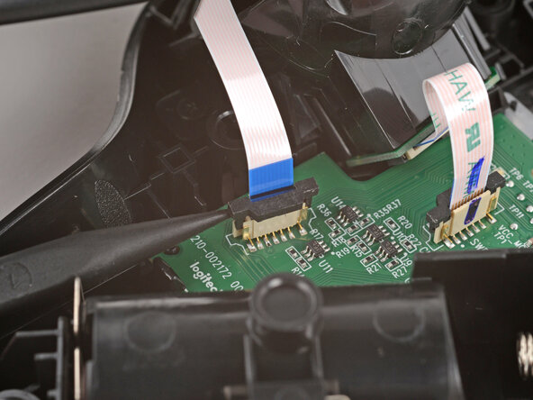

  12. How to Open Your Logitech Ergo M575S, Disconnect the top half: crwdns2935265:012crwdnd2935265:01crwdnd2935265:03crwdne2935265:0 How to Open Your Logitech Ergo M575S, Disconnect the top half: crwdns2935265:012crwdnd2935265:02crwdnd2935265:03crwdne2935265:0 How to Open Your Logitech Ergo M575S, Disconnect the top half: crwdns2935265:012crwdnd2935265:03crwdnd2935265:03crwdne2935265:0
    • Use the point of a spudger to gently push up on alternating sides of the interconnect cable locking tab until it clicks into its unlocked position.
    • You should feel the latch pop into the unlocked position. Don't push too far, or the latch may come completely off the connector.
  13. How to Open Your Logitech Ergo M575S: crwdns2935265:013crwdnd2935265:01crwdnd2935265:02crwdne2935265:0 How to Open Your Logitech Ergo M575S: crwdns2935265:013crwdnd2935265:02crwdnd2935265:02crwdne2935265:0
    • Slide the cable straight up and out of its socket.
  14. How to Open Your Logitech Ergo M575S, Remove the top half: crwdns2935265:014crwdnd2935265:01crwdnd2935265:01crwdne2935265:0
    • Remove the top half of the mouse from the bottom half.
