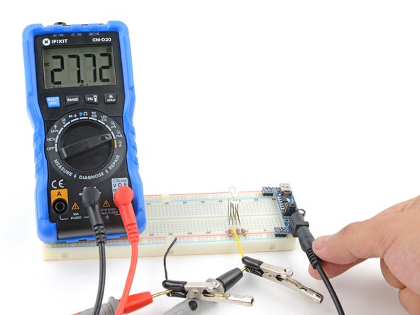

      • Plug the black lead into the COM port. Plug the red lead into the A port (the left port on the iFixit multimeter).
      • Turn the function dial to the amp A mode. If you're measuring Alternating Current (AC), press the blue select button to switch to AC mode.
    2. How to Make Advanced Measurements With a Multimeter, How to measure high current (amp scale): crwdns2935265:03crwdnd2935265:01crwdnd2935265:02crwdne2935265:0 How to Make Advanced Measurements With a Multimeter, How to measure high current (amp scale): crwdns2935265:03crwdnd2935265:02crwdnd2935265:02crwdne2935265:0
      • Power down the circuit you're measuring.
      • Choose the point where you want to measure the current. You'll need to break the circuit at that point. This may mean snipping a wire, disconnecting a connector, or removing a jumper wire.
      • Connect the multimeter in-line with the circuit by touching the probes to the ends of the broken circuit. If possible, use alligator clips to hold the probes to the ends.
      • The polarity of the probes somewhat matters. The multimeter will measure current flowing into the red probe and out the black probe. If you reverse the probes, it will show a negative value on the multimeter, but it won't damage the meter.
      • Confirm that the probes are only touching what they should and nothing else.
      • Check to make sure the circuit isn't accidentally touching you or anything conductive that may short it.
      • Power on the circuit and make your measurement.

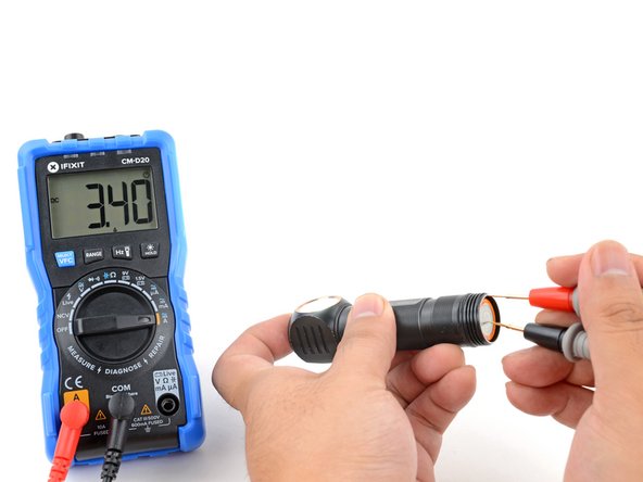

    3. How to Make Advanced Measurements With a Multimeter, How to measure low current (mA scale): crwdns2935265:04crwdnd2935265:01crwdnd2935265:03crwdne2935265:0 How to Make Advanced Measurements With a Multimeter, How to measure low current (mA scale): crwdns2935265:04crwdnd2935265:02crwdnd2935265:03crwdne2935265:0 How to Make Advanced Measurements With a Multimeter, How to measure low current (mA scale): crwdns2935265:04crwdnd2935265:03crwdnd2935265:03crwdne2935265:0
      • The next two steps show how to measure low (<600 mA) current.
      • The iFixit multimeter's low current port has a 600mA limit. If you suspect the measurement will be above that, use the high current measuring method first.

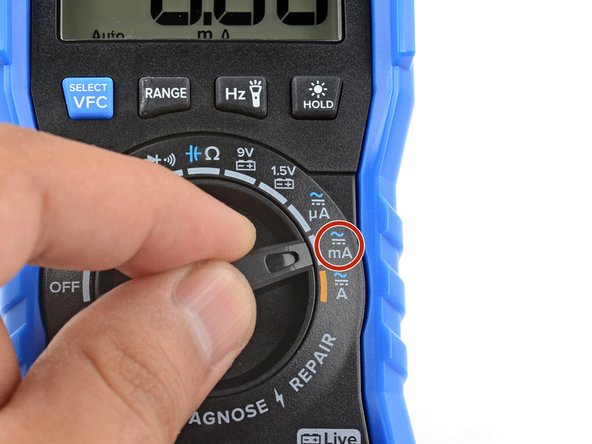

      • Plug the black lead into the COM port. Plug the red lead into the mA port (the right port on the iFixit multimeter).
      • Turn the function dial to the milliamp mA mode. If you're measuring Alternating Current (AC), press the blue select button to switch to AC mode.

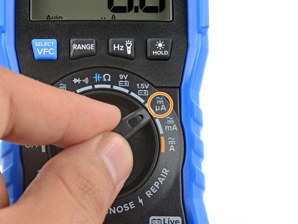

      • You can also measure in the microamp μA mode if you know you're measuring minute amounts of current. This changes the measurement range and gives you more precision at the μA range. Even if you exceed that range, it won't damage your multimeter—as long as you don't exceed the port limit (600mA).
    4. How to Make Advanced Measurements With a Multimeter, How to measure low current (mA scale): crwdns2935265:05crwdnd2935265:01crwdnd2935265:02crwdne2935265:0 How to Make Advanced Measurements With a Multimeter, How to measure low current (mA scale): crwdns2935265:05crwdnd2935265:02crwdnd2935265:02crwdne2935265:0
      • Choose the point where you want to measure the current. You'll need to break the circuit at that point. This may mean snipping a wire, disconnecting a connector, or removing a connecting jumper wire.
      • Make sure the circuit isn't accidentally touching you or anything conductive that may short it.

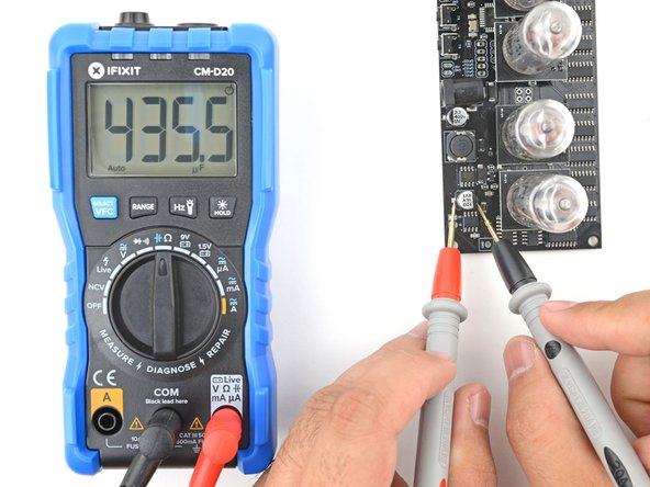

    5. How to Make Advanced Measurements With a Multimeter, How to measure capacitance (small capacitors): crwdns2935265:07crwdnd2935265:01crwdnd2935265:03crwdne2935265:0 How to Make Advanced Measurements With a Multimeter, How to measure capacitance (small capacitors): crwdns2935265:07crwdnd2935265:02crwdnd2935265:03crwdne2935265:0 How to Make Advanced Measurements With a Multimeter, How to measure capacitance (small capacitors): crwdns2935265:07crwdnd2935265:03crwdnd2935265:03crwdne2935265:0

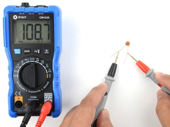

      • This step shows how to measure small ceramic or film capacitors. These capacitors are normally flat, with a body that's smaller than 5 mm.
      • Plug the black lead into the COM port. Plug the red lead into the right port.

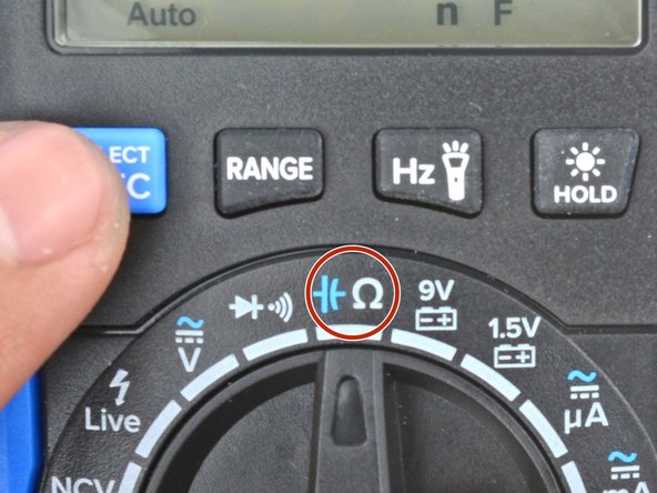

      • Turn the function dial to the resistance/capacitance mode and press the blue select button to toggle on the capacitance mode.
      • Power down the circuit you're measuring, if you're measuring the capacitor while it's still connected to the circuit.
      • Touch the probes to each end of the capacitor to make a measurement.
      • If you're measuring a capacitor on a circuit board and you're not getting a proper reading, the capacitor may be in parallel with other circuit components. You'll need to desolder or disconnect one end before measuring the capacitor.

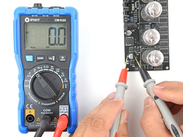

      • Make sure the capacitor is sufficiently discharged:
      • Turn the function dial to the DC volt mode.
      • Carefully touch the probes to the capacitor's leads/pads to measure voltage. Treat the circuit as a live circuit and be careful not to touch anything else with your probes.
      • Make sure the capacitor voltage is 10V or less. If it isn't, wait a minute to let the capacitor self-discharge, or use a capacitor discharge tool to discharge the capacitor.
      • As you measure the capacitor's voltage, the multimeter may slowly charge the capacitor up. Don't measure the capacitor for too long to prevent this from happening.

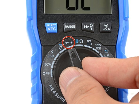

      • Turn the function dial to the diode/continuity mode.
      • The iFixit multimeter automatically selects the diode mode when you touch the probes to a diode.

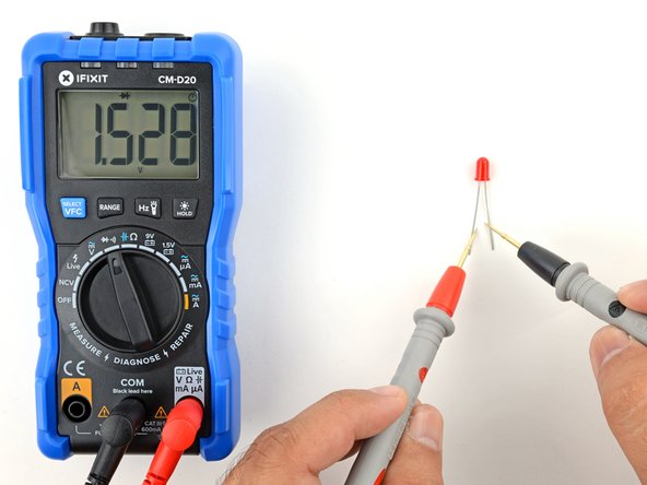

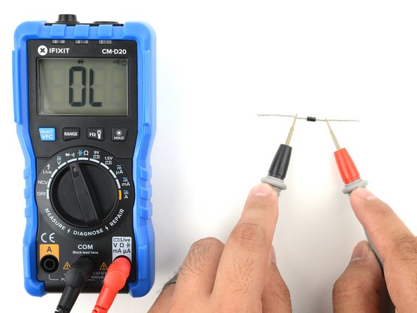

    9. How to Make Advanced Measurements With a Multimeter, How to test diodes and LEDs: crwdns2935265:012crwdnd2935265:01crwdnd2935265:03crwdne2935265:0 How to Make Advanced Measurements With a Multimeter, How to test diodes and LEDs: crwdns2935265:012crwdnd2935265:02crwdnd2935265:03crwdne2935265:0 How to Make Advanced Measurements With a Multimeter, How to test diodes and LEDs: crwdns2935265:012crwdnd2935265:03crwdnd2935265:03crwdne2935265:0
      • Touch the red probe to the anode, "input", or unmarked end of the diode. If you're testing an LED, touch the longer lead.
      • Touch the black probe to the cathode, "output", or marked end of the diode. If you're testing an LED, touch the shorter lead (or the lead next to the flat side of the LED).
      • The multimeter should show a non-zero voltage, which is the forward bias voltage.
      • If the multimeter reads 0L or 0V, the diode is burned out or short-circuited, respectively.
      • Reverse the probes so they touch the opposite ends of the diode.
      • The multimeter should show 0L, which stands for open circuit.
      • If the multimeter shows anything other than open circuit and the diode isn't connected to circuitry, the diode is defective.

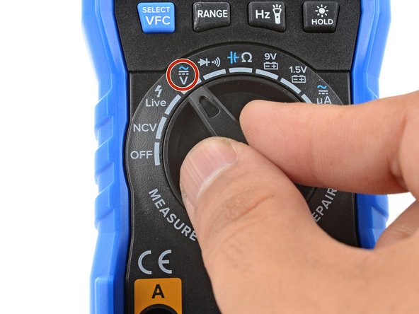

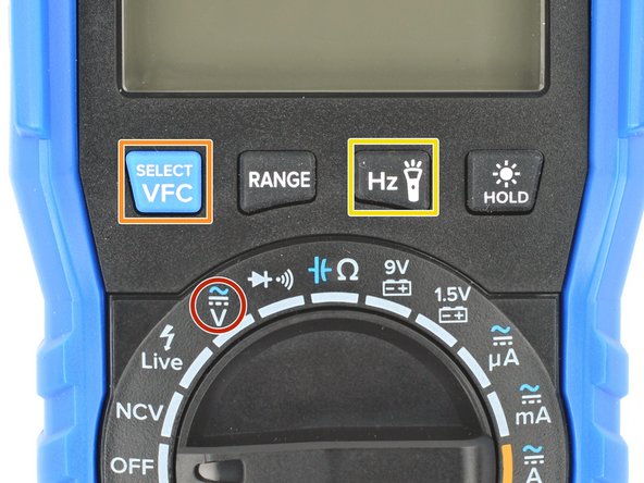

      • Switch the multimeter to the AC Hz mode:
      • Turn the function dial to the Volts mode.
      • Press the blue Select button to switch to AC volts.
      • Press the Hz button to toggle the frequency measurement mode.

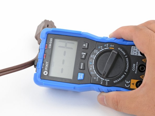

    12. How to Make Advanced Measurements With a Multimeter, How to use the Non-Contact Voltage detector: crwdns2935265:015crwdnd2935265:01crwdnd2935265:02crwdne2935265:0 How to Make Advanced Measurements With a Multimeter, How to use the Non-Contact Voltage detector: crwdns2935265:015crwdnd2935265:02crwdnd2935265:02crwdne2935265:0
      • The Non-Contact Voltage (NCV) function allows you to sense AC power in a circuit or wire without having to electrically connect to it.
      • The NCV sensor sits inside the plastic nub at the top of the iFixit multimeter. The metal strip inside acts as an "antenna" that detects the electromagnetic field generated by an AC source. This field gets stronger the closer it is to the source.
      • The NCV won't detect whether there's DC power in a circuit or wire.
      • The NCV may not always detect a live circuit or wire. For safety reasons, never rely on the NCV as your sole point of information if you're working above 20V AC.
      • The iFixit multimeter's NCV function detects ~45V AC and above.

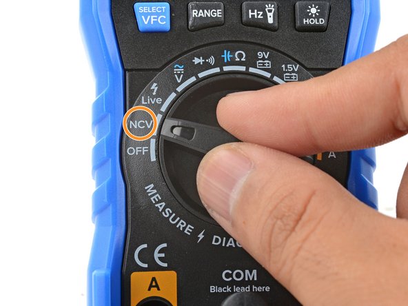

      • To use the NCV function, turn the function dial to the NCV mode.
    13. How to Make Advanced Measurements With a Multimeter, How to use the Non-Contact Voltage detector: crwdns2935265:016crwdnd2935265:01crwdnd2935265:03crwdne2935265:0 How to Make Advanced Measurements With a Multimeter, How to use the Non-Contact Voltage detector: crwdns2935265:016crwdnd2935265:02crwdnd2935265:03crwdne2935265:0 How to Make Advanced Measurements With a Multimeter, How to use the Non-Contact Voltage detector: crwdns2935265:016crwdnd2935265:03crwdnd2935265:03crwdne2935265:0

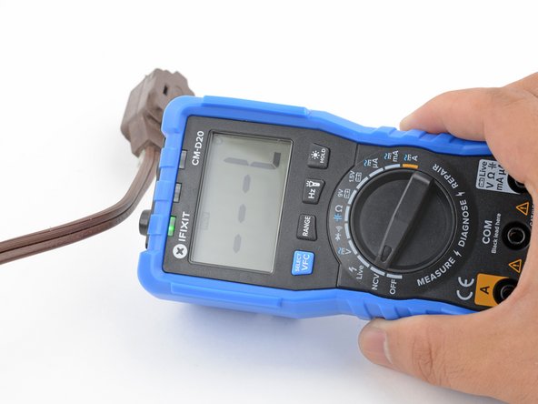

      • Move the NCV sensor so that it's close to the wire or circuit. If there's live AC, the multimeter will begin beeping and the top indicator LEDs will light up.
      • If the NCV detects ~45-100V, a single green indicator LED will light up, and the screen will display "L".
      • If the NCV detects above 100V, two red indicator LEDs will light up, and the screen will display "H".
      • Most of the time, you can detect which wire in a power cable is live by touching the NCV sensor along each edge of the cable.

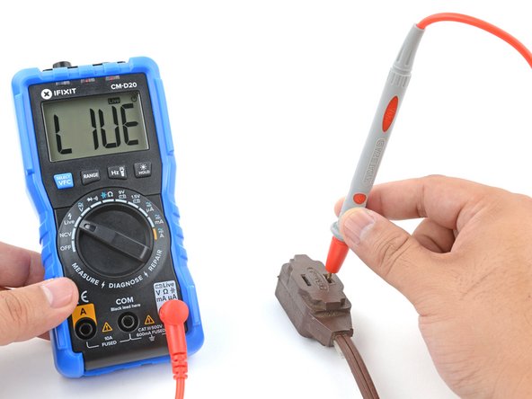

      • The Live Wire function determines which wire in a bundle is live by using a single direct connection. You can use this to make sure an outlet is properly wired.
      • This function operates similarly to the Non-Contact Voltage (NCV) function, as it detects the electromagnetic field to determine whether a wire is live or not. The difference is that the Live Wire function uses a test probe to shift the testing into the multimeter. This allows you to clearly distinguish which wire in a bundle is live.
      • Don't use the Live Wire function as a NCV tester—it isn't sensitive enough to reliably report the presence of AC voltage. Use the Live Wire function to determine correct wiring, not whether there's AC power or not.
      • Plug a probe into the right-most port of the multimeter.

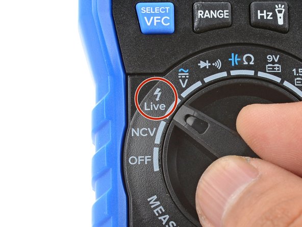

      • Turn the function dial to the Live mode.
      • Touch the probe to the wire you want to test.
      • If the wire is live, the multimeter will beep and display "LIVE".
      • If the Live Wire function doesn't detect any live wires when you expect it to, try grasping the multimeter with your free hand. This helps with capacitive coupling, which Live Wire uses to function.
