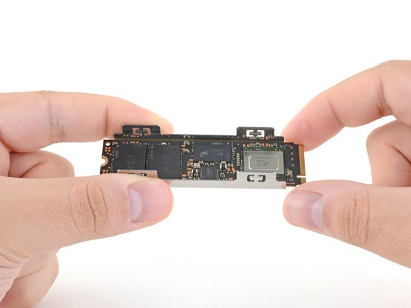

  8. How to Install a Heatsink on an M.2 SSD, Snap the heatsink in place: crwdns2935265:08crwdnd2935265:01crwdnd2935265:03crwdne2935265:0 How to Install a Heatsink on an M.2 SSD, Snap the heatsink in place: crwdns2935265:08crwdnd2935265:02crwdnd2935265:03crwdne2935265:0 How to Install a Heatsink on an M.2 SSD, Snap the heatsink in place: crwdns2935265:08crwdnd2935265:03crwdnd2935265:03crwdne2935265:0
    • Align the top heatsink section over the SSD and the tray.
    • Firmly press the two halves together. You'll feel it "snap" into place.
  9. How to Install a Heatsink on an M.2 SSD, Check the alignment: crwdns2935265:09crwdnd2935265:01crwdnd2935265:01crwdne2935265:0
    • For the SSD to fit in a desktop PC or a PlayStation 5, the heatsink needs to be centered on the SSD.
    • Make sure that the heatsink is close to the screw cutout but doesn't overhang it.
    • If you're having trouble installing your SSD, you may have to slightly adjust the heatsink's position.
    • Use your fingers to slide the SSD between the two halves of the heatsink assembly until fitment is just right.
