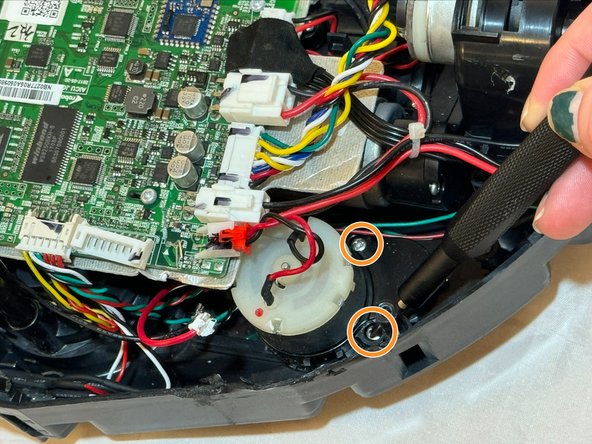

  14. Hoover Rogue 970 Wall Brush Motor Replacement, Wall Brush Motor: crwdns2935265:014crwdnd2935265:01crwdnd2935265:02crwdne2935265:0 Hoover Rogue 970 Wall Brush Motor Replacement, Wall Brush Motor: crwdns2935265:014crwdnd2935265:02crwdnd2935265:02crwdne2935265:0
    • Locate the wall brush motors.
    • Remove the two 9.8 mm screws with a Phillips #0 screwdriver.

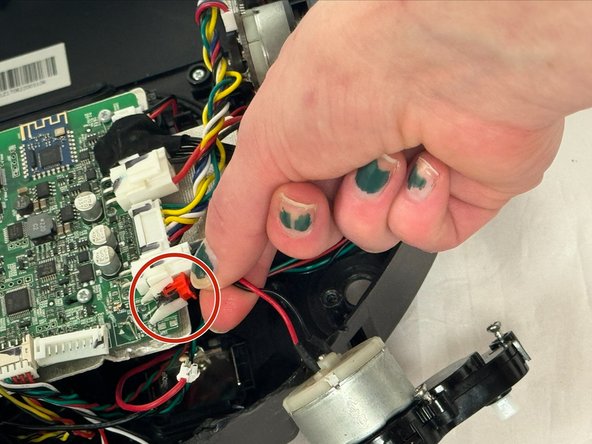

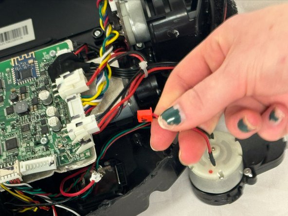

    • Lift the wall brush motor out of the vacuum to gain access to the red JST connector and white tab.
    • Disconnect the red JST connector from the white tab by firmly pulling the red connector away from the white tab.
    • You may find it helpful to place your other hand's index finger and thumb firmly on the white tab to secure it, avoiding injury or damage to the vacuum.
    • Remove the wall brush motor from the vacuum.
