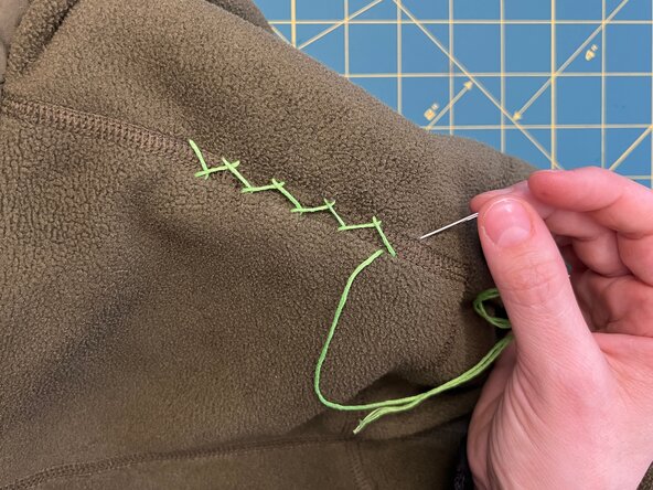

    • Structure - The herringbone stitch consists of a series of alternating slanted stitches, creating a crosshatch pattern.
    • Repair Use - This stitch provides excellent stretch, making it ideal for knit and stretch fabrics. It's effective when fabric edges touch or slightly overlap, making it a strong choice for repairing damaged coverstitch seams.

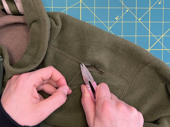

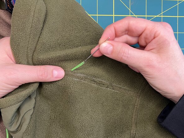

  2. Herringbone Stitch on a Split Seam, Assess the damage: crwdns2935265:02crwdnd2935265:01crwdnd2935265:03crwdne2935265:0 Herringbone Stitch on a Split Seam, Assess the damage: crwdns2935265:02crwdnd2935265:02crwdnd2935265:03crwdne2935265:0 Herringbone Stitch on a Split Seam, Assess the damage: crwdns2935265:02crwdnd2935265:03crwdnd2935265:03crwdne2935265:0
    • Locate the damaged area and trim away any loose or hanging threads.
    • If necessary, pin the seam together so that it stays in place during stitching.

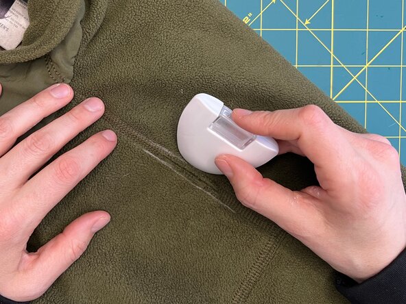

  3. Herringbone Stitch on a Split Seam, Plan the stitch: crwdns2935265:03crwdnd2935265:01crwdnd2935265:02crwdne2935265:0 Herringbone Stitch on a Split Seam, Plan the stitch: crwdns2935265:03crwdnd2935265:02crwdnd2935265:02crwdne2935265:0
    • The herringbone stitch follows two parallel lines, with the thread creating a crisscross pattern between them.
    • Before beginning, determine:
    • Stitch Width - The distance between the two parallel stitch lines. Mark both lines with chalk or heat-erasable pen.
    • Diagonal Stitch Length - The length of the diagonal stitch moving from one stitch line to the other that creates the crosshatch pattern.
    • Backstitch Length - The length of the small backstitch that secures each diagonal stitch.
    • These measurements will determine the structure and appearance of the herringbone stitch.

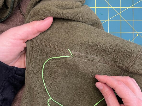

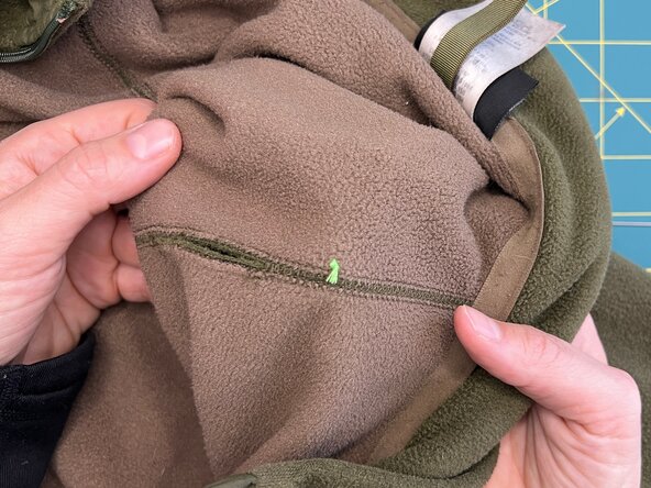

  4. Herringbone Stitch on a Split Seam, Start the stitch: crwdns2935265:04crwdnd2935265:01crwdnd2935265:03crwdne2935265:0 Herringbone Stitch on a Split Seam, Start the stitch: crwdns2935265:04crwdnd2935265:02crwdnd2935265:03crwdne2935265:0 Herringbone Stitch on a Split Seam, Start the stitch: crwdns2935265:04crwdnd2935265:03crwdnd2935265:03crwdne2935265:0
    • Thread the needle with a length of thread approximately 24 inches (~61 cm) and tie a knot at one end of the thread. For more details see Needles and Thread.
    • In the pictured repair, embroidery floss is used for visibility.
    • From the backside, insert the needle through to the front at a marked stitch line. Overlap any existing stitching by at least 1/2 inch (~13 mm).
    • In the pictured repair, remnant stitch lines from a missing coverstitch will be followed.
    • Pull the thread through until the knot lies flush against the back of the fabric.

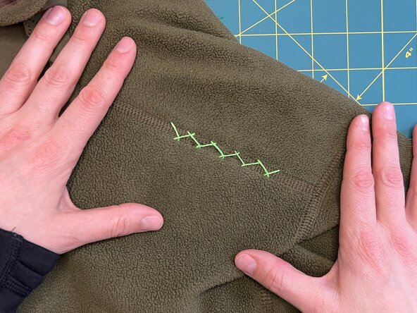

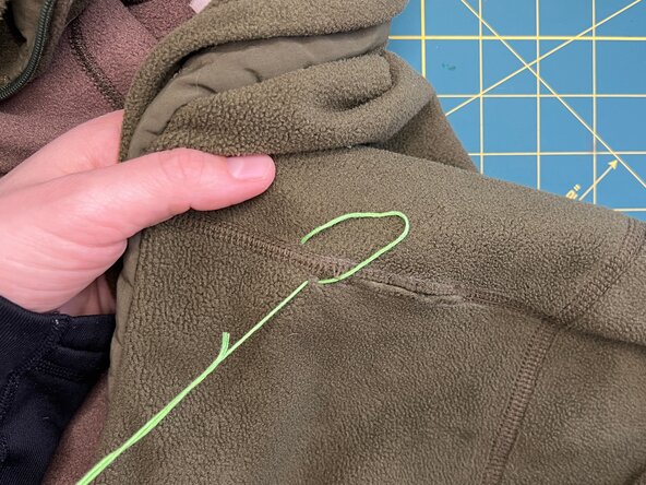

  5. Herringbone Stitch on a Split Seam, Make a diagonal stitch: crwdns2935265:05crwdnd2935265:01crwdnd2935265:03crwdne2935265:0 Herringbone Stitch on a Split Seam, Make a diagonal stitch: crwdns2935265:05crwdnd2935265:02crwdnd2935265:03crwdne2935265:0 Herringbone Stitch on a Split Seam, Make a diagonal stitch: crwdns2935265:05crwdnd2935265:03crwdnd2935265:03crwdne2935265:0
    • On the front side, move the needle diagonally across the seam in the direction of the stitch path.
    • Insert the needle into the opposing stitch line at the Diagonal Stitch Length determined in Step 3.
    • Make a small stitch backwards along the marked stitch line with the Backstitch Length determined in Step 3.
    • If sewing through two layers, ensure both fabric layers are caught in the backstitch.
    • Pull the thread through.

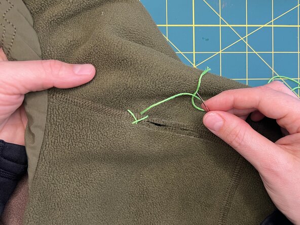

  6. Herringbone Stitch on a Split Seam, Continue the stitch: crwdns2935265:06crwdnd2935265:01crwdnd2935265:02crwdne2935265:0 Herringbone Stitch on a Split Seam, Continue the stitch: crwdns2935265:06crwdnd2935265:02crwdnd2935265:02crwdne2935265:0
    • Move diagonally across the seam again.
    • Insert the needle, make a backstitch, and pull the thread through.
    • Keep the Stitch Width, Diagonal Stitch Length and the Backstitch Length consistent to create an even, durable stitch pattern.

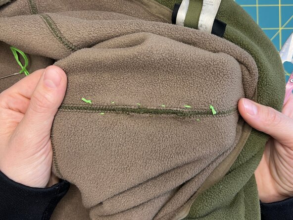

  8. Herringbone Stitch on a Split Seam, Tie off the thread: crwdns2935265:08crwdnd2935265:01crwdnd2935265:03crwdne2935265:0 Herringbone Stitch on a Split Seam, Tie off the thread: crwdns2935265:08crwdnd2935265:02crwdnd2935265:03crwdne2935265:0 Herringbone Stitch on a Split Seam, Tie off the thread: crwdns2935265:08crwdnd2935265:03crwdnd2935265:03crwdne2935265:0
    • To complete the stitch, move the needle to the backside and make a secure knot on the backside of the fabric using one of the techniques from Knot Thread to the Fabric (2 Ways).

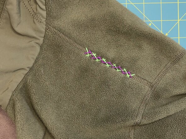

  9. Herringbone Stitch on a Split Seam, Quality check: crwdns2935265:09crwdnd2935265:01crwdnd2935265:02crwdne2935265:0 Herringbone Stitch on a Split Seam, Quality check: crwdns2935265:09crwdnd2935265:02crwdnd2935265:02crwdne2935265:0
    • Ensure the stitches have effectively secured the seam.
    • For additional strength and coverage, repeat these steps to add another stitch line.
    • Placing the new stitch staggered from the original can create an appealing design.
    • Creating more compact stitches will also create a more durable stitch.
