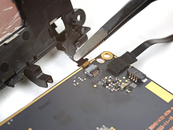

  62. HTC Vive XR Elite Motherboard Replacement: crwdns2935265:062crwdnd2935265:01crwdnd2935265:03crwdne2935265:0 HTC Vive XR Elite Motherboard Replacement: crwdns2935265:062crwdnd2935265:02crwdnd2935265:03crwdne2935265:0 HTC Vive XR Elite Motherboard Replacement: crwdns2935265:062crwdnd2935265:03crwdnd2935265:03crwdne2935265:0
    • Use your tweezers to pull the volume button cable out of its slot in the hinge cover.

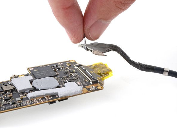

  78. HTC Vive XR Elite Motherboard Replacement, Disconnect the pass-through camera: crwdns2935265:078crwdnd2935265:01crwdnd2935265:02crwdne2935265:0 HTC Vive XR Elite Motherboard Replacement, Disconnect the pass-through camera: crwdns2935265:078crwdnd2935265:02crwdnd2935265:02crwdne2935265:0
    • Use a spudger to lift up the locking flap on the pass-through camera ZIF connector.
  79. HTC Vive XR Elite Motherboard Replacement: crwdns2935265:079crwdnd2935265:01crwdnd2935265:01crwdne2935265:0
    • Use tweezers to pull the pass-through camera cable connector out of its slot in the motherboard.

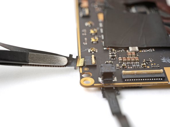

  83. HTC Vive XR Elite Motherboard Replacement, Disconnect the depth sensor: crwdns2935265:083crwdnd2935265:01crwdnd2935265:02crwdne2935265:0 HTC Vive XR Elite Motherboard Replacement, Disconnect the depth sensor: crwdns2935265:083crwdnd2935265:02crwdnd2935265:02crwdne2935265:0
    • Use tweezers to pull the depth sensor cable connector out of its slot in the motherboard.

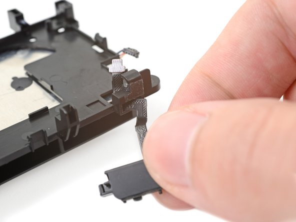

  94. HTC Vive XR Elite Motherboard Replacement, Disconnect the power button: crwdns2935265:094crwdnd2935265:01crwdnd2935265:02crwdne2935265:0 HTC Vive XR Elite Motherboard Replacement, Disconnect the power button: crwdns2935265:094crwdnd2935265:02crwdnd2935265:02crwdne2935265:0
    • Lift the power button out of its slot in the frame.
    • Don't remove the button completely, as it's still attached by a cable.

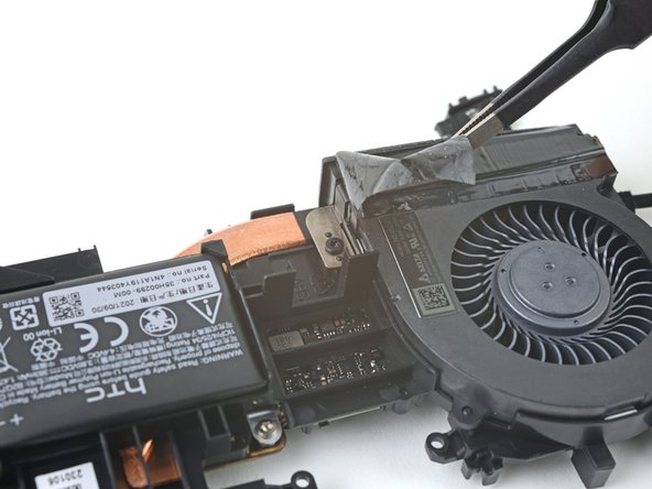

  100. HTC Vive XR Elite Motherboard Replacement, Peel the tape: crwdns2935265:0100crwdnd2935265:01crwdnd2935265:02crwdne2935265:0 HTC Vive XR Elite Motherboard Replacement, Peel the tape: crwdns2935265:0100crwdnd2935265:02crwdnd2935265:02crwdne2935265:0
    • Peel back the black tape next to the fan covering the heat sink screw.

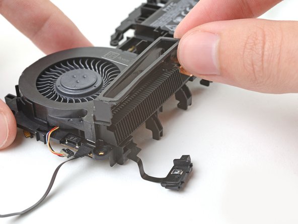

  101. HTC Vive XR Elite Motherboard Replacement, Unclip the heat sink cover: crwdns2935265:0101crwdnd2935265:01crwdnd2935265:02crwdne2935265:0 HTC Vive XR Elite Motherboard Replacement, Unclip the heat sink cover: crwdns2935265:0101crwdnd2935265:02crwdnd2935265:02crwdne2935265:0
    • Pull up the air guide to unclip it from the motherboard frame.

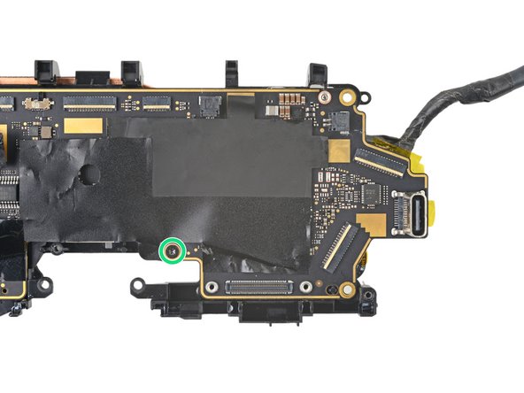

  102. HTC Vive XR Elite Motherboard Replacement, Unfasten the heat sink: crwdns2935265:0102crwdnd2935265:01crwdnd2935265:02crwdne2935265:0 HTC Vive XR Elite Motherboard Replacement, Unfasten the heat sink: crwdns2935265:0102crwdnd2935265:02crwdnd2935265:02crwdne2935265:0
    • Take care not to puncture or bend the battery—it can leak dangerous chemicals and/or catch fire.
    • Use a T5 Torx screwdriver to remove the three screws securing the heat sink:
    • Two 3.4 mm‑long screws
    • One 3.5 mm‑long screw
    • Flip the motherboard assembly over so the USB‑C port is facing upward.
    • Use a T5 Torx screwdriver to remove the 3.5 mm‑long screw securing the motherboard frame.

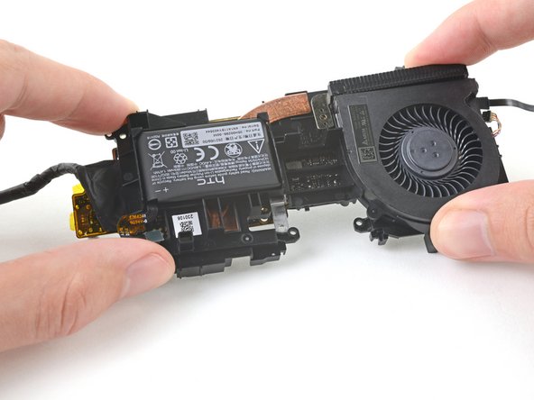

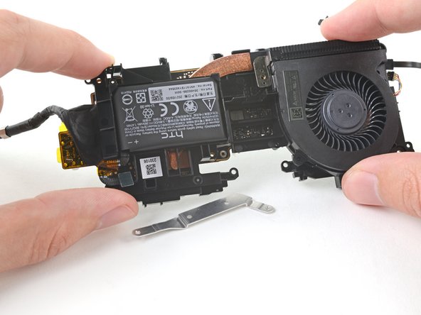

  103. HTC Vive XR Elite Motherboard Replacement, Remove the heat sink bracket: crwdns2935265:0103crwdnd2935265:01crwdnd2935265:03crwdne2935265:0 HTC Vive XR Elite Motherboard Replacement, Remove the heat sink bracket: crwdns2935265:0103crwdnd2935265:02crwdnd2935265:03crwdne2935265:0 HTC Vive XR Elite Motherboard Replacement, Remove the heat sink bracket: crwdns2935265:0103crwdnd2935265:03crwdnd2935265:03crwdne2935265:0
    • A metal bracket between the heat sink and the motherboard frame secures the heat sink.
    • Pull the bottom left corner of the motherboard frame away from the heat sink until the metal bracket falls out.
    • Remove the heat sink bracket.

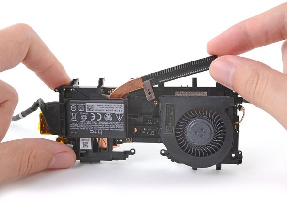

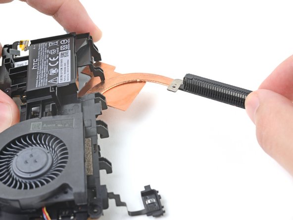

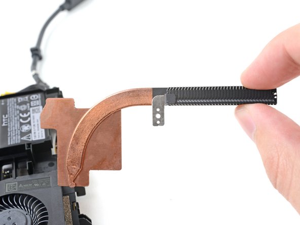

  104. HTC Vive XR Elite Motherboard Replacement, Remove the heat sink: crwdns2935265:0104crwdnd2935265:01crwdnd2935265:02crwdne2935265:0 HTC Vive XR Elite Motherboard Replacement, Remove the heat sink: crwdns2935265:0104crwdnd2935265:02crwdnd2935265:02crwdne2935265:0
    • The heat sink might stick to the motherboard depending on the age of your device and the condition of the thermal paste. You'll probably feel resistance when performing this step.
    • Lift the arm of the heat sink upwards until you feel the thermal paste separate from the heat sink.

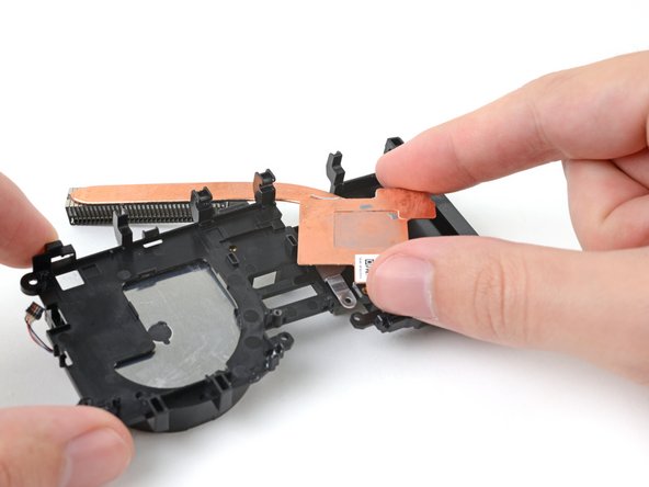

  105. HTC Vive XR Elite Motherboard Replacement: crwdns2935265:0105crwdnd2935265:01crwdnd2935265:03crwdne2935265:0 HTC Vive XR Elite Motherboard Replacement: crwdns2935265:0105crwdnd2935265:02crwdnd2935265:03crwdne2935265:0 HTC Vive XR Elite Motherboard Replacement: crwdns2935265:0105crwdnd2935265:03crwdnd2935265:03crwdne2935265:0
    • Guide the heat sink out of its slot in the motherboard frame.
    • You may have to slightly bend the left side of the motherboard frame upward to free the heat sink.

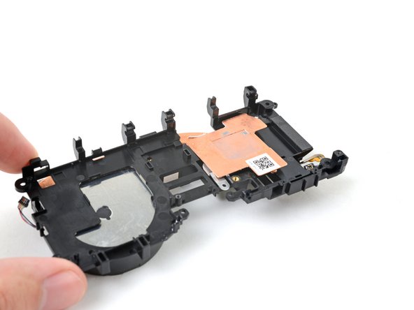

  106. HTC Vive XR Elite Motherboard Replacement, Reassembly information: crwdns2935265:0106crwdnd2935265:01crwdnd2935265:03crwdne2935265:0 HTC Vive XR Elite Motherboard Replacement, Reassembly information: crwdns2935265:0106crwdnd2935265:02crwdnd2935265:03crwdne2935265:0 HTC Vive XR Elite Motherboard Replacement, Reassembly information: crwdns2935265:0106crwdnd2935265:03crwdnd2935265:03crwdne2935265:0
    • During reassembly, perform the following to realign the heat sink:
    • Place the heat sink bracket on its two alignment pegs in the motherboard frame.
    • Thread the arm of the heat sink through the gap in the top of the motherboard frame.
    • Place the square portion of the heat sink on the heat sink bracket.

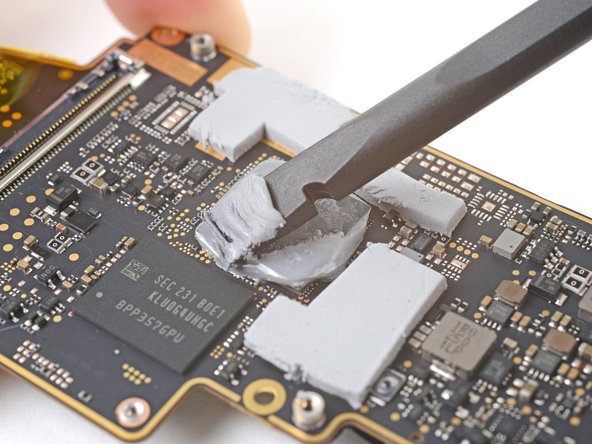

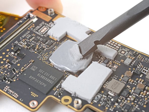

  107. HTC Vive XR Elite Motherboard Replacement: crwdns2935265:0107crwdnd2935265:01crwdnd2935265:03crwdne2935265:0 HTC Vive XR Elite Motherboard Replacement: crwdns2935265:0107crwdnd2935265:02crwdnd2935265:03crwdne2935265:0 HTC Vive XR Elite Motherboard Replacement: crwdns2935265:0107crwdnd2935265:03crwdnd2935265:03crwdne2935265:0
    iFixit Thermal Putty
    $9.95
    • During reassembly, perform the following to reapply thermal paste:
    • Use the flat end of a spudger to scrape off the thermal paste on the processor.
    • Follow this guide to clean the processor and replace the thermal paste.
    • The HTC Vive XR Elite uses a special viscous thermal paste. Regular thermal paste won’t provide proper cooling. Make sure to use an appropriate thermal paste like K5 Pro or thermal putty to replace the old thermal paste.

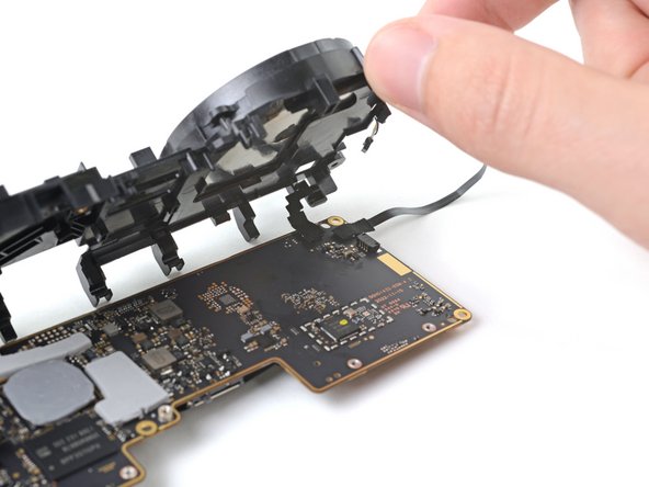

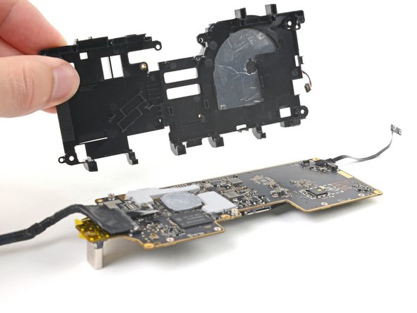

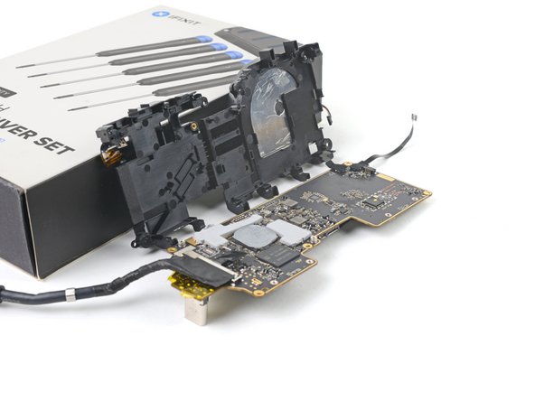

  108. HTC Vive XR Elite Motherboard Replacement, Reposition the motherboard frame: crwdns2935265:0108crwdnd2935265:01crwdnd2935265:03crwdne2935265:0 HTC Vive XR Elite Motherboard Replacement, Reposition the motherboard frame: crwdns2935265:0108crwdnd2935265:02crwdnd2935265:03crwdne2935265:0 HTC Vive XR Elite Motherboard Replacement, Reposition the motherboard frame: crwdns2935265:0108crwdnd2935265:03crwdnd2935265:03crwdne2935265:0
    • Place the motherboard on a clean, smooth surface or on a soft cloth before continuing.
    • Swing the bottom of the motherboard frame over the top of the motherboard to expose the power button connector.
    • Don't remove the motherboard frame yet, as it's still connected by cables.
    • Rest the motherboard frame upright on a sturdy object before continuing.

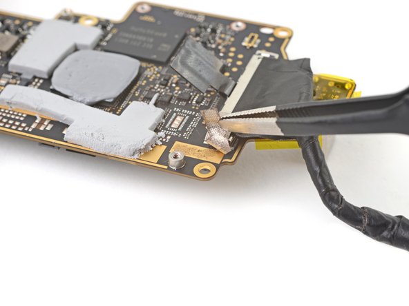

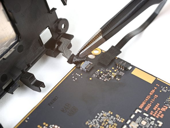

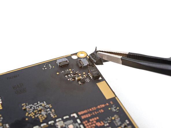

  109. HTC Vive XR Elite Motherboard Replacement, Peel the tape: crwdns2935265:0109crwdnd2935265:01crwdnd2935265:02crwdne2935265:0 HTC Vive XR Elite Motherboard Replacement, Peel the tape: crwdns2935265:0109crwdnd2935265:02crwdnd2935265:02crwdne2935265:0
    • Peel off the black tape covering the power button cable ZIF connector.

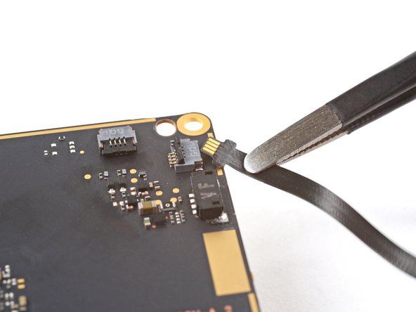

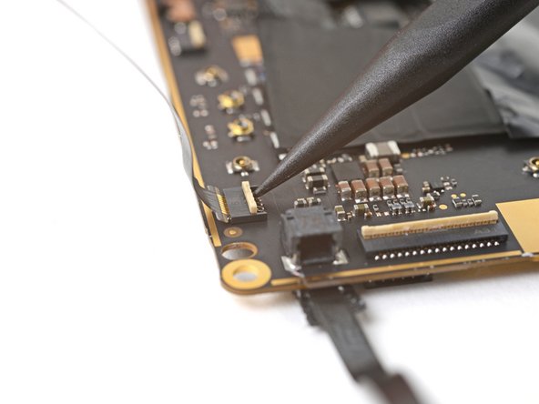

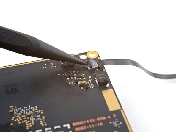

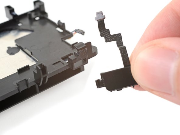

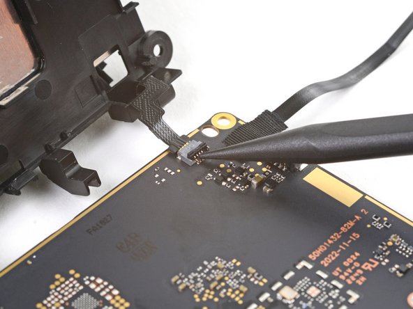

  110. HTC Vive XR Elite Motherboard Replacement, Disconnect the power button: crwdns2935265:0110crwdnd2935265:01crwdnd2935265:02crwdne2935265:0 HTC Vive XR Elite Motherboard Replacement, Disconnect the power button: crwdns2935265:0110crwdnd2935265:02crwdnd2935265:02crwdne2935265:0
    • Use the point of a spudger to lift of the locking flap on the power button ZIF connector.
  111. HTC Vive XR Elite Motherboard Replacement: crwdns2935265:0111crwdnd2935265:01crwdnd2935265:02crwdne2935265:0 HTC Vive XR Elite Motherboard Replacement: crwdns2935265:0111crwdnd2935265:02crwdnd2935265:02crwdne2935265:0
    • Use tweezers to pull the power button cable out of its slot in the motherboard.
  112. HTC Vive XR Elite Motherboard Replacement, Remove the power button: crwdns2935265:0112crwdnd2935265:01crwdnd2935265:03crwdne2935265:0 HTC Vive XR Elite Motherboard Replacement, Remove the power button: crwdns2935265:0112crwdnd2935265:02crwdnd2935265:03crwdne2935265:0 HTC Vive XR Elite Motherboard Replacement, Remove the power button: crwdns2935265:0112crwdnd2935265:03crwdnd2935265:03crwdne2935265:0
    • Thread the power button cable through its slot in the motherboard frame.
    • Remove the power button.
  113. HTC Vive XR Elite Motherboard Replacement, Remove the motherboard frame: crwdns2935265:0113crwdnd2935265:01crwdnd2935265:02crwdne2935265:0 HTC Vive XR Elite Motherboard Replacement, Remove the motherboard frame: crwdns2935265:0113crwdnd2935265:02crwdnd2935265:02crwdne2935265:0
    • Lift the motherboard frame off the motherboard and remove it.
  114. HTC Vive XR Elite Motherboard Replacement, Peel the tape: crwdns2935265:0114crwdnd2935265:01crwdnd2935265:02crwdne2935265:0 HTC Vive XR Elite Motherboard Replacement, Peel the tape: crwdns2935265:0114crwdnd2935265:02crwdnd2935265:02crwdne2935265:0
    • Peel back the gray conductive tape covering the USB-C cable.
  115. HTC Vive XR Elite Motherboard Replacement, Disconnect the USB-C cable: crwdns2935265:0115crwdnd2935265:01crwdnd2935265:02crwdne2935265:0 HTC Vive XR Elite Motherboard Replacement, Disconnect the USB-C cable: crwdns2935265:0115crwdnd2935265:02crwdnd2935265:02crwdne2935265:0
    • Support your motherboard with one hand.
    • Use your other hand to lift the USB-C cable connector by its black pull tab to disconnect it from the motherboard.
    • Remove the USB-C cable.

  117. HTC Vive XR Elite Motherboard Replacement, Remove the motion sensor cable: crwdns2935265:0117crwdnd2935265:01crwdnd2935265:02crwdne2935265:0 HTC Vive XR Elite Motherboard Replacement, Remove the motion sensor cable: crwdns2935265:0117crwdnd2935265:02crwdnd2935265:02crwdne2935265:0
    • Use the point of a spudger to lift up the locking flap on the motion sensor cable ZIF connector.
  118. HTC Vive XR Elite Motherboard Replacement: crwdns2935265:0118crwdnd2935265:01crwdnd2935265:02crwdne2935265:0 HTC Vive XR Elite Motherboard Replacement: crwdns2935265:0118crwdnd2935265:02crwdnd2935265:02crwdne2935265:0
    • Use tweezers to pull the motion sensor cable out of its slot in the motherboard.
    • Remove the motion sensor cable.

    • Peel off the black tape at the top right corner of the motherboard covering the volume button cable ZIF connector.

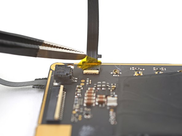

  120. HTC Vive XR Elite Motherboard Replacement, Remove the volume button cable: crwdns2935265:0120crwdnd2935265:01crwdnd2935265:02crwdne2935265:0 HTC Vive XR Elite Motherboard Replacement, Remove the volume button cable: crwdns2935265:0120crwdnd2935265:02crwdnd2935265:02crwdne2935265:0
    • Use the point of a spudger to lift up the locking flap on the volume button cable ZIF connector.
  121. HTC Vive XR Elite Motherboard Replacement: crwdns2935265:0121crwdnd2935265:01crwdnd2935265:02crwdne2935265:0 HTC Vive XR Elite Motherboard Replacement: crwdns2935265:0121crwdnd2935265:02crwdnd2935265:02crwdne2935265:0
    • Use tweezers to pull the volume button cable out of its slot in the motherboard.
